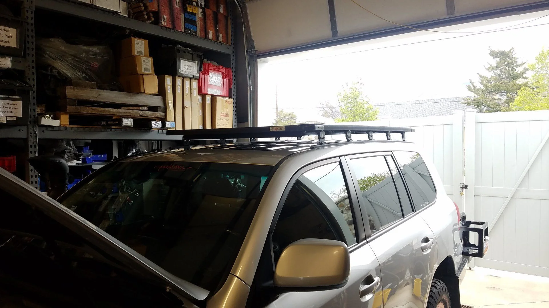

Eezi-Awn K9 Rack:

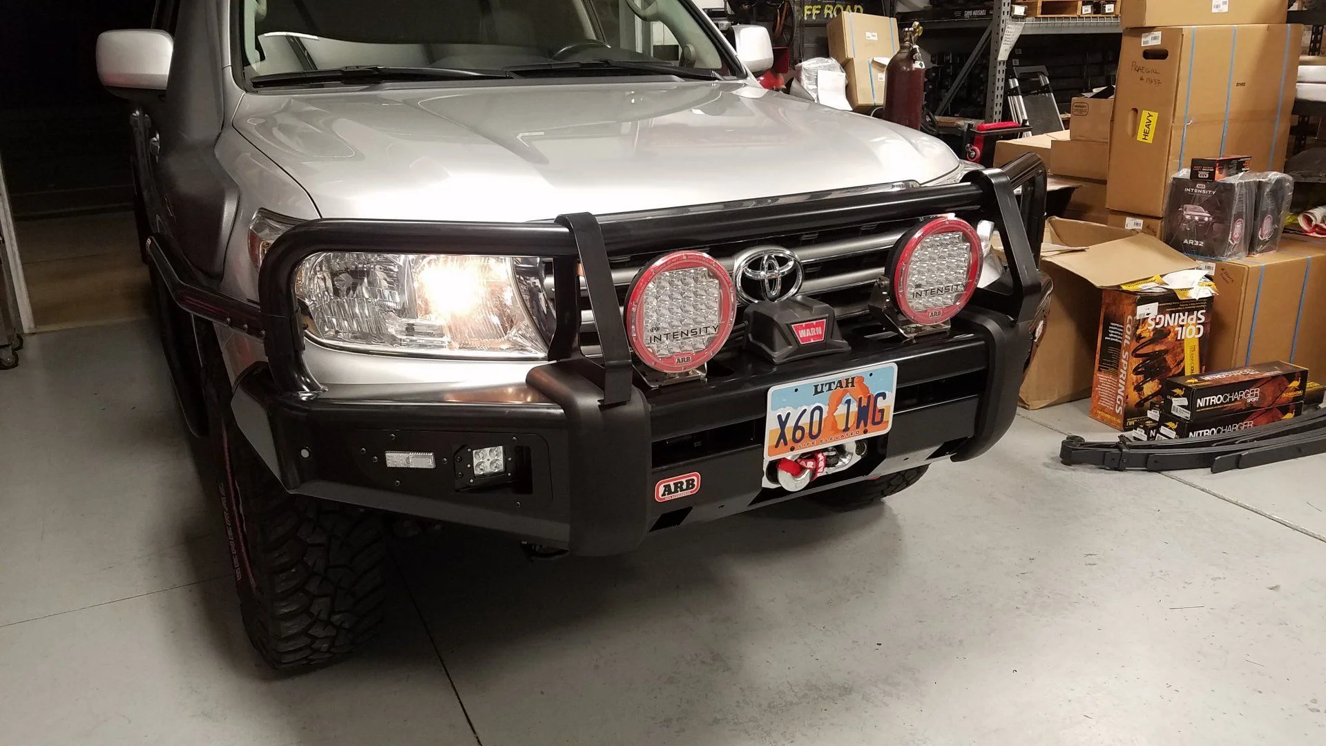

New bumper, lights & winch:

How hard is it to remove the K9 when you don't need it and re-attach it when you do?
Completely doable but not something I've ever planned to do. I'd guess an hour?
