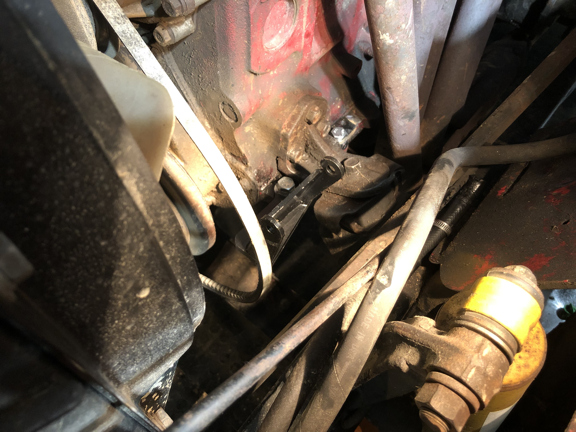

Finally got to the truck after the other to-do list stuff this week, but started way too late and still have some fitment issues to work out.
My thought was that, since the truck is desmogged, I might move the saginaw power steering pump down to where the smog pump would have been. This would do two things- clean things up, and more importantly move the pump and hoses down and away from the headers. The return line is cracking where it gets cooked, and the fluid boils over when the system is used heavily.
I got one of Mark's brackets, which replicates the smog pump mount, and uses a similar pivot adjustment bracket that attaches to one of the water pump bolts. I liked the idea as it would be like a better version of the TPI system that repurposes the smog pump mount pictured here:
It is a nice solution, but it looks like I will have to grind it to fit a standard saginaw pump. It is about 5mm short of the clearance required for the 'flange" on the tank. It's also going to be danger close to clearing the steering shaft and radiator support but figure that will work out. The steering shaft hits the rad support occasionally anyway.
What I've currently got- not only places the hoses about 1" from the top of the headers, but also attaches to the block head bolts, intake manifold, and smog pump location all at once. Lot going on:

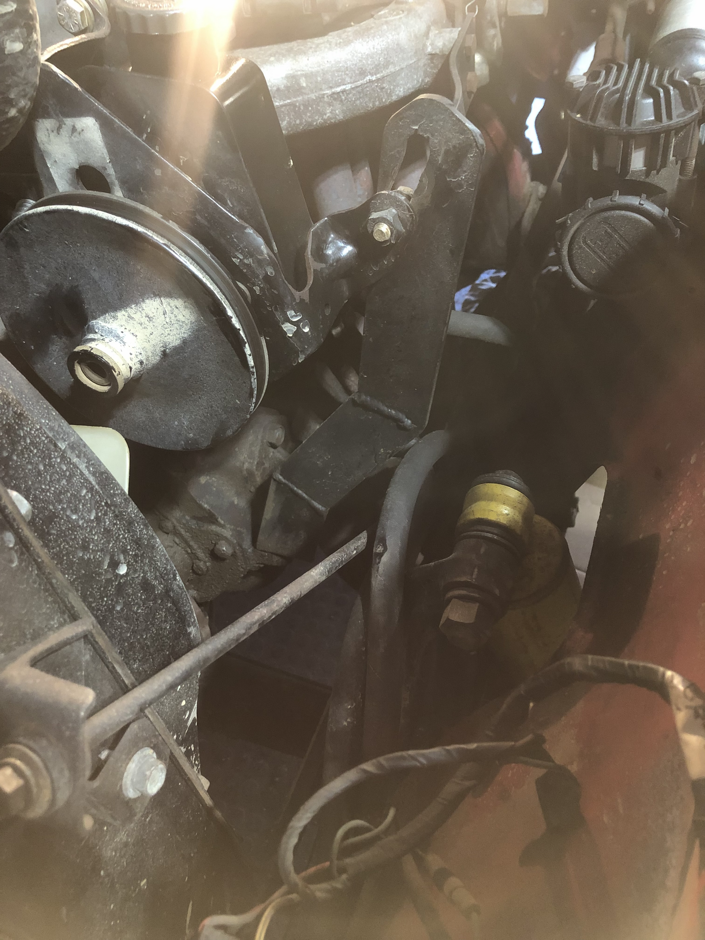

Got some spare minutes tonight and fitted the 65swb45 power steering pump bracket.
It is a bracket that is designed to bolt directly into the factory smog pump location (driver side block under the motor mount and accomodate a GM P Series type "canned ham" PS pump. The belt adjustment is done just like the smog pump- via a pivot arm bracket attached to the lower driver's side water pump housing.
The bracket as shipped was nowhere near fitting a P series pump, and the MFG confirmed that it is a direct bolt-up to the pump. I considered using a SBC type bracket that adds a long pivot fulcrum bolt to the pump, but it would have moved the pump far enough to the driver's side to hit the radiator support.
65swb45 bracket took some modification to fit a P type pump as intended- 14mm off the "flange" area and 6mm off the rest. Picture before cleaning up the grinds and painting.... next step will be mounting and either stacking washers or cutting spacers to locate the pulley properly. Does anyone know of a press-on pulley made for the wider toyota belt? It'd be cool to run one and I bet it would slip less.

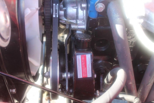

On my '77 '40, I went with the following setup using the Dorry mount, that now is sold by Georg at Hybrid:
Pick a bushing, then a sheave (pulley), and then the belt. I bought from McMasters. The belt I bought from a local parts store, needed to buy a few sizes and returned the ones that didn't fit.
Bushing - make sure that your Saginaw pump is a 3/4" shaft
SH 3/4" BORE QD BUSHINGS
Sheave/pulley: come in different sizes, pick your poison
Mfgrs # Bushing Contact Path in. Outside Diameter in. Order # Price Ea.
1B36SH SH 3.6 3.950 35436302 21.76
1B38SH SH 3.8 4.150 35436310 23.78
1B40SH SH 4.0 4.350 35436328 24.06
1B42SH SH 4.2 4.550 35436336 25.48
1B44SH SH 4.4 4.750 35436344 26.25
The belt I'm using is:
Gates TR22625 (replaces 973)
Truck & Bus Series
11/16" x [63-1/8" his particular length]
17mm x 1605mm (measure for yourself with a rope around pulleys)
Green Stripe II
Also known as 22 series belts
