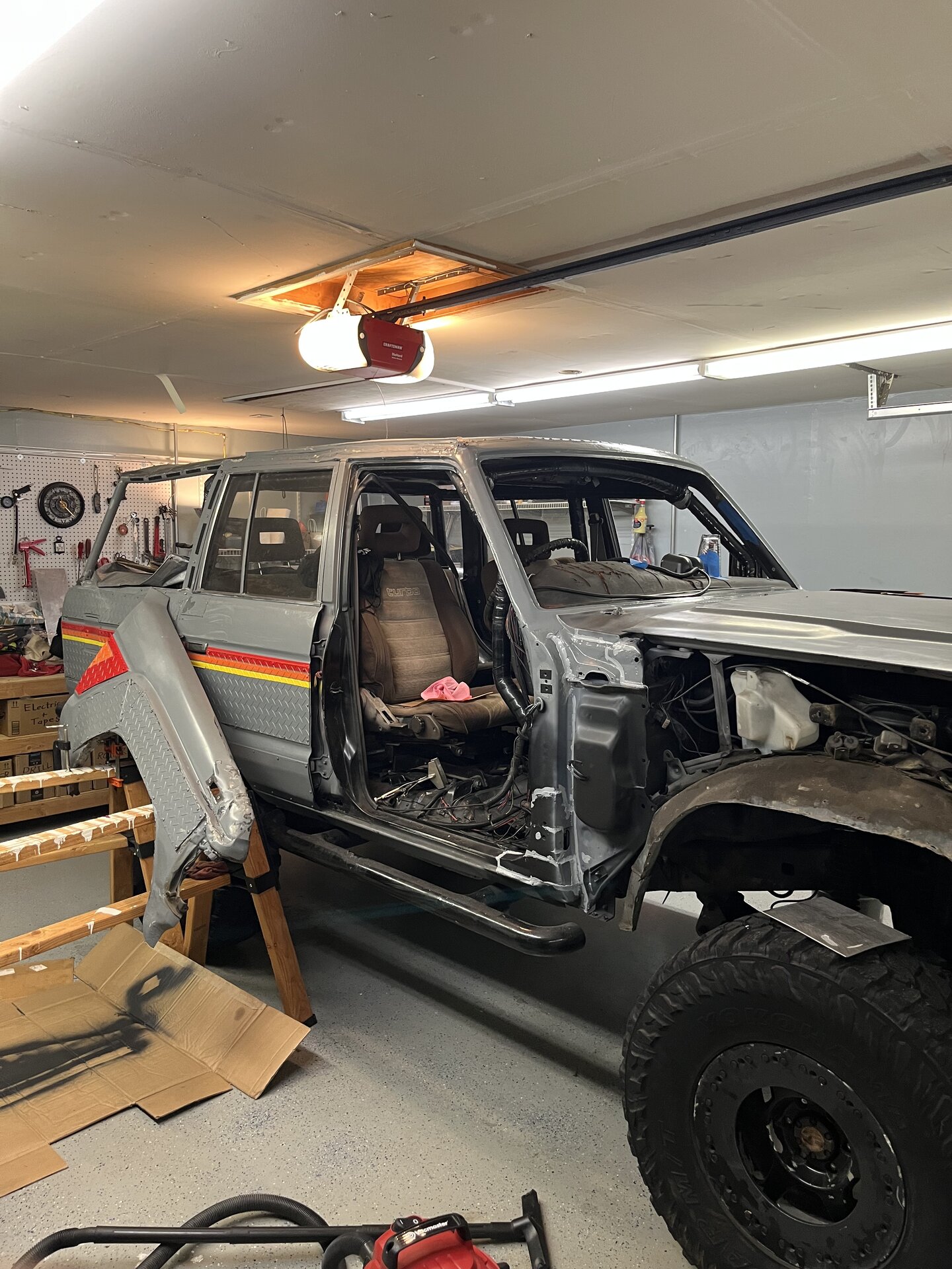

This was the other day, I have a windshield in it now! No more cheese grater Fred! 🤣
I’m about to go another round of hammering on the fender to make it not so gnarly. It’s a wheeler so whatever.
Still lots of work to do prior to fall crawl.

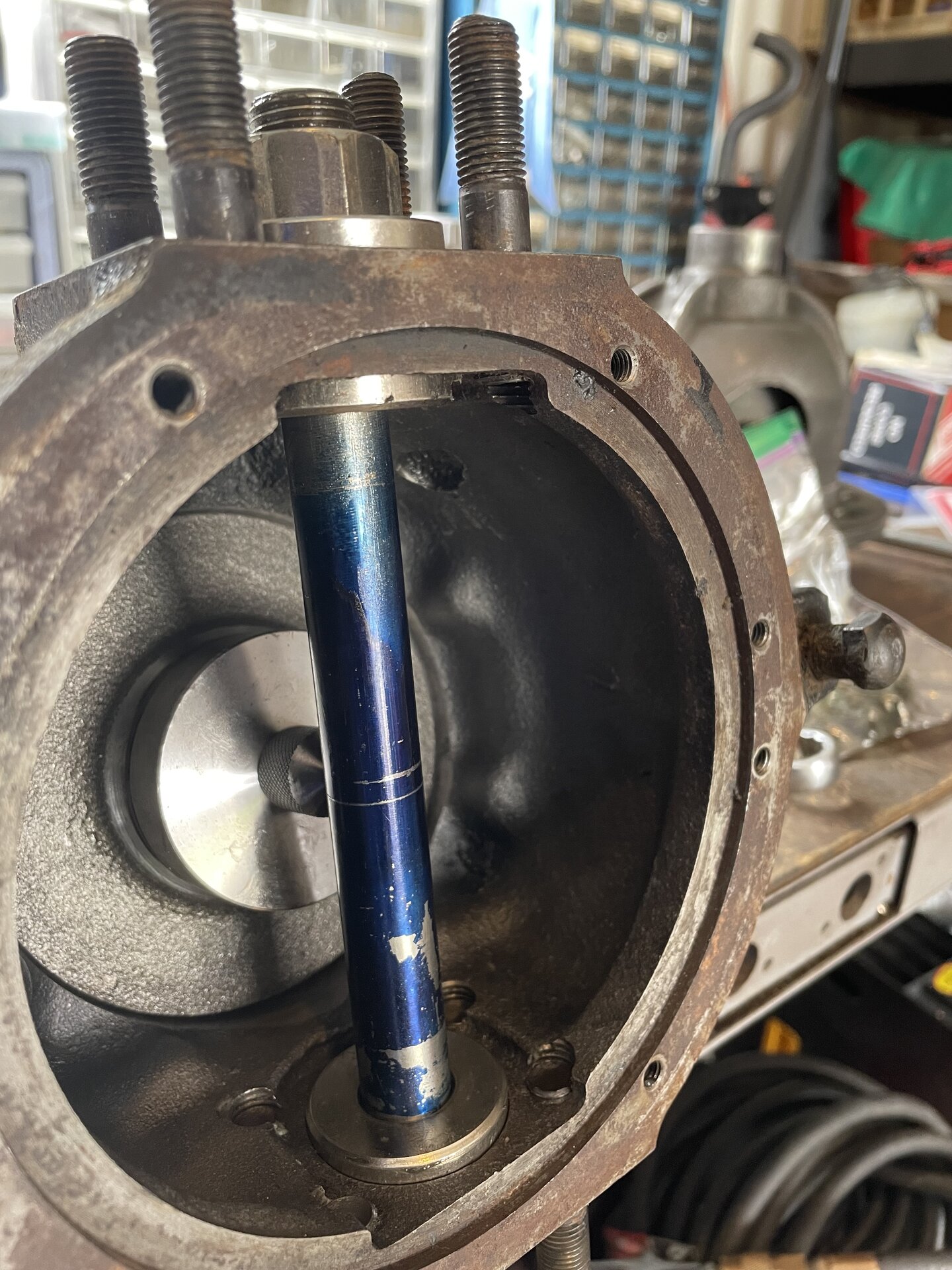

Over the summer at Coal Miner Classic, I noticed on the last day of wheeling that sometimes my brake pedal would sink a bit before engaging....was a little pucker up moment when it first happened and thought it might just be from overheating the fluid a bit, but was able to make it home safely and continued with the same feel since. Most of the time, the pedal would be perfect, sometimes it would take about half a pedal down to engage and then the same brake feel from there. I somewhat traced it to vacuum depending on throttle usage and tried to swap the check valve with no effect. Went ahead and got a Seiken OEM quality booster and Advics master...and installed yesterday...stops on a dime once again (every time!). The Seiken booster has the Bendix stamping and sticker that most replacement units do not have, so hopefully another 29 years from this one...:steer:

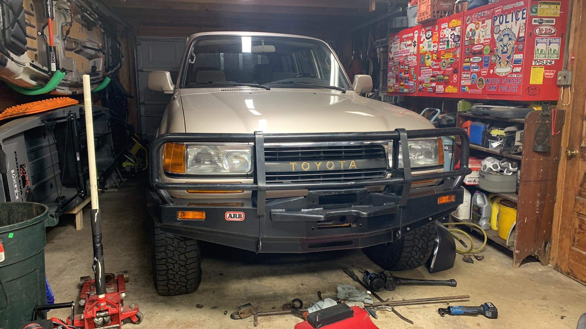

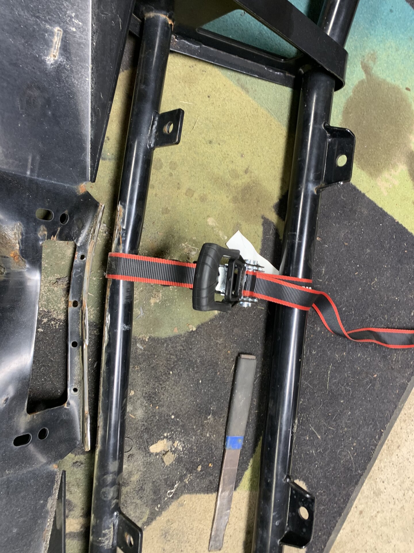

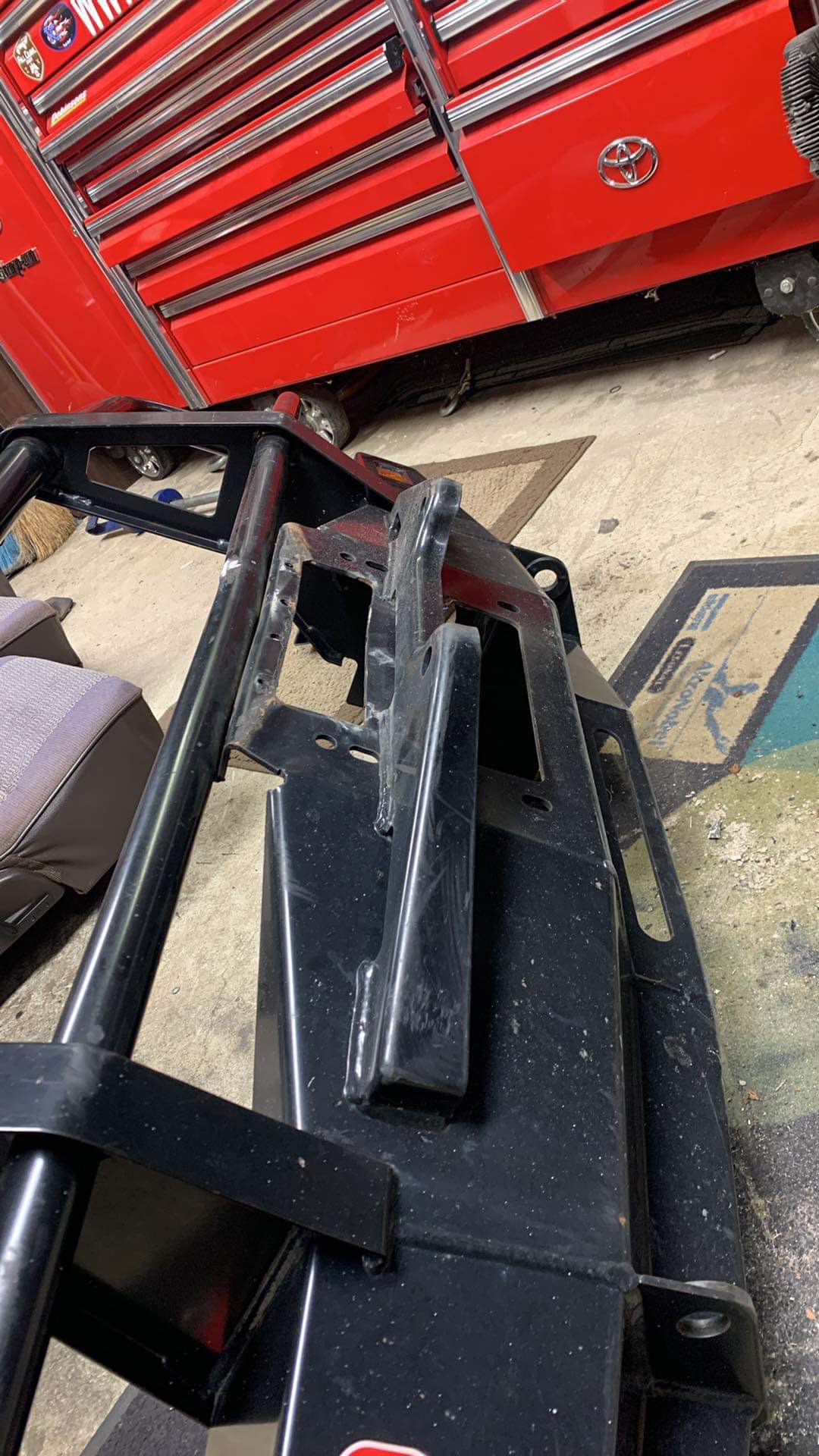

Picked up a local damaged ARB for the 80 this weekend, fixed it and installed it, I'm on the prowl for a warn M8000 if anyone has a lead

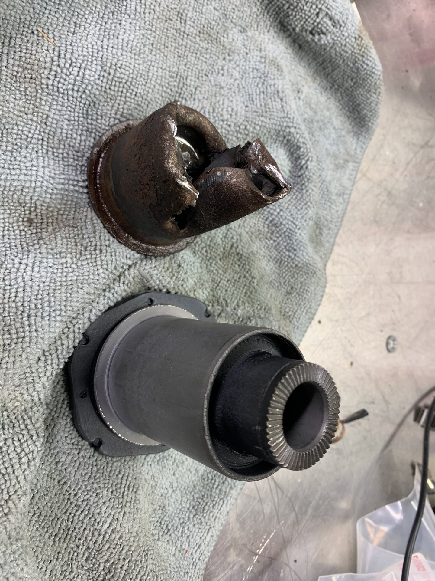

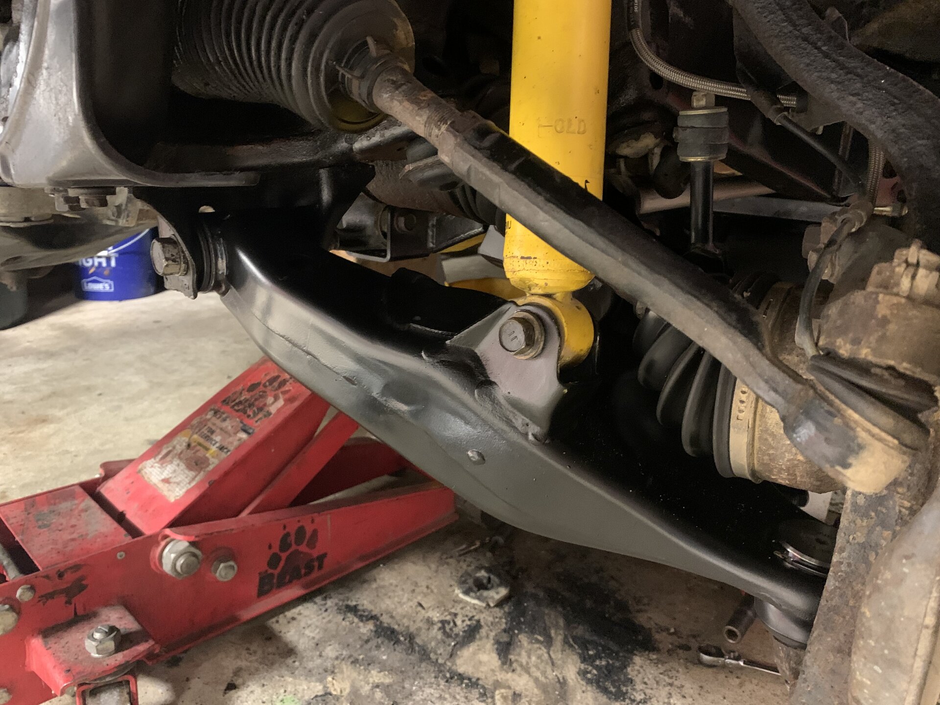

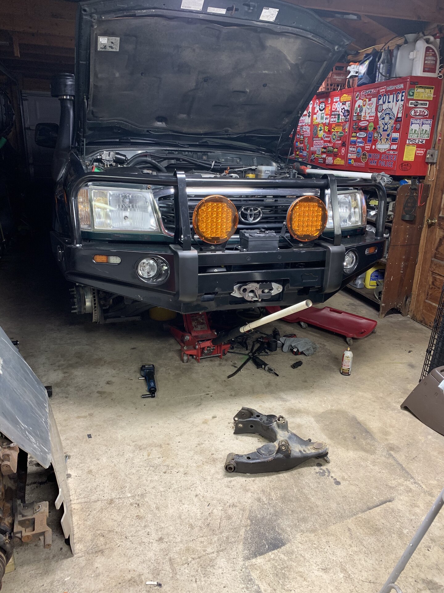

I did get both refurbished lower control arms (blasted, painted, new bushings and 555 ball joints) in the truck Saturday. The frame side bushings are a bit of a pain and I wasn't able to press them out but the air hammer made quick work of removing them. Pretty much everything in the front end of this truck minus the steering rack ( still sitting on the shelf ) is new. After a quick drive the difference is noticeable, everything feels tighter. Couple more small jobs to knock out the ready for Fall Crawl.

Looking good. One day I will tackle mine.
