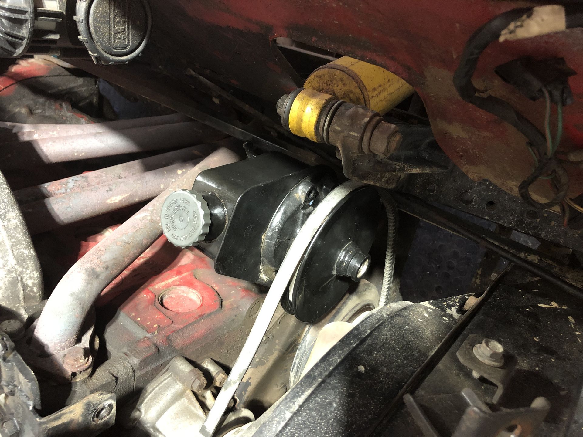

99% sure I ended up with an equivalent of that one by chance when I replaced the bent pulley that came on the truck.
It will take a 10-12mm belt, but not the ~16mm OEM.
I found this one from BTB, but am not ready to spend that much on a pulley, or buy a new keyed PS pump just to get the same belt size:
Wide Groove Keyed Pulley for Saginaw Steering Pump Conversion - BTB Products - Land Cruiser Restoration and Parts - https://btbprod.com/product/steering-pump-gm-saginaw-wide-groove-keyed-pulley-fj40-land-cruiser-6-cyl-conversions/
Also thinking I will try just routing around the harmonic balance and PS pulley rather than balancer, water pump, and PS. This should significantly increase the belt wrap, and I would not have to go over the fan to replace the belt.

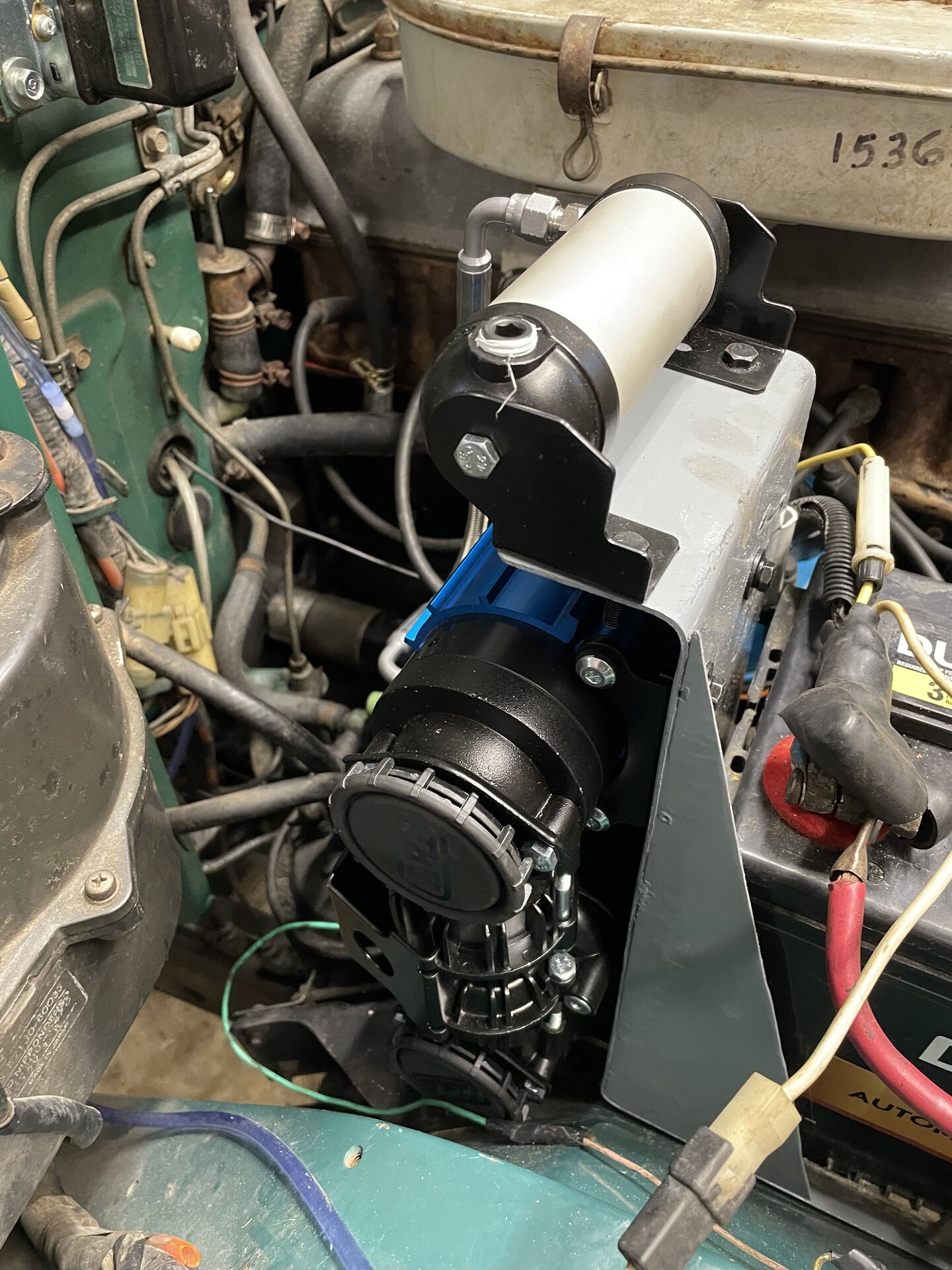

Need to make a kit for it... it might sell like hotcakes if you took it down to Relic Run!
Where are the solenoids for the air-lockers?
