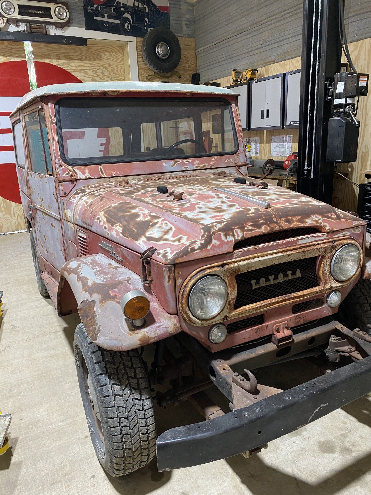

I’ve been working on this one to get ready to sell.
Lots of fun. 39,000 mile Texas Ranch truck.
CLR and 000 Steel Wool then a good Fluid Film rubdown.
This truck was obviously sanded at some point and then they added some bondo and a bad red paint job that just faded right back off.
Great solid truck with a ton on small complete unicorn things like OEM seatbelts, compete knobs, original red seats
Build thread is “Texas Reds” In the 40 section

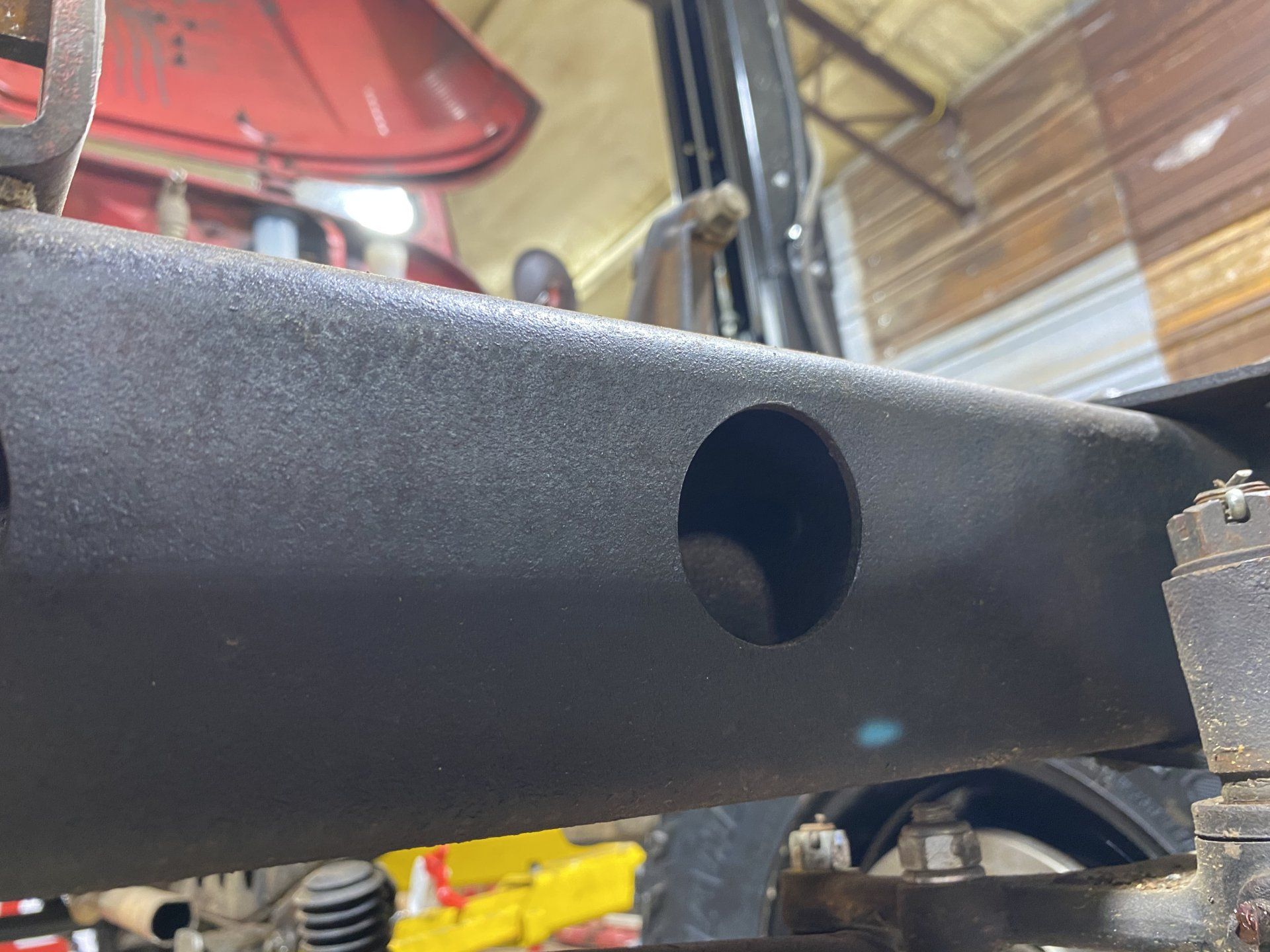

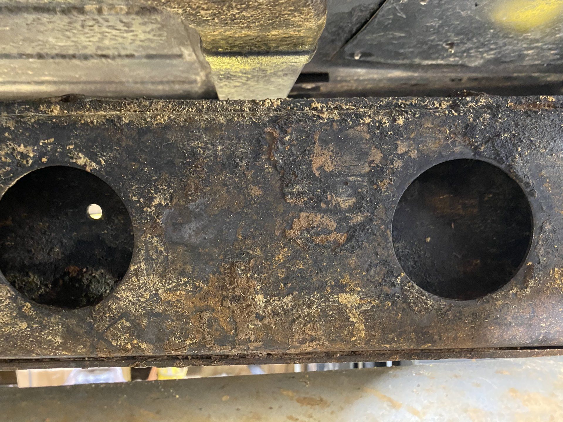

People often wonder why I love using Fluid Film on the frames and axles on my trucks even though I live in the south, far far away from salty roads.
So, this is the my FJ45 frame that had one treatment way back in February 2018
This frame literally had surface rust on 100% of the surfaces even though it lived in the Arizona mountain deserts for 47 years
I have not put any paint on the frame at all.
Before
This section of the frame is where I could not get to it to clean and spray due to the drivetrain being in the way
This is what it looks like 2.5 years later after a good pressure wash after pretty much being coated with dust and mud the entire time
Case closed
Looks awesome. What kind of prep did you do to the frame between pic 1 and the good looking pics? Wire wheel, sandblasting, etc?

Thats my point. Nothing. I mean, it was cleaned before I hosed it with Fluid Film but just by washing it. If there was a large place of crust I may have hit it with a paint scraper.
That's amazing. Looks way better than the flaky rubber coating on my frame. Might have to give that a try.

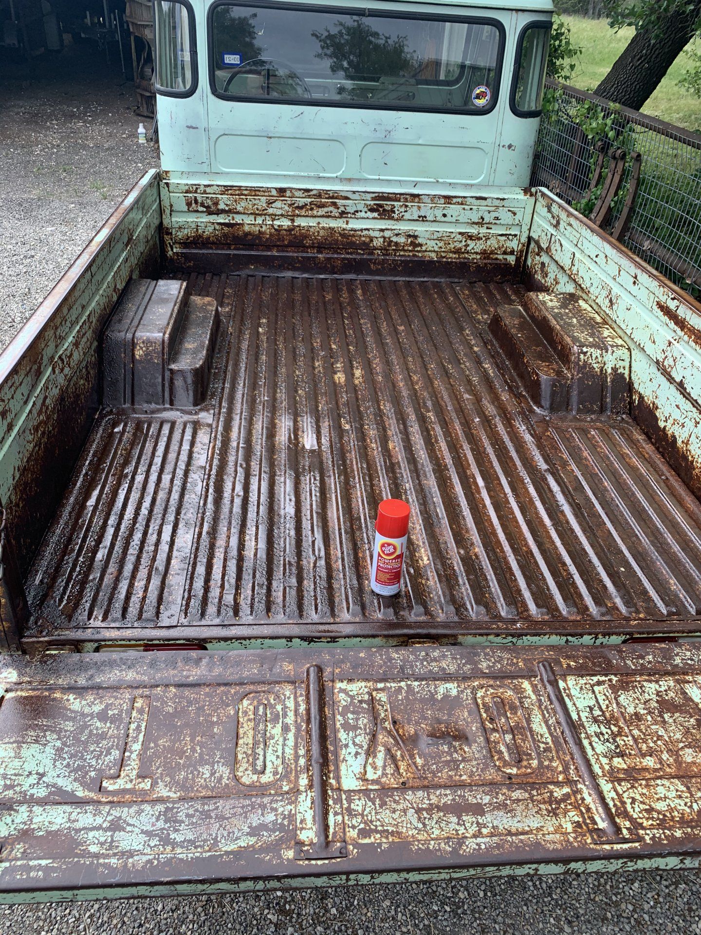

Thanks for all the info here. Figured as a show of appreciation I'd post before/after pictures and thoughts from my experience.
  • All in all happy with the results. My 40 had a pretty severe two-tone effect going given a redone/resprayed tub. No big deal but this process led to a more even and saturated look... at least for now. Ya dig it? Looks aside I'm hoping this helps to preserve what I got.
  • CLR wash - It was a hot, dry and windy day. I CLR'ed before washing, so by the time I got back to where I had started the CLR was pretty well cooked and left some residue or uneven coloration. Some of that might have been hiding under the dust/crud... who knows. After the CLR scrub, I hosed/scrubbed down with water. Next time I'll CLR/rinse in sections or opt for milder weather.
  • Rust converter - I used Loctite Rust Neutralizer. Brushed it on thick (thicker than instructed... because beer) and wasn't overly careful about applying to rust only versus paint. My zeal in this step is most apparent in the tub, which was/is thoroughly rusted. Might go back and hit this with CLR or stronger (acetone?) and coarse scotch-brite to get rid of excess. No BLO applied to tub.
  • BLO - Went pretty thick with this too because same as above. Probably fine as is unless someone suggests otherwise.

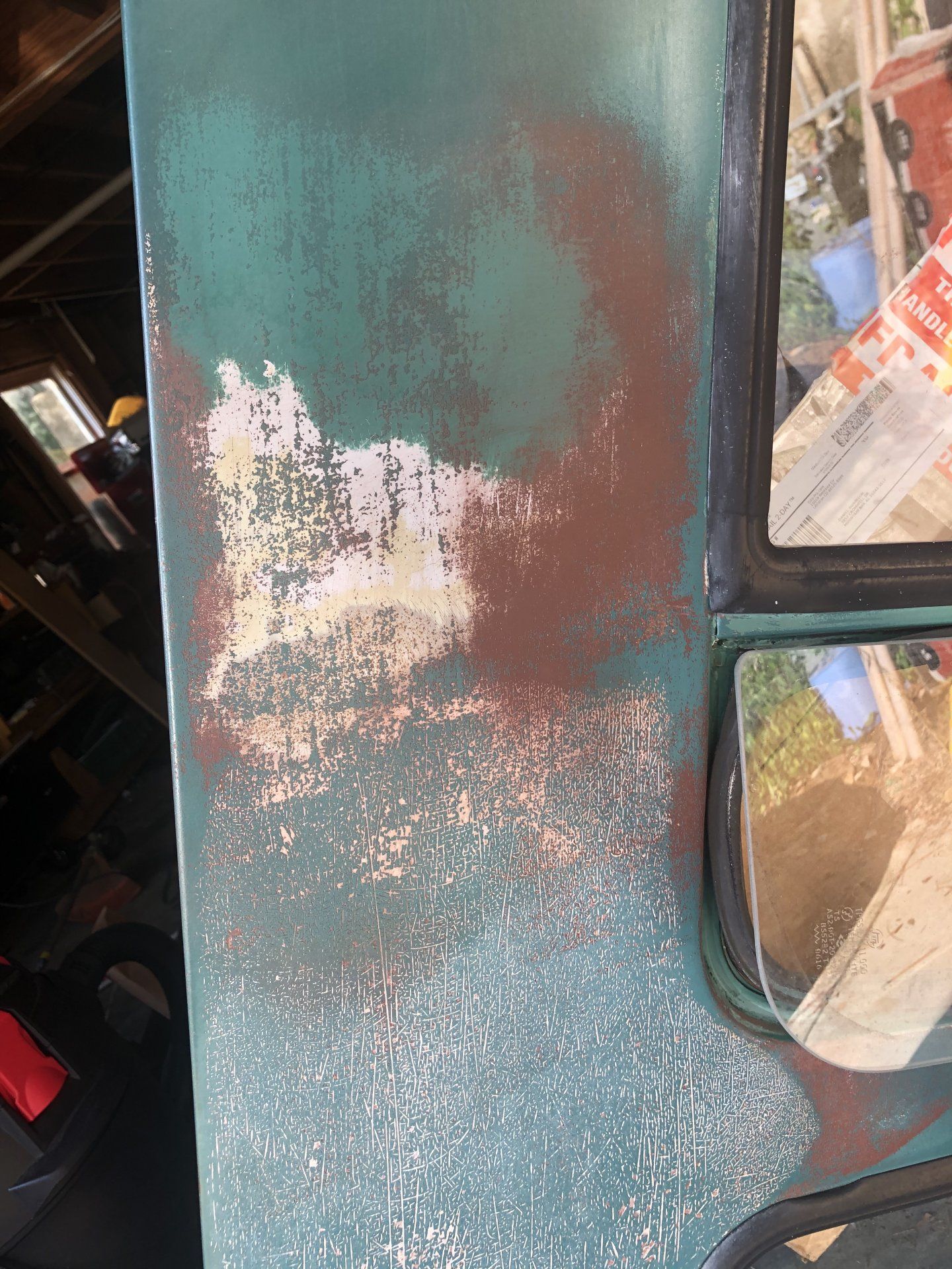

Ok so I just bought this 79 FJ40. 44k original miles and (supposedly) original paint. The guy who had it before me (he only had it for a week before I got it off him) did something to the hood, fender, and flare to make it look like it has. He said he used a paint scraper and took off a layer of the paint. I've tried varrying things to try and get the rest of the truck to come back but I'm not having much luck. I've tried CLR and a green scotchbrite pad on one of the doors that didn't seem to have any effect.
It's clear to me that he ran a buffer over most of the truck and there was a lot of dried compound on it that I had to pressure wash off. The paint is very rough to the touch and textured so I'm not real sure how great of a job a buffer would do. Polish seems to have no effect. What's worse is theres these big brown spots that I'm not sure what they are, but a pressure washer definitely makes them bigger. I find it hard to believe that its the original paint being stripped away and thats whats underneath but it's definitely possible. Any tips for what I should do to make this thing look better?
After reading through some of this thread, I took some laquer thinner to that section of the top I posted above. Really wishing I hadn't of done that, but I guess I'm kind of committed at this point. I'm just going to wait to go forward until someone gives me their thoughts.
I don’t remember anyone saying to use thinner on the paint unless you are trying to get spray paint off original paint.
The brown is OEM primmer. It’s actually dark red. You either have to paint the truck or oil the truck. Wax won’t work.
