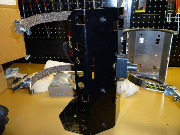

I have the Ultimate Air system which came with a mounting bracket. I attached it to my home-brew shelf a while back. Perfect fit and out of the way.
