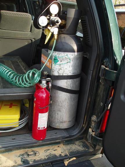

FYI , cornelius makes high pressure regulators. The caged gauge model is best.
That is the style regulator I use now, much better than the one in the picture I posted. They are a little pricey compared to others.
