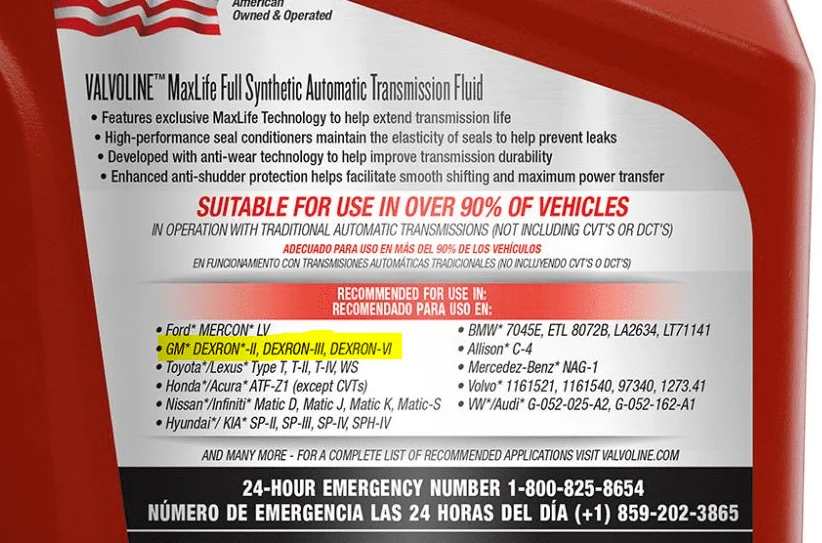

I went with Valvoline Maxlife ATF. Same stuff I use in the transmission.
Toyota "power steering fluid" is ATF
Why reinvent the wheel, DEX3 is what Toyota recommends, so that's what I used when i rebuild my pump.
Any generic Dexron III equivilant is acceptable. It is a basic hydraulic system, and as long as it meets the criteria laid out in the FSM, it will do just fine.

Interesting thread and info here that I recently became aware of. That said, I have been using Maxlife Synth ATF (same as in my A442F) in the power steering of the 80 and BJ74.
Going to investigate and perhaps switch to what's recommended in the above linked thread. I would still maintain a small supply of Maxlife Synth ATF in the trail spares for use in either application.
