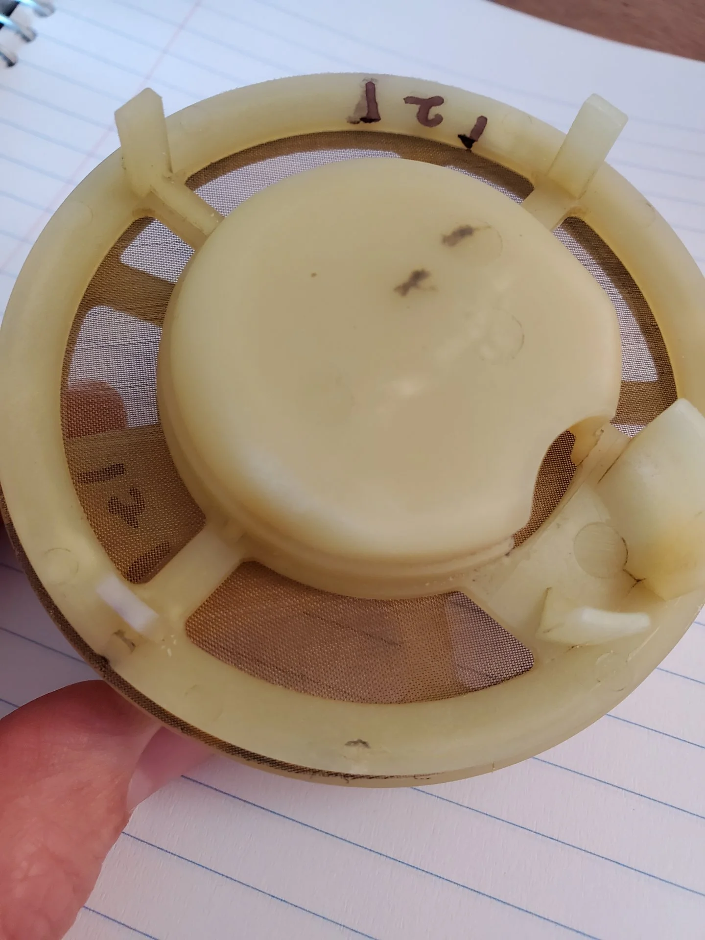

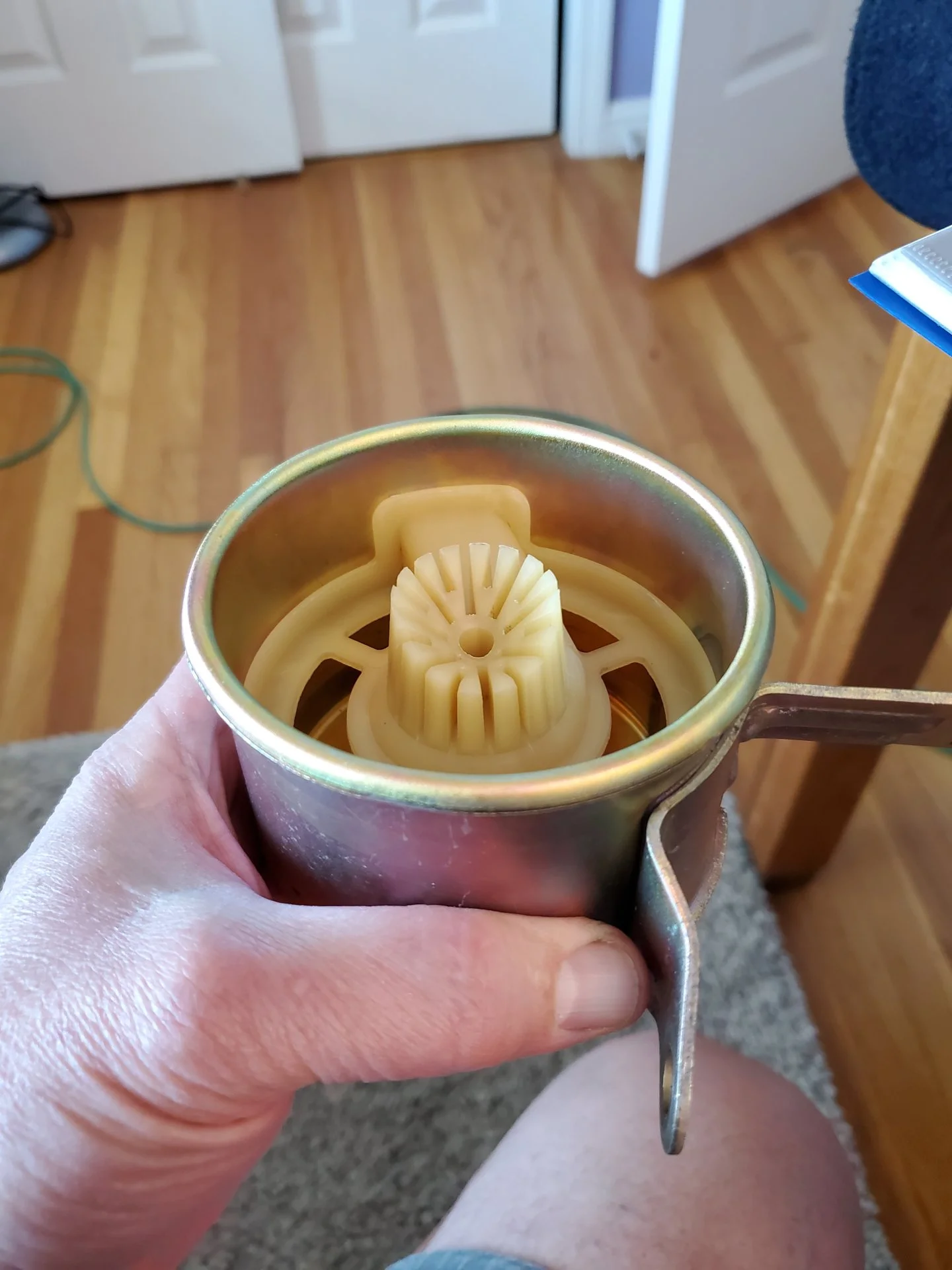

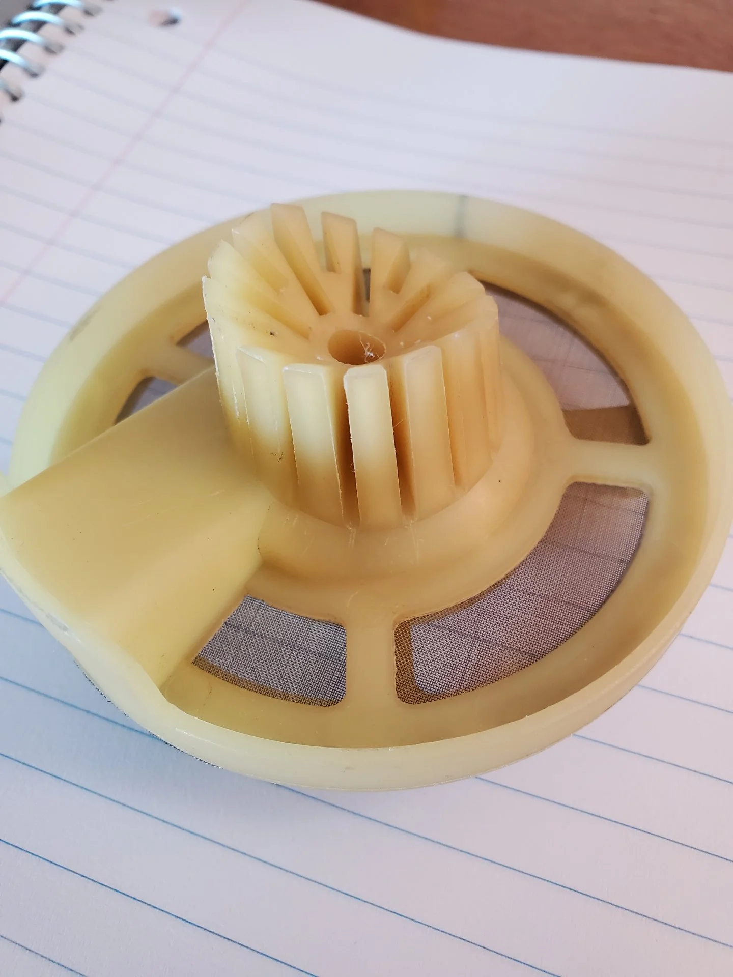

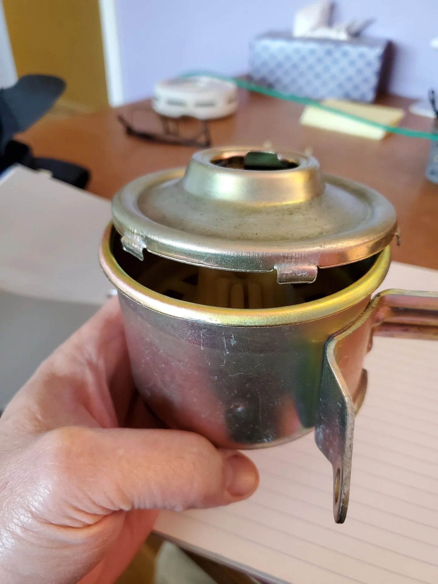

If your pump is making noise, it could be because the screen/diffuser inside the reservoir is clogged. There is a microfine screen inside the reservoir That needs to be cleaned.
Once your open the pump, you can decide if a new or rebuilt pump is needed.

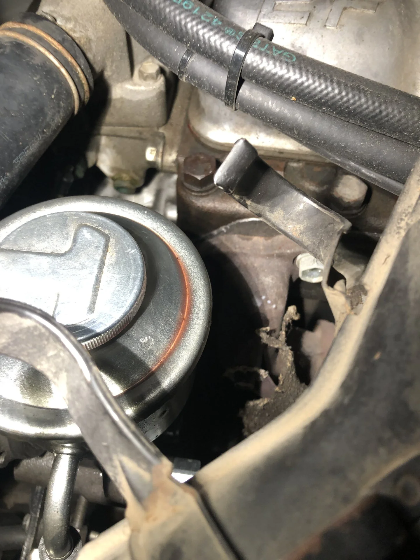

I recently replaced OEM power steering pump with a City Racer which I believe are made in China. I heard these were not as good as OEM but took the chance. Seems to be slowly leaking at the cap as fluid accumulates on rim of top. Worth trying to mend or time to go the Saginaw route?
If that's a used cap I'd first try using a new OEM cap.
