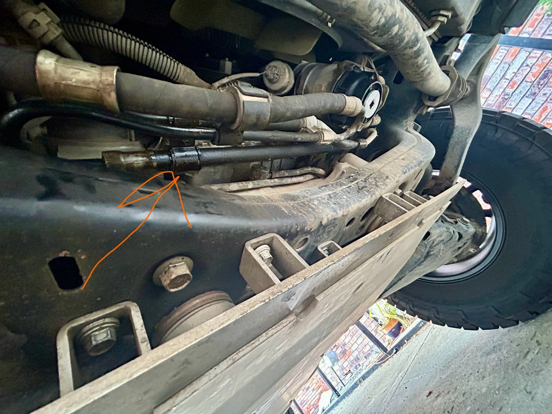

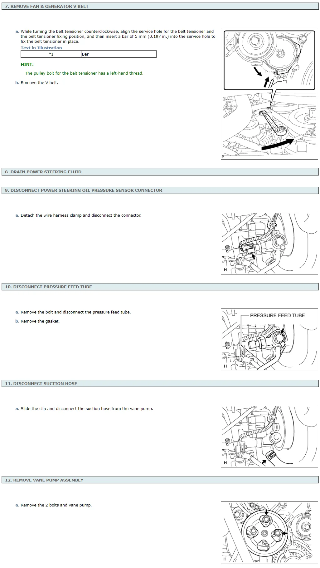

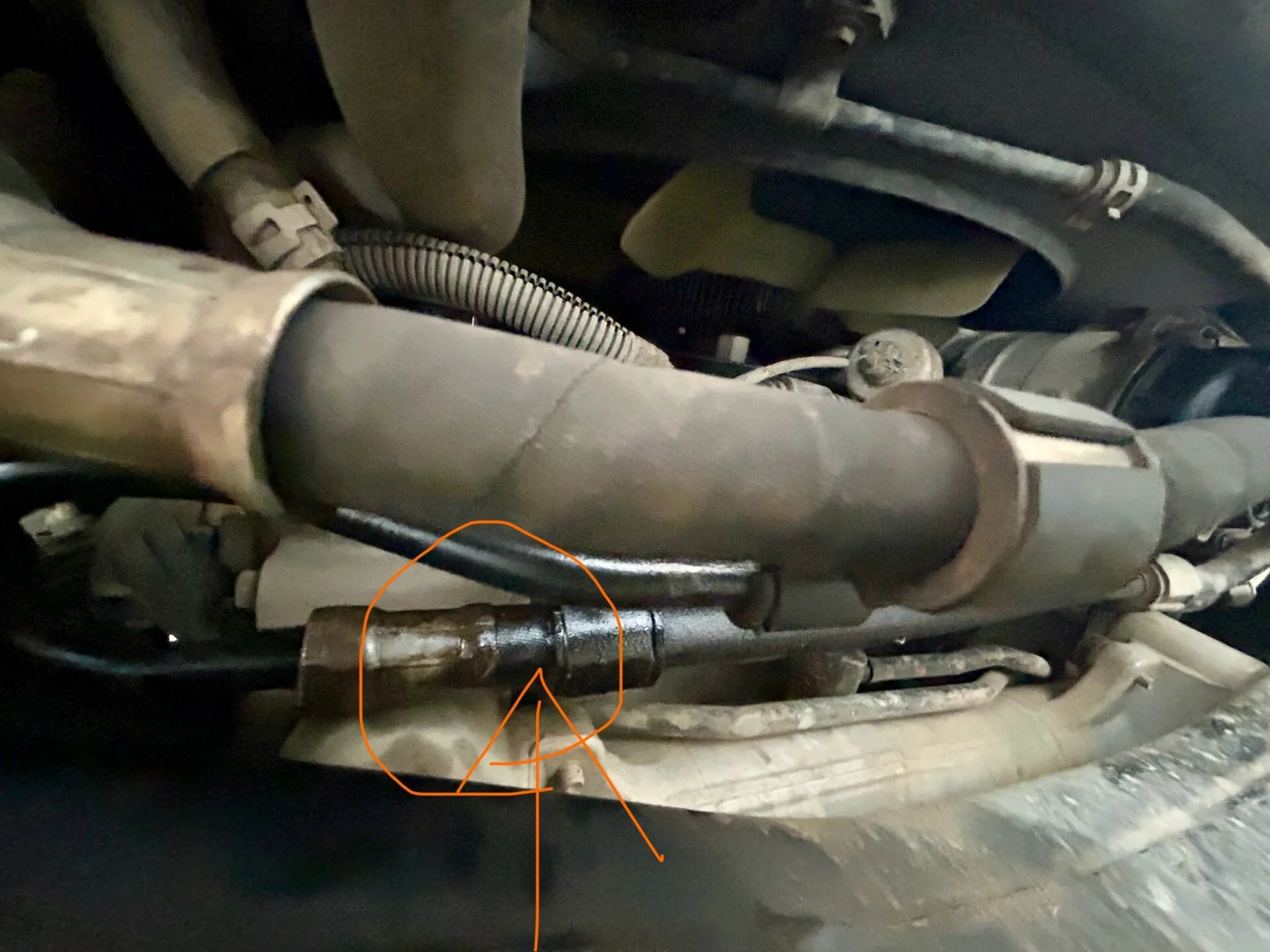

A few weeks ago I noticed some seepage coming from the power steering pressure tube/line. After cleaning up the area and monitoring for a week the area around where a soft line connects to the hard line is again wet with PS fluid.
I found some YouTube videos showing the job for the 5.7 2nd gen Tundra. Seems straightforward enough with the most challenging part being the process of getting a wrench on the hardline that connects to the rack/pinion.

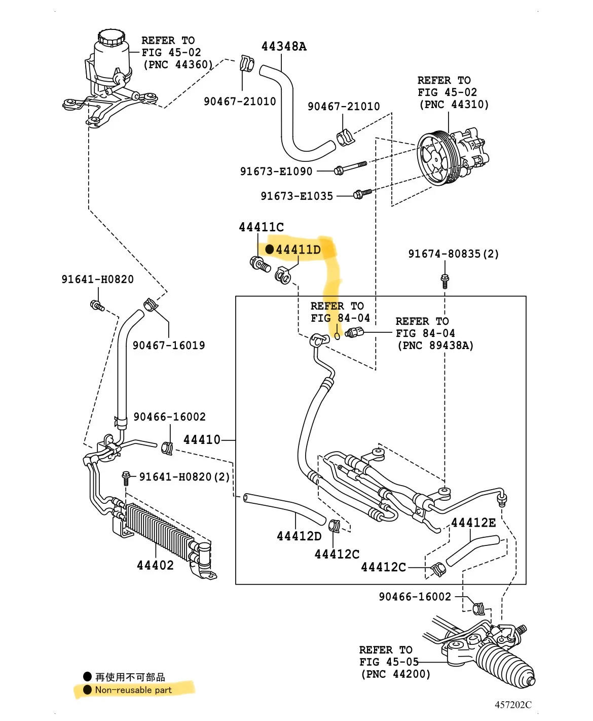

Looking at the parts diagram this should be a simple unbolt and replace and use new washers.
Are there any special procedures/processes for this job like bleeding the PS system?
If anyone is kind enough to share what the FSM has for this job I would really appreciate it.

So far I have the Power steering pressure feed tube, part number 44410-60710
I plan on also replacing part number 44411D shown in the diagram.

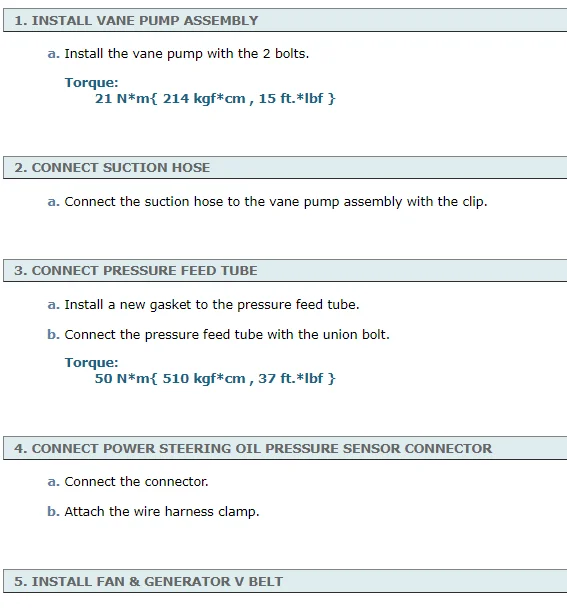

I think you're right it's as simple as you describe. Nothing particular in the FSM.
Removal
Install torque
I concur with Teckis, and yes replace that crush washer part. Also that part number is coming up as correct.

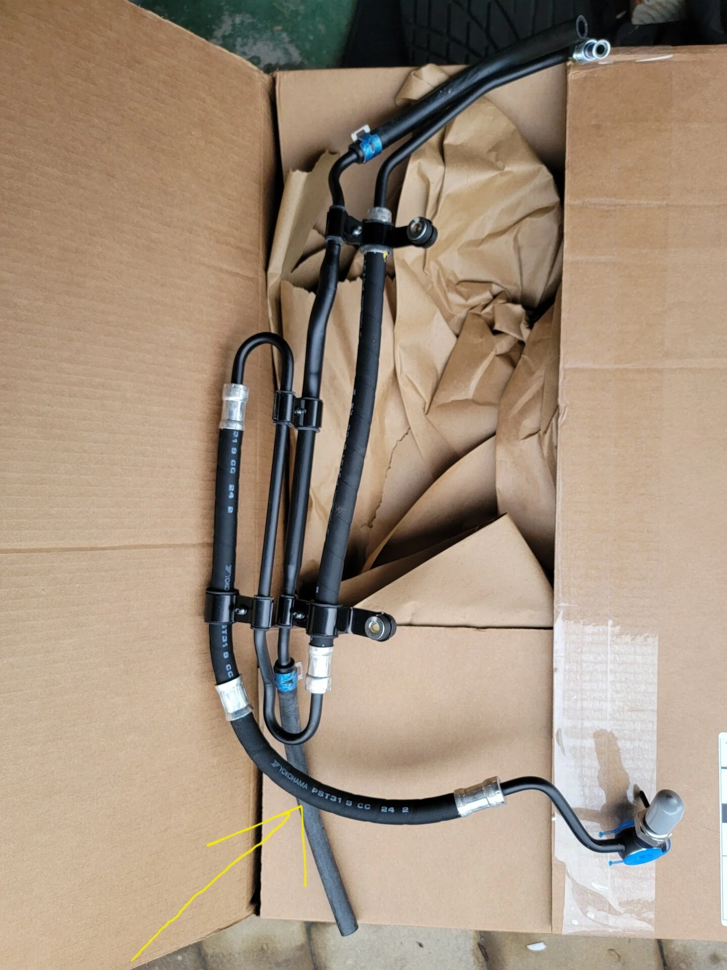

The new pressure tube assembly arrived. Nice to see "yokohama" on the rubber, more OEM Japanese manufacturered parts the better. In the past I was surprised to see OEM Toyota parts such their alternator and starter being made in the USA.
I'll be tackling the install in the coming days. Hopefully no surprises, crossing my fingers.

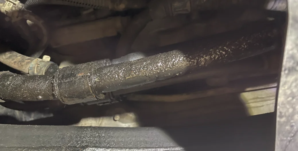

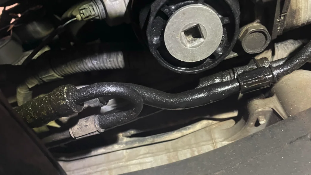

@TLC2013 Any updates on how the install went? I was under my LX changing the serpentine belt and noticed I have some leaking from the same line.

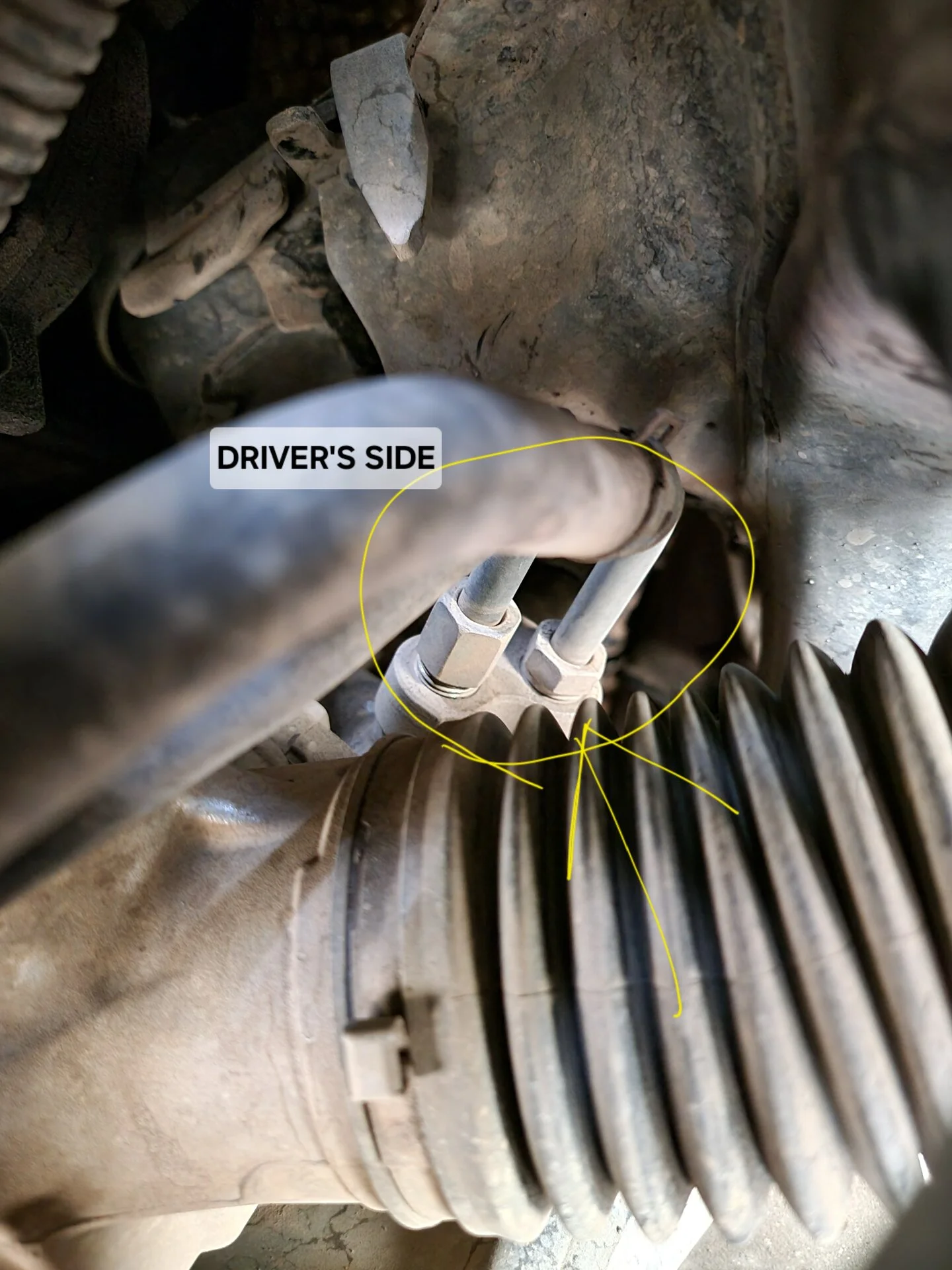

With the right tools: crow foot wrench, swivel sockets and access to a lift it wouldn't be too difficult. Pretty much just unbolting the old line from the power seering rack and reservoir and installing the new one and topping off the fluid afterwards.
However access to the drivers side where the two lines connect to the rack is a nightmare without the propper tools. Horrible angles to deal with and no room to maneuver when on jack stands/ramps. Dealer charges around 2 hours of labor so I had them knock it out in an afternoon. Money well spent in my book to be back on the road in a couple hours.
The OEM part here in the states was around $600 USD at my local dealership . Yikes!
I waited a bit and replaced it when there was one of the 25% sales being offered by an online Toyota dealerships parts dept. These sales pop up a few times a year and can save a bundle. The seepage was so minimal that it didn’t even register below the fill line in the reservoir.
I have the same sweating leak on my '16 LX570. Power steering reservoir doesn't show low, and it wipes on a towel as dark, not red ATF.
Going online to source the part. Was going to go with 44410-60710, however it looks the part sites quote a different part for the '16 and later LX vs the '16 and later LC200. Caught me off guard since LC and LX parts are almost always the same for these type of things. Looks the washer near the vane pump on the LX version is slightly larger. And of course it is $50+ more....
For those interested - the '16-'21 LX570 the part shows as:
44410-60A20 - TUBE ASSEMBLY, PRESSURE FEED
and
44327-30040 for the non-reusable gasket needed.
I am going to order this and bring to my local shop with a lift, since it looks like getting the nut off the steering rack is a PITA.
