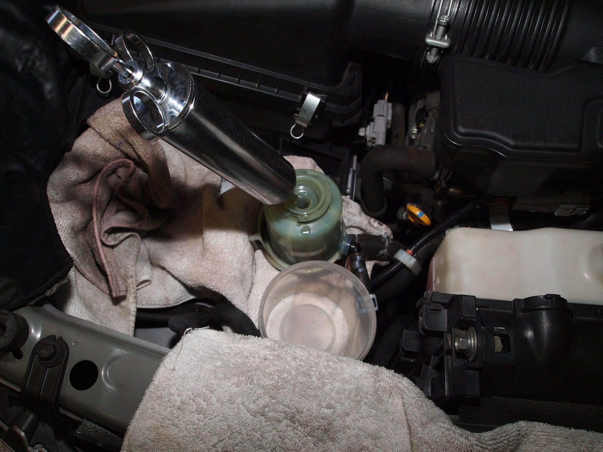

Just performed this service using a MitiVac Fluid Evacuator. It was incredibly easy.
1. Drained reservoir with MitiVac
2. Pulled return hose off reservoir, inserted MitiVac hose into return hose.
3. Pulled all fluid out of rack and lines
4. Plugged return bung with home made plug
5. Filled reservoir with new fluid, add vacuum with Mitivac, continue adding new fluid until fresh fluid is pulled thru return line and into evacuator.
6. Re-attach return line, start truck, top up new fluid, test drive, re-top up.
I used almost 2 quarts of fluid, because I flushed thru too much new fluid, but I wanted to make sure it was 100% clean.
