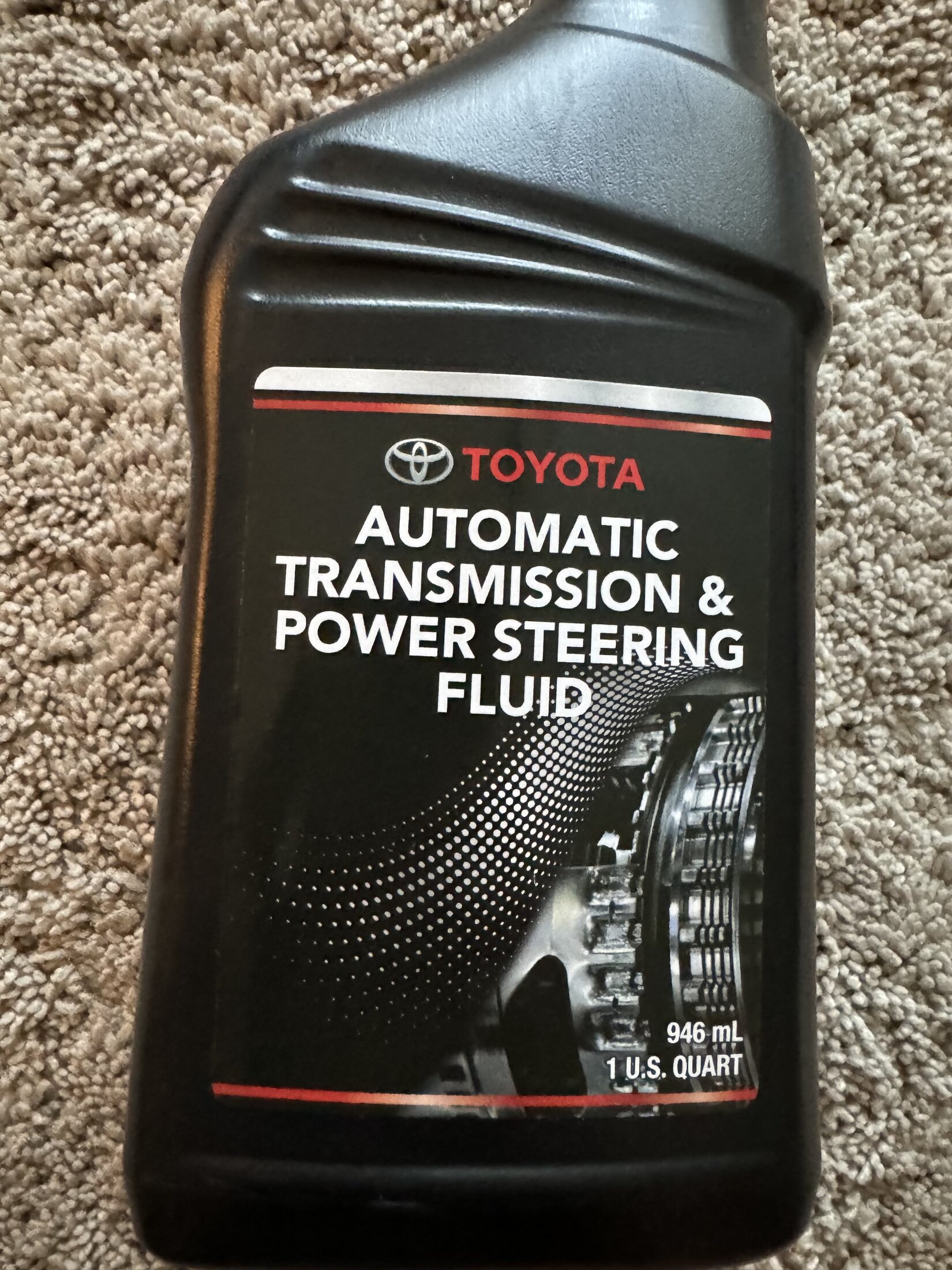

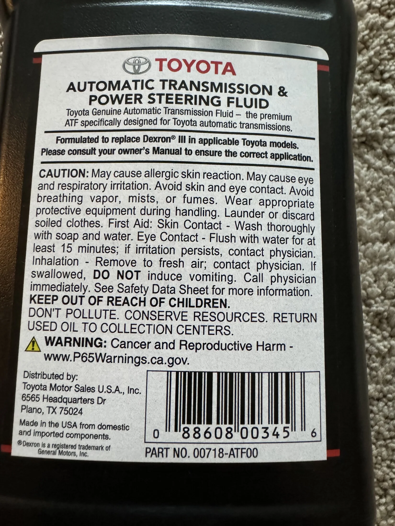

I used the Toyota 00718-ATF00 fluid shown above
I basically followed the procedure shown in posts 36 & 38 here.
I don't remember this being the exact thread I referenced, but the procedure looks the same.
Thanks man. It wouldn’t show up on Amazon until I used that part #
All good
Thanks
Not sure how much it is on Amazon, but you can get it locally at Norm Reeves for ~$11 / qt (order online and pick up)

I noticed that under maintenance section of the Toyota dealership they had specific power steering fluid. So I purchased for the next flush.
My last ps flush I had purchased 2 quarts atf t-iv. @bloc had posted that is what the fsm recommends. Ccn did my ps flush. He used it without issue.
Post what the new PSF looks like from Toyota.
