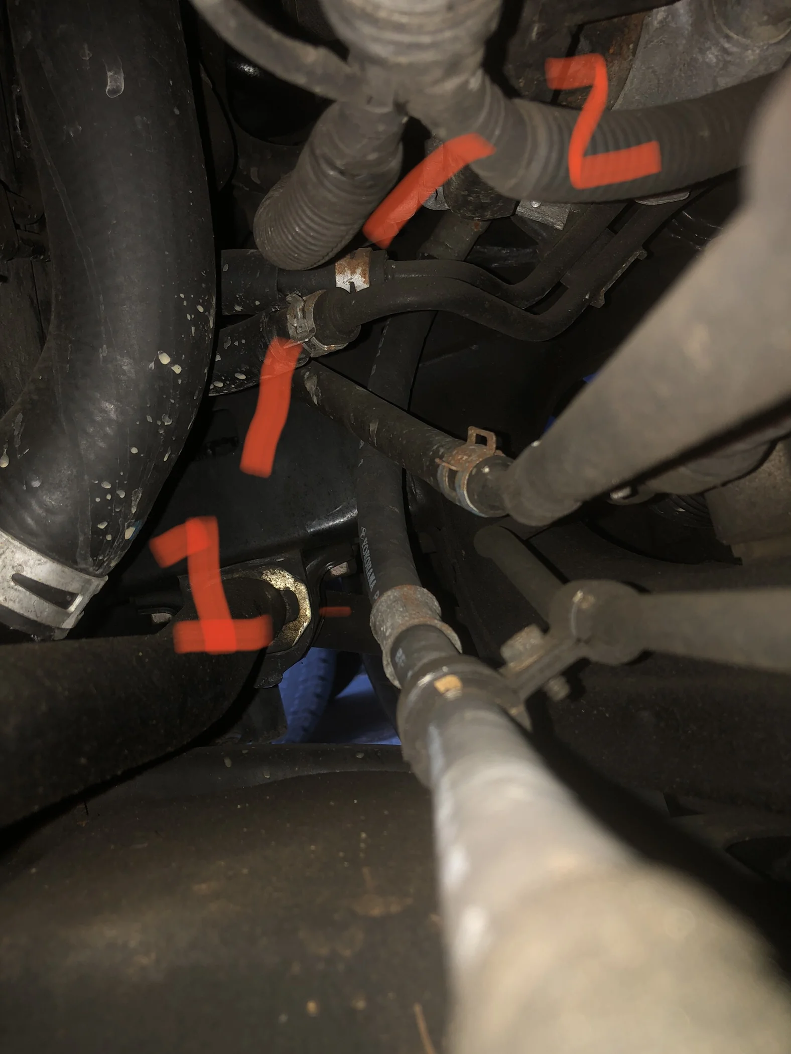

Hey all, going to do the trans fluid tomorrow. I’ve done it before on a 4Runner so similar system. I took a look at the diagram and I’m just trying to confirm which line I want to pull and use for the drain. It should be the top line #2 if I’m reading the diagram correctly, just want to verify it should be that line and that line feeds the cooler and isn’t the return. Thanks all!
I'm about to flush mine for the second time. In this video, it shows the top line (#2) as the return from the radiator. He connected a hose from the metal hardline going back to the trans into a bucket.
Never mind, using the trans line that comes off bottom of the radiator on the passenger side. I knew there was an easier line just couldn’t remember where. Thanks!
