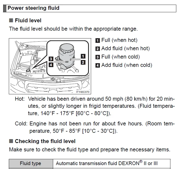

If so, is it okay to use the recommended Toyota ATF Dex II or III and just do the remove / replace of the reservoir, multiple times? I wasn’t sure if mixing fluids was acceptable since I am not 100% what is in there currently.

The book explicitly says dex3, but what’s in there isn’t red, when it is new it’s gold colored. But all we can do is put in what it says. I even went with the backwards compatibility of synthetic stuff and have been running dex6 for 30k with no issues.
But yes it is a good idea to do a fluid exchange. I’ve done a couple on these and prefer to do them with the engine off.
Jack up front of vehicle enough to cycle the steering with the engine off. suck the fluid out of the res to reduce spilling, remove the return line to the res. Then I like to cap the return nipple, and put the return hose into something that can catch fluid.. the disposable 1-qt paint liners at the hardware store are perfect.
Then top up res with new fluid, and when you turn the steering back and forth it will pump the new fluid into the rack replacing the old, all without the engine running. Don’t go crazy steering it before you get an idea of how quickly it pumps through.. it is surprisingly quick, and I’m sure you know you don’t want to suck air into the system.

Thank you all for the valuable feedback. I just ordered 4x Qts of 'Toyota Automatic Transmission Fluid-(DII) - Toyota (00718-ATF00)', which should do the trick and will be replacing the fluid upon arrival. Per my user manual it shows this should be compatible
**Edit - I tried to find the specific Toyota Part number for ATF DEXRON III but it keeps translating back to ATF DEXRON II on website descriptions.**
