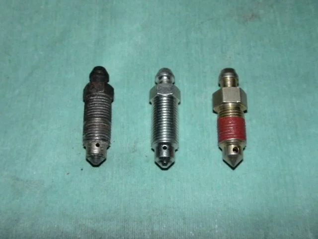

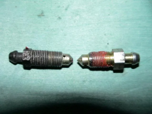

The brand of Speed bleeders I used would not seat properly in the rear calipers, the front were OK. Here's a photo of three bleed screws; the original Toyota part on the left, a new Toyota replacement in the middle, and a Speed bleeder on the right. Note that the OEM bleed screws have a shorter blunted tip and the Speed bleeder has a pointed tip; that extra half millimeter prevented the Speed bleeder from seating all the way in the rear calipers only. I ended up using OEM style bleed screws for the rear calipers but probably could have just filed off the tip of the Speed bleeder and used that. Another small thing; with this Speed bleeder due to the nut part being situated lower than the Toyota bleed screw your wrench will not clear a bolt on the caliper so you make a small turn, reposition the wrench, turn some more, etc. A small socket may work better. IME the cheapo one-man bleeder bottle worked well.

Rwhat: the point I was trying to make is that with Speed bleeders due to the pointed tip you may never get a tight seal on the rear calipers. Unless my OEM calipers are different from yours, the speed bleeders never would completely seat in the rear, also assuming they are the same style/model of Speed bleeder shown in the photos above. I was able to bleed the front calipers with Speed bleeders no problem, just hooked up a hose to them draining to a container, and used the one man bottle for the brake proportioning valve and the rear calipers. IME the most important thing is to follow the proper bleeding sequence starting with the brake proportioning valve.
The Speed Bleeders look shorter? Are you sure they were bottoming out and not just not sealing incorrectly?
They look shorter because the nut part that you use to tighten them is lower down on the screw and the threaded section is shorter. IIRC they were almost the same overall length. If you look closely at the used Toyota bleed screw you can see that only about half of the threaded section is used, the rest just gets rusty. The problem I ran into is the shape of the tip as discussed above.
