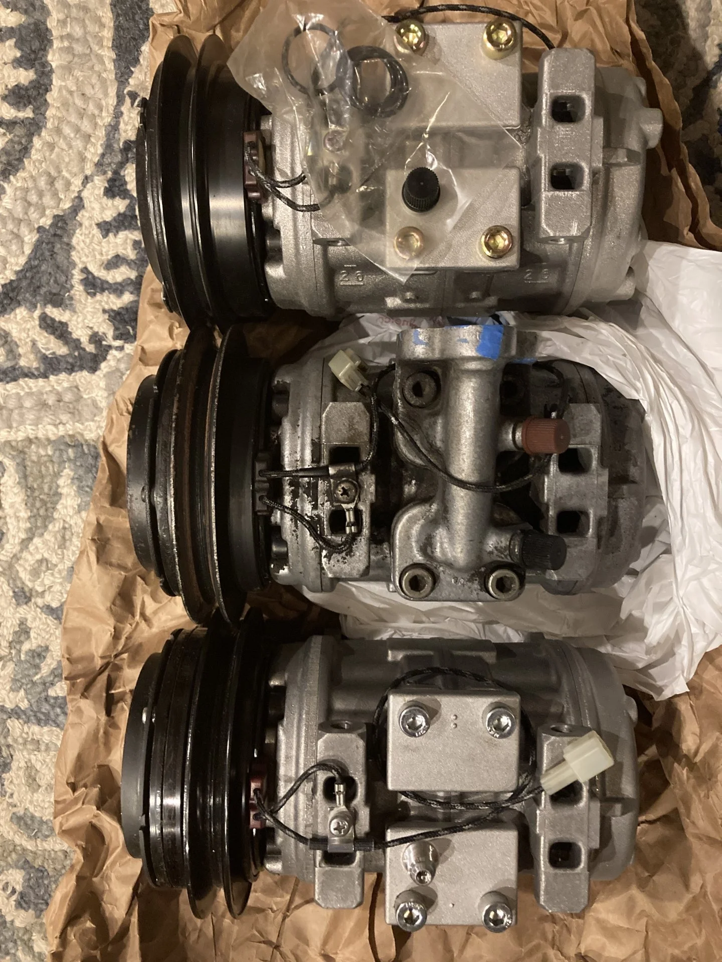

I also think you need to get the pre-load correct.
Since I shelled out for a new unit to fit an '88 62, I'd prefer not to dick around with it, void the warranty, get the pre-load wrong, etc...
Also, no idea if the clutch on the used one is any good.
I contacted CoolStream yesterday and he is getting another unit o/n to see if it matches what I am looking for. He thinks I got one that was put in the wrong box.
Since they are willing to check it out, I will hold off on swapping...
You can test the clutch by putting 12v to it. Should lock up it up if working. I know the clutch on mine was frozen, but yeah it probably needs rebuilt overall. I've gone through a few threads.
Sounds reasonable! If I can get a new clutch that fits vs one that has been cycled 8 million times, I will go for it. Hoping once this compressor goes in, she does not come out again for a while...

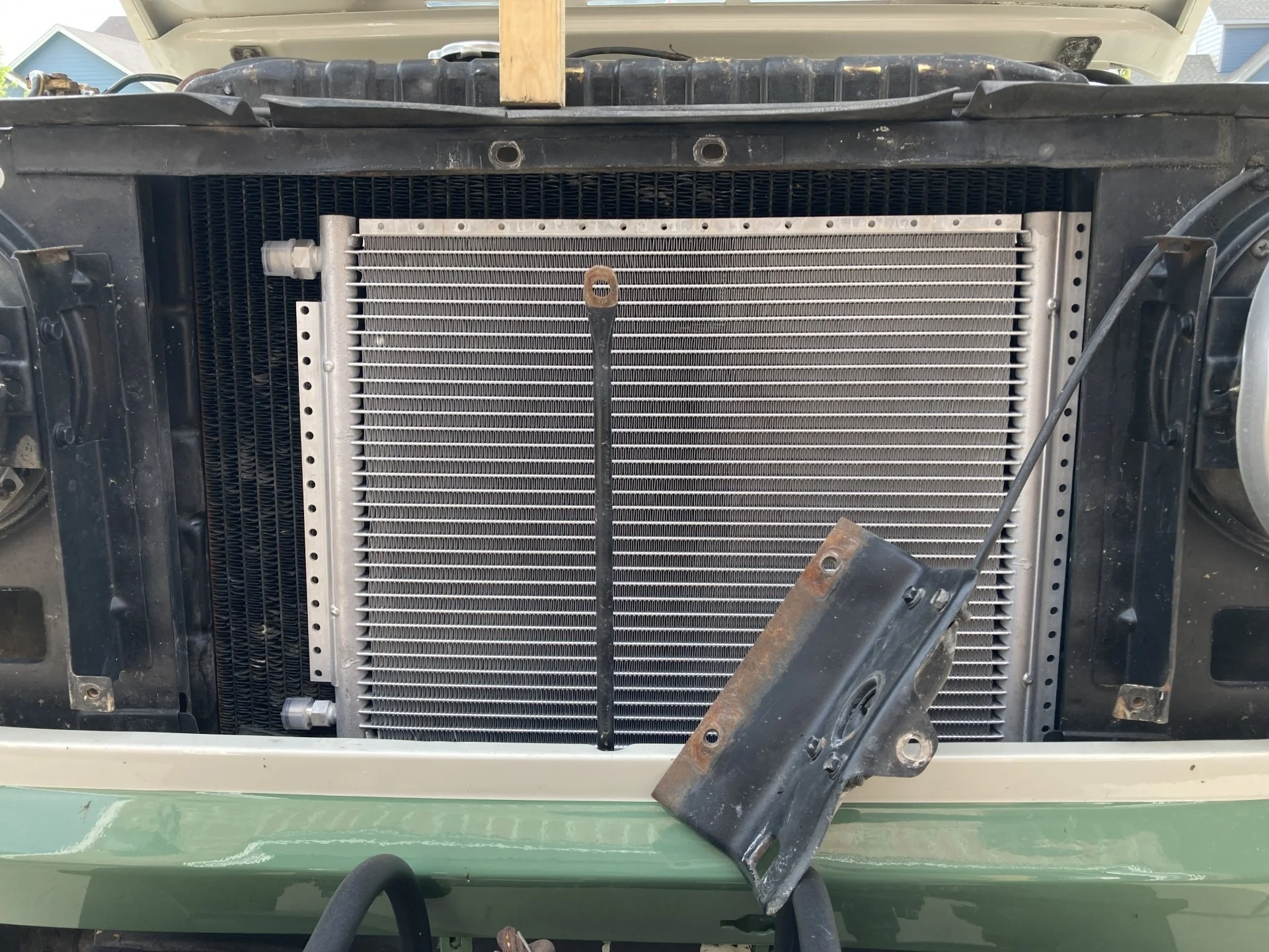

I am hoping this condenser will do the trick! Need to make some custom hoses to tie all this together...

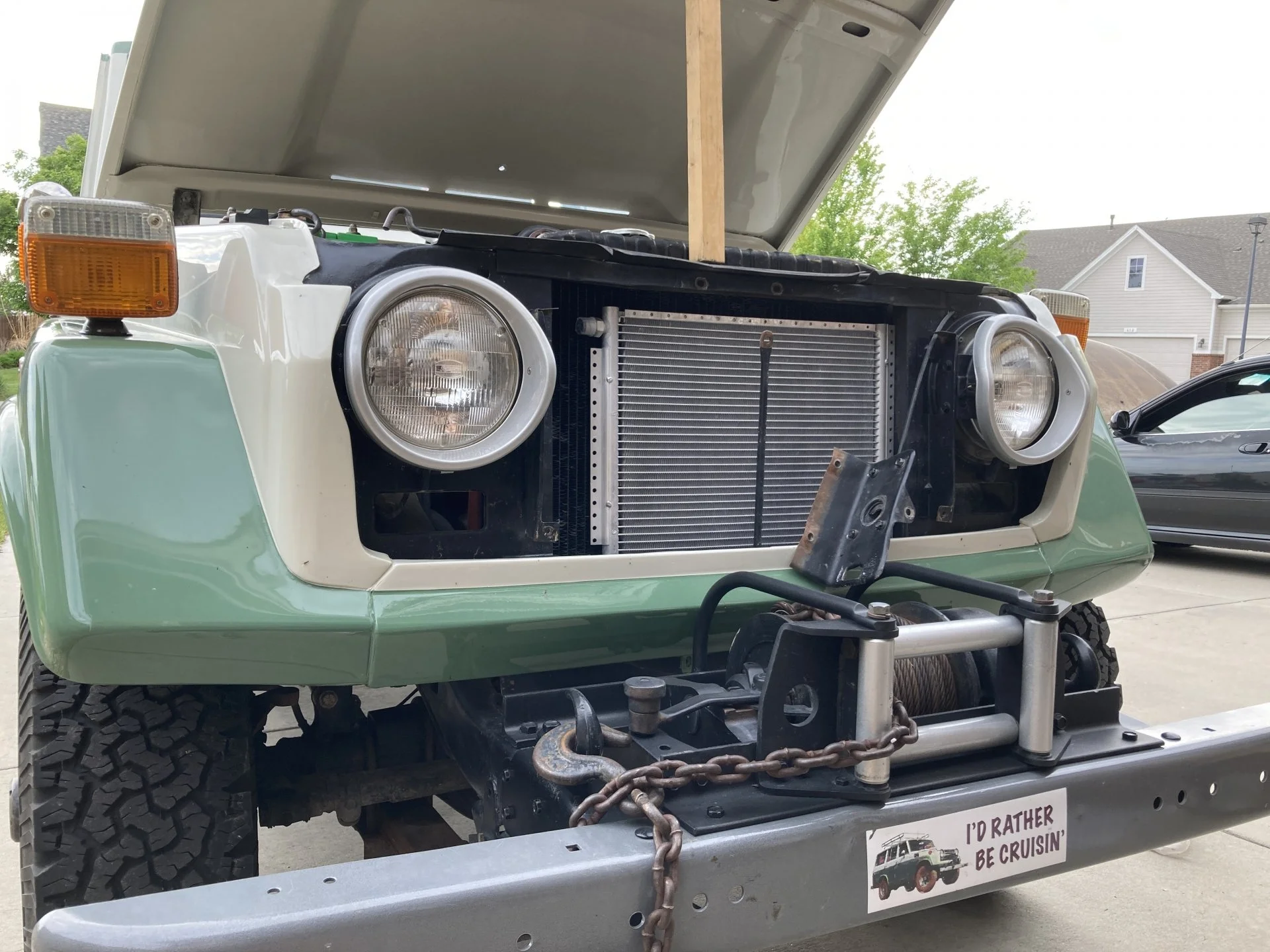

Watch that piece of wood!! Ouch ☹
You watching my wood Bob?
That prop keeps the hood level, not crooked like the prop rod. I am pretty sure the prop rod putting the hood crooked so much causes that crack you see on the 2F hoods.
I don't of this problem, any more info on it, pictures, etc. I never heard anyone mention this.
I will see if I have a picture of Ben’s hood before we painted it.
Look on the passenger side, around the contours where the bump starts...

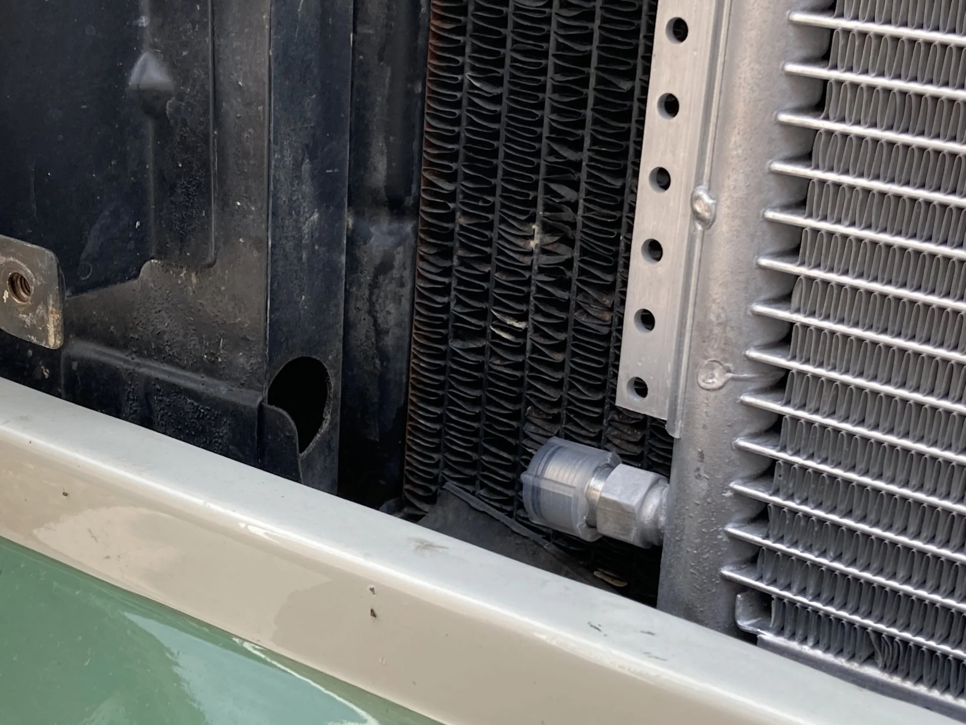

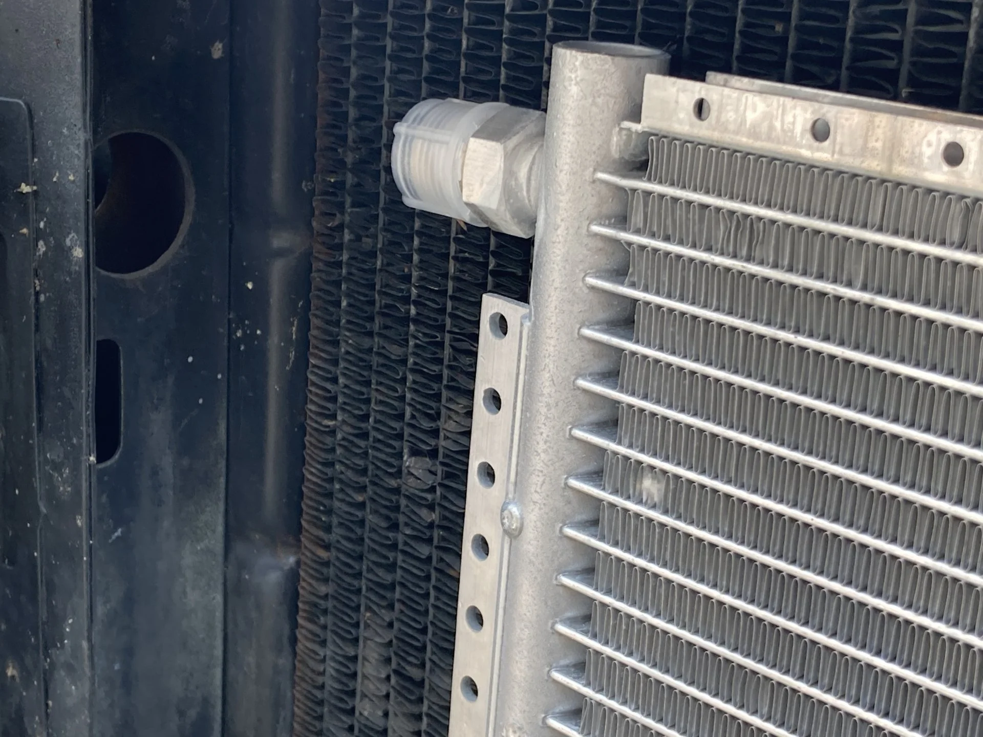

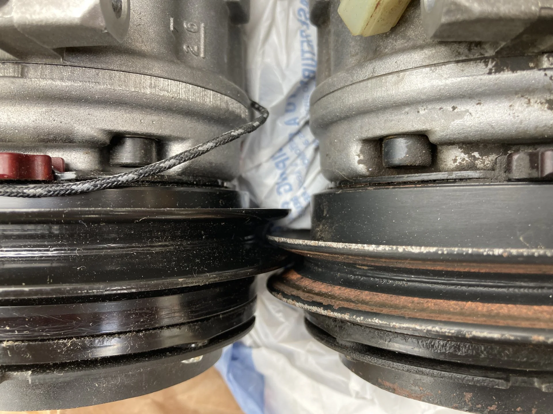

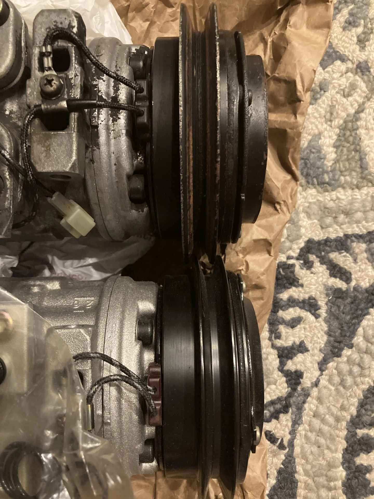

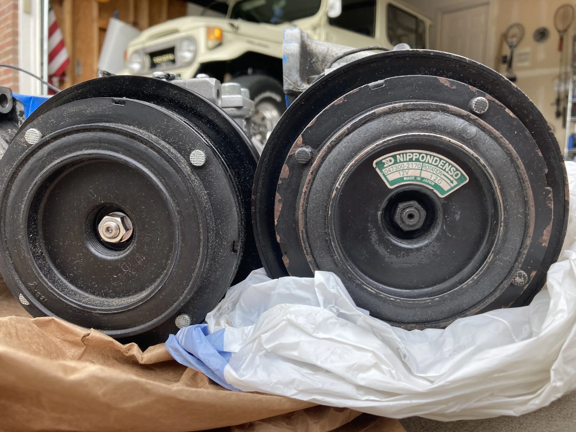

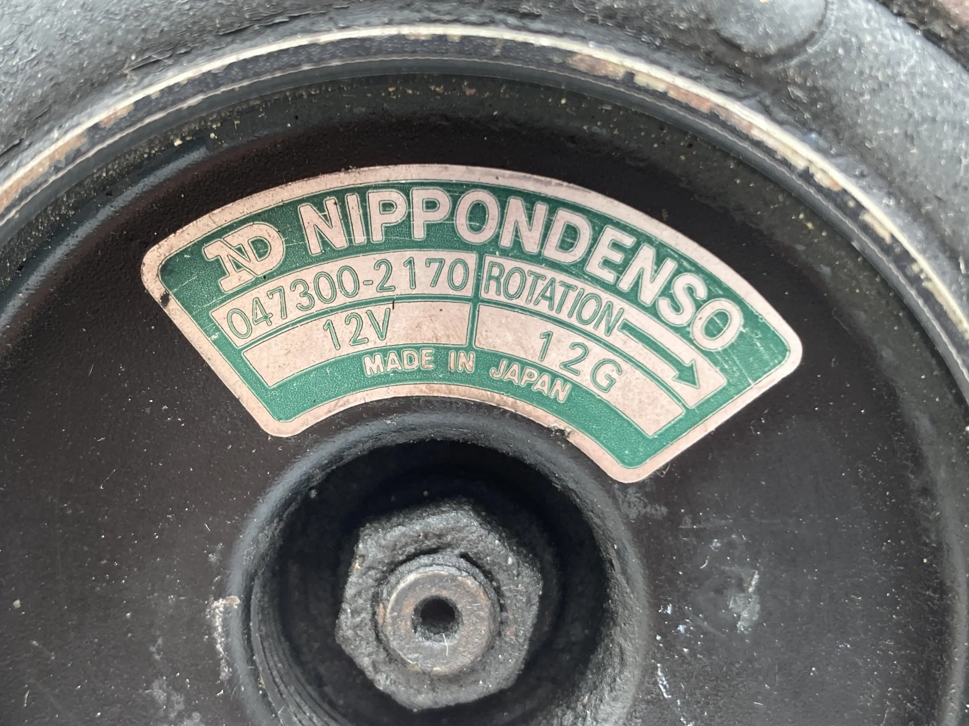

Coolstream tried to hook me up with a Father's Day present, but strike two.
This one has the belt groove too far out, away from the compressor body.
