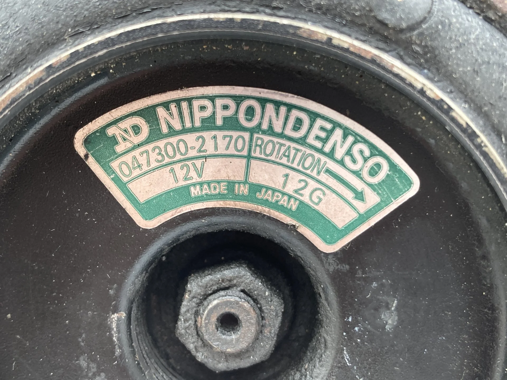

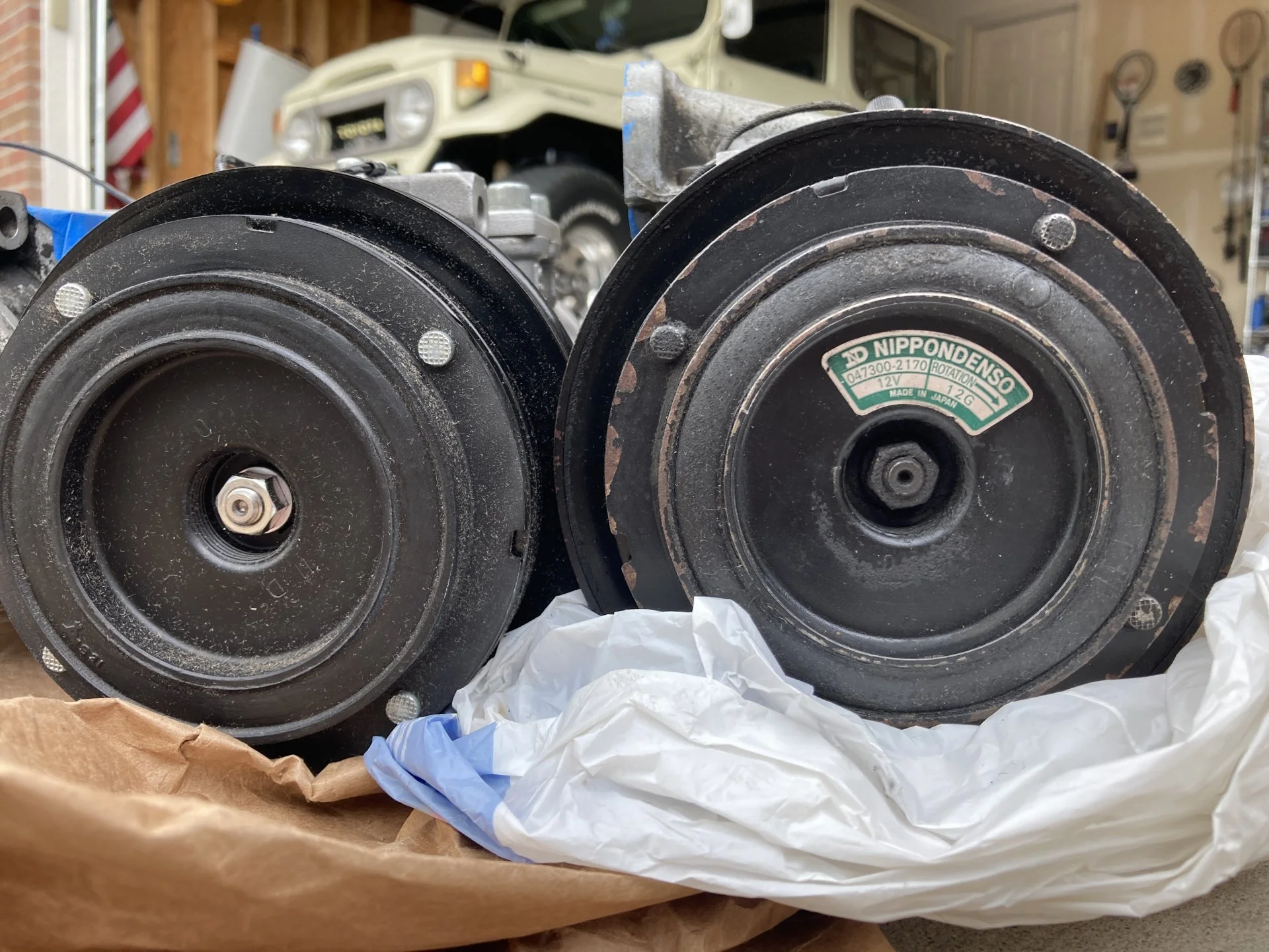

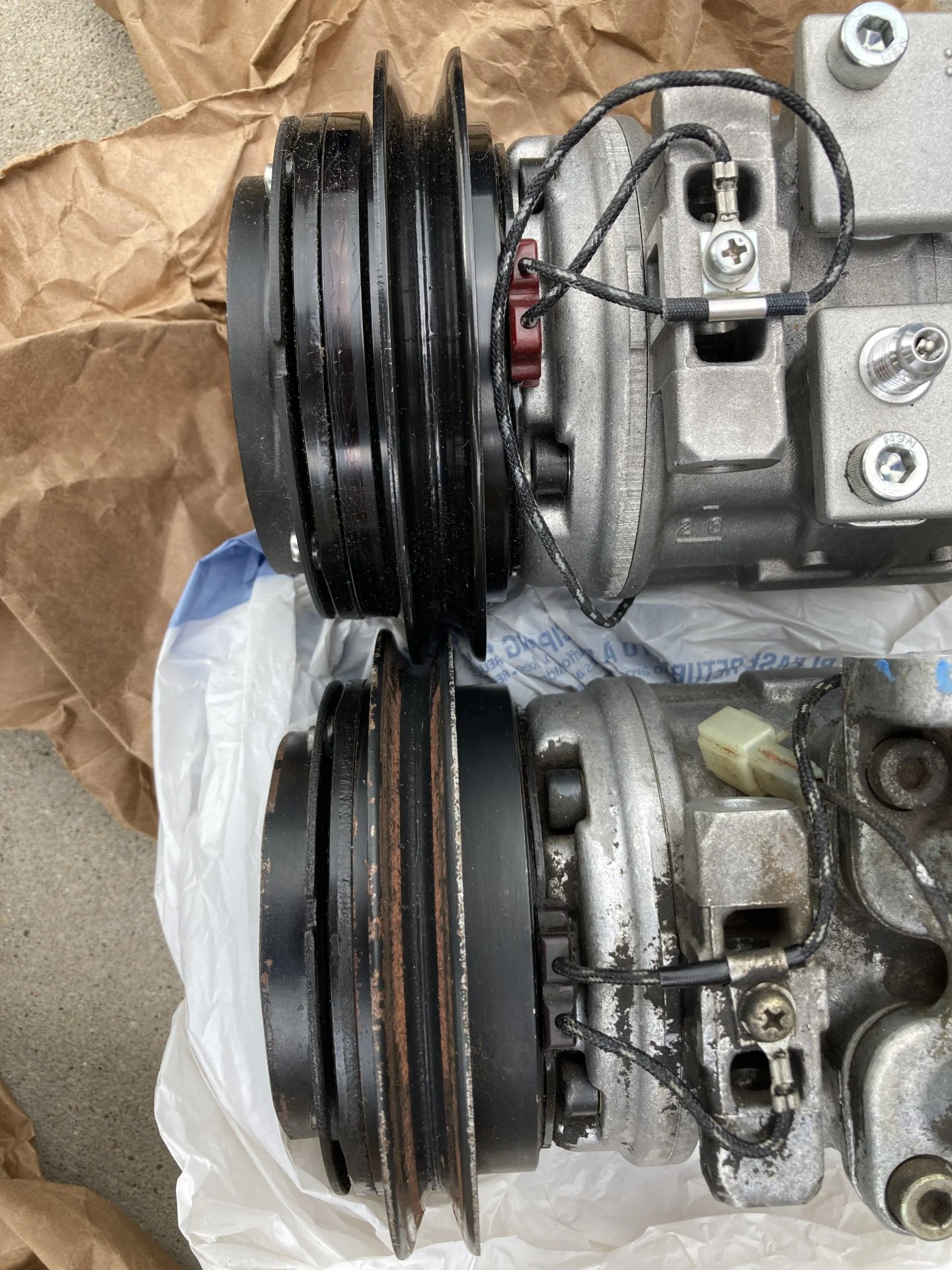

The used 10P15C Denso lines up perfectly.
This new one I got does not have the same clutch/pulley configuration.

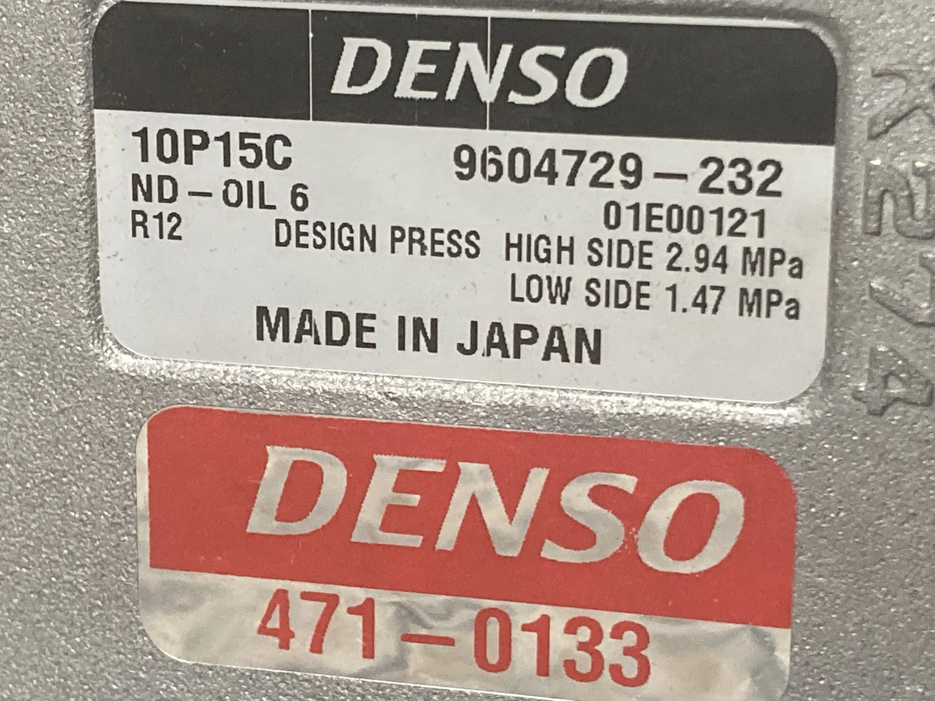

Do you know what model you have?
I believe it’s the 10P15C, same thing. I’ll dig up some pictures.

What's the reason you can't switch clutch pulleys?
I think you can!
I also think you need to get the pre-load correct.
Since I shelled out for a new unit to fit an '88 62, I'd prefer not to dick around with it, void the warranty, get the pre-load wrong, etc...
Also, no idea if the clutch on the used one is any good.
I contacted CoolStream yesterday and he is getting another unit o/n to see if it matches what I am looking for. He thinks I got one that was put in the wrong box.
Since they are willing to check it out, I will hold off on swapping...
