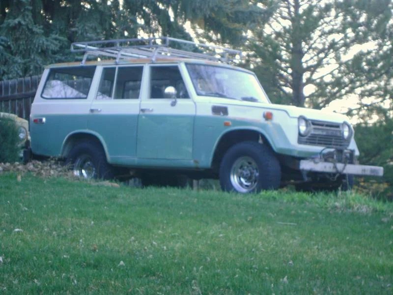

The first pic is from Cruise Moab. Me, my Dad, and my son. 3 generations gathered by the Pig.

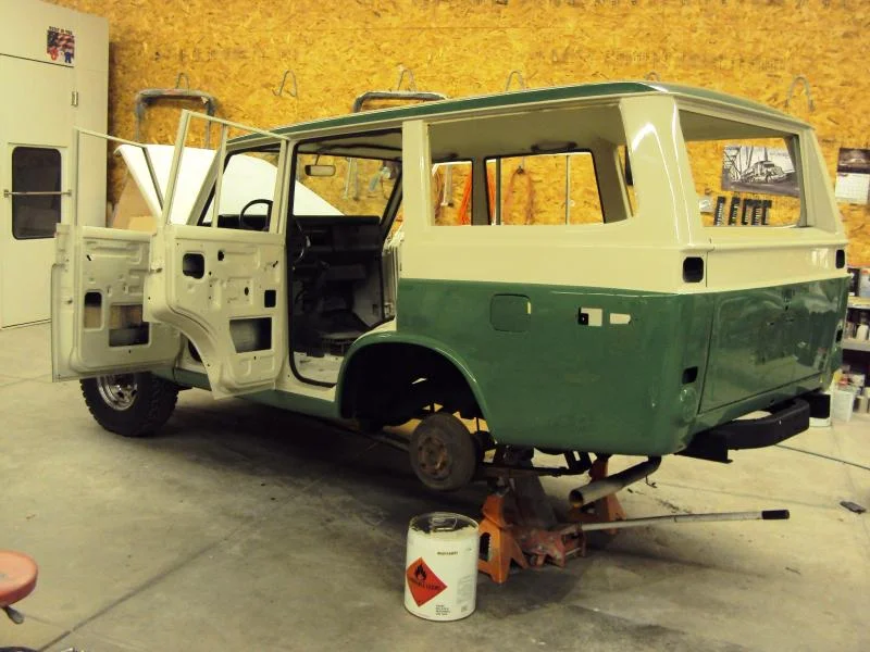

3rd picture gives a good sense of how the roof skin was looking before we started the painting process.

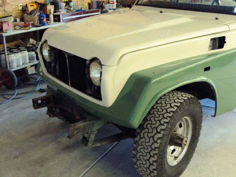

Now the paint was starting to flow on the exterior of the Pig - pretty darn cool!

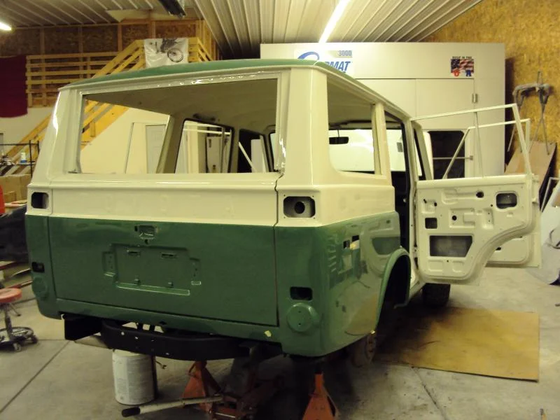

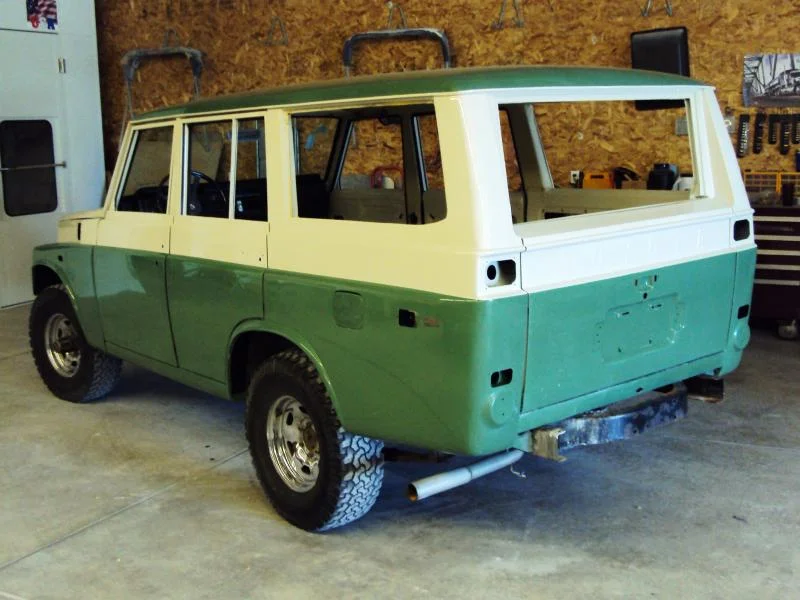

We got the exterior of the main body shot first, then onto the removable things like doors and hoods. After that we shot the interior. And when I say "we" I really mean Clarence, the painter. I did anything I could to help and not hinder the process. This guy was a pro and really knew what he was doing, so I just did what he told me to do and stayed out of his way.

During the painting process did you paint the whole body white and green then clear it? How did you go about dealing with the two different color changes?
Ah, I am right there - see my post #90... We put the lines on the body shell and then would put on the doors and tailgate to align them and set our paint break lines.

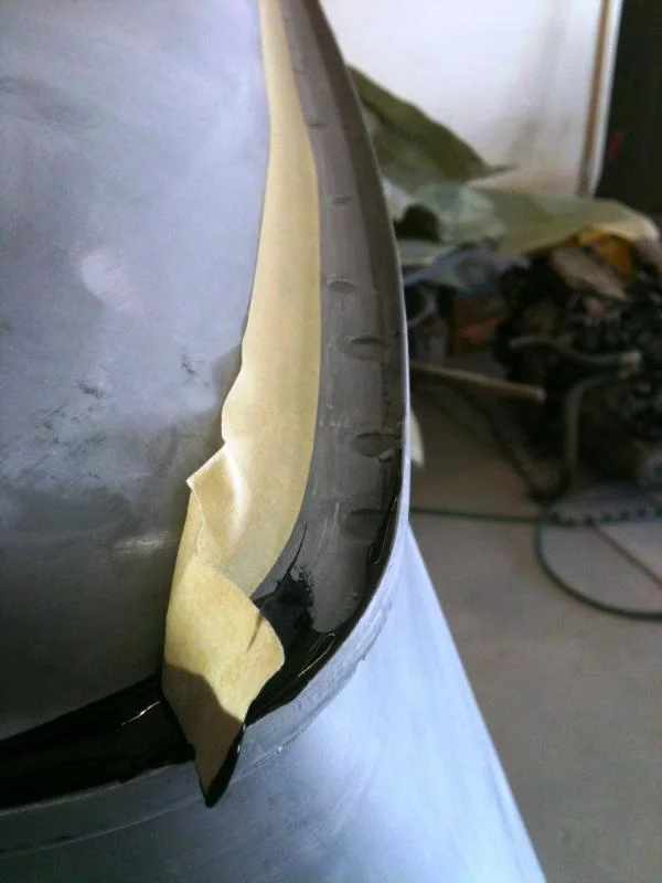

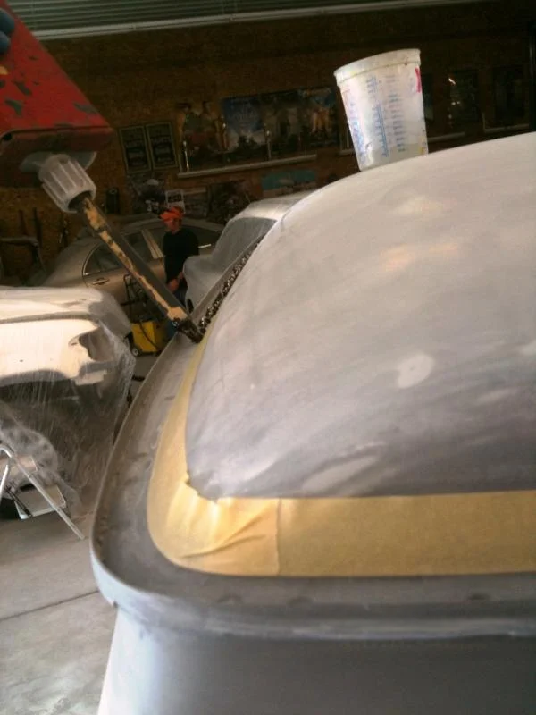

Rain Gutter
Some of my photos are a little out of order. I took pictures on a few different cameras, and they name the files differently, and organize differently on the computer. Some of them show "Date Modified" as the actual day I took the image, some have "Date Taken" field left blank :confused:

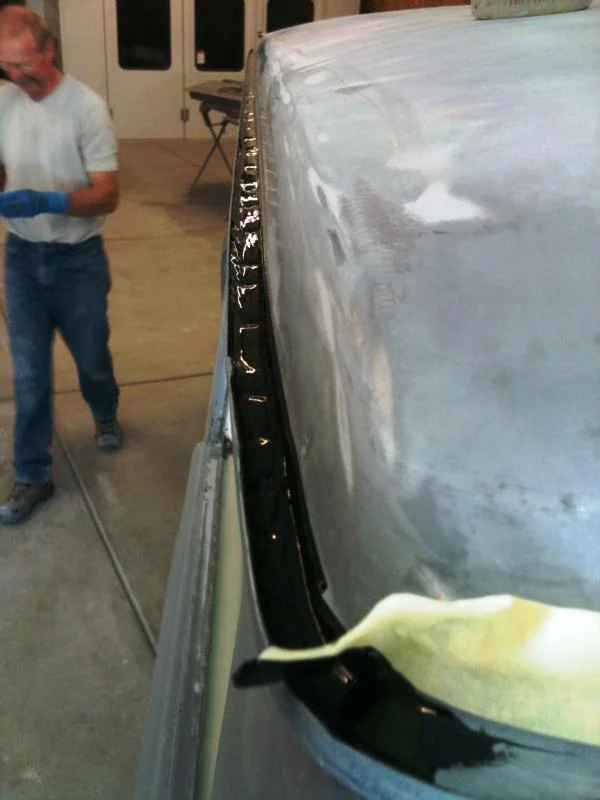

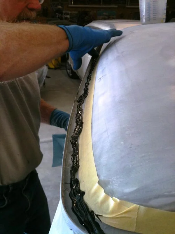

Anyway, I found these pictures where we sealed up the rain gutter before shooting the roof cap.
