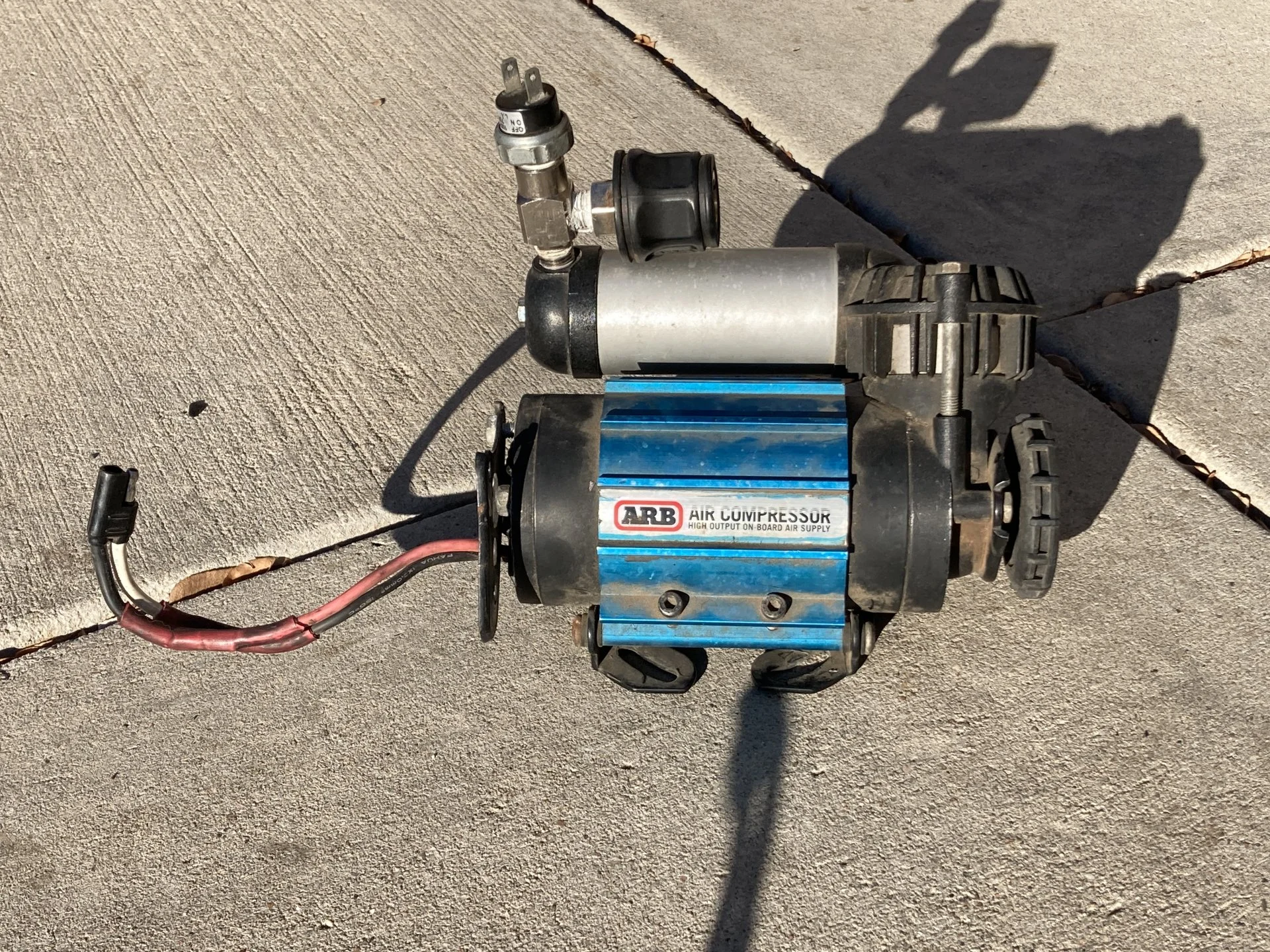

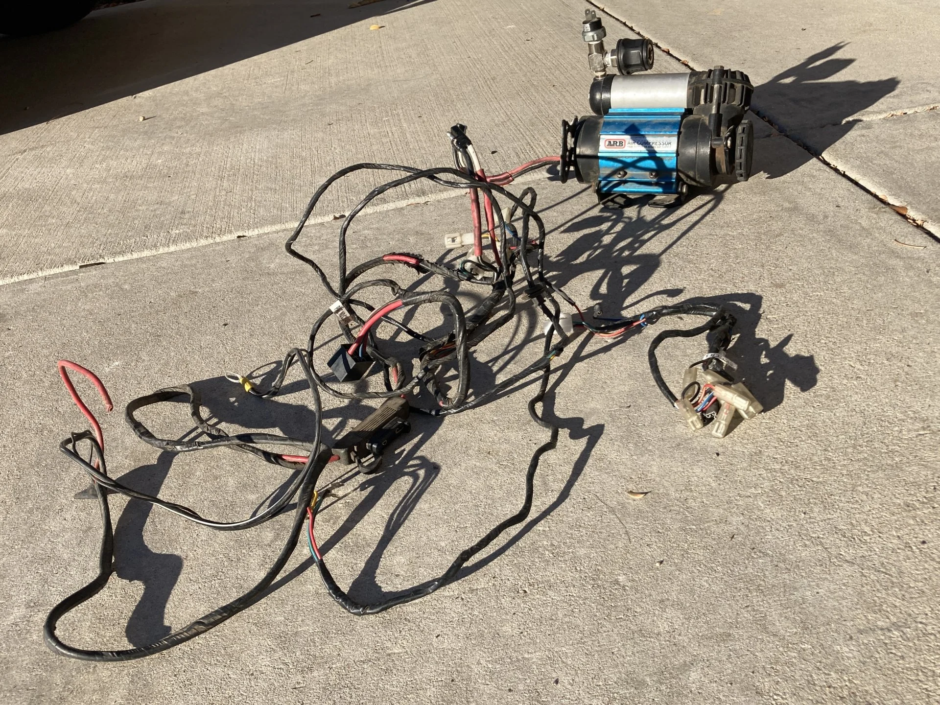

And then I came into a ARB compressor thank you to @Laughingjackal
Time to figure out if that ARB in the front axle that came from @FJBen can go into the rear of the Pig. If it has to stay front, I would probably stick it in the front of the 40. The 40 already has Aussie in the rear.
My booty fab attempt at using the FJ-62 air cleaner is going to get in the way. Gonna have to clean up some things under the hood. Air cleaner, I have never like my post-fuel pump fuel filter arrangement either. Not very tidy. The Passenger side of the engine compartment is about to get more complicated...
