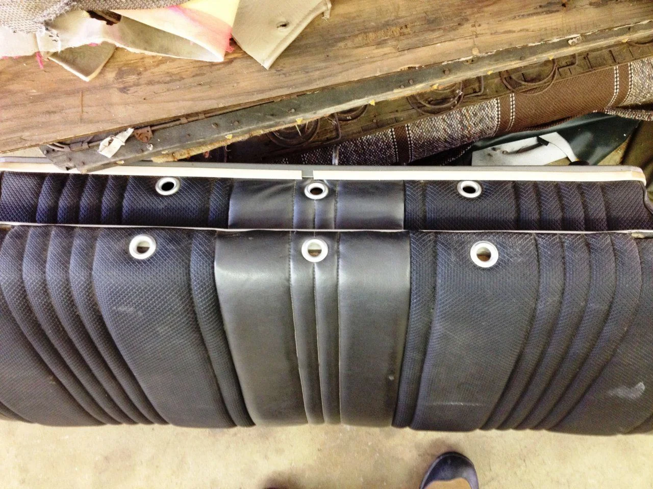

I dropped the seat off on 6 Sept while I was in the area at a car show. The guy said he was a week or two behind, and it would take him a week to do the work. So I am thinking I will get the seat back on or around 27 Sept for $500. I thought the $500 was high, as it was what I paid for the front seat, and that was more work, but then I had to realize the front seat was done 6 years earlier. So I said "O-K".
Fast forward to 1 November. The seat is ready to be picked up! There were a number of issues that came up to delay the job, blah-blah-blah. So I drive the Pig to the upholstery shop to pick up the seat. It looks good so we install it in the Pig, and I notice the pleats in the seat back, don't line up with the pleats on the seat bottom. Hmm... I point this out, so the guy says he will take the seat back out and pull the cover over. He is gone for a few minutes and then comes back. We put the seat back in and the pleats still don't match up. At this point I am bumming. The guy is confounded. He says he followed the originals exactly. He takes the seat back off again and says he will try it again.
Now I will say this, the guy is not young. He is an old-timer. And taking the seat back in and out is not effortless for him, I can tell. I am starting to wonder if I am being a dick? I don't want to be unreasonable to the guy, but I also want a good final product if he is expecting 5 bills for the job. I remember that I took a bunch of pictures of the seat when I took it out in case there were any questions. So I pull out my phone and start flipping through the pictures of the original seat, and Son-Of-A-Gun! Look at this pic below! The factory didn't have this $h!t lined up evenly! If the guy followed the factory pattern, no wonder they weren't lining up. And I never noticed... So the guy brings the seat back out. We install it. Again. and the pleats still don't line up, again. I tell the guy that I love it, and ask how much I owe him? $450. Deal.
I was glad I had that pic to help me through the decision making process.
Probably a longer answer than you were after! It just seems like it is getting harder to find shops and pros that will/can do any work on our old Piggies. I wanted to get a good result, and also treat this old-timer right at the same time. I hope I did...

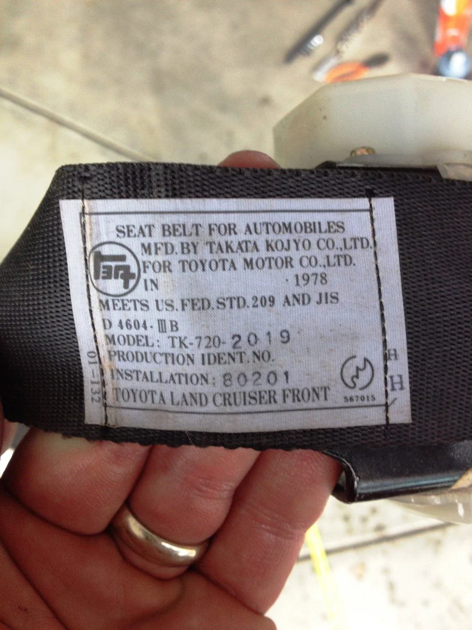

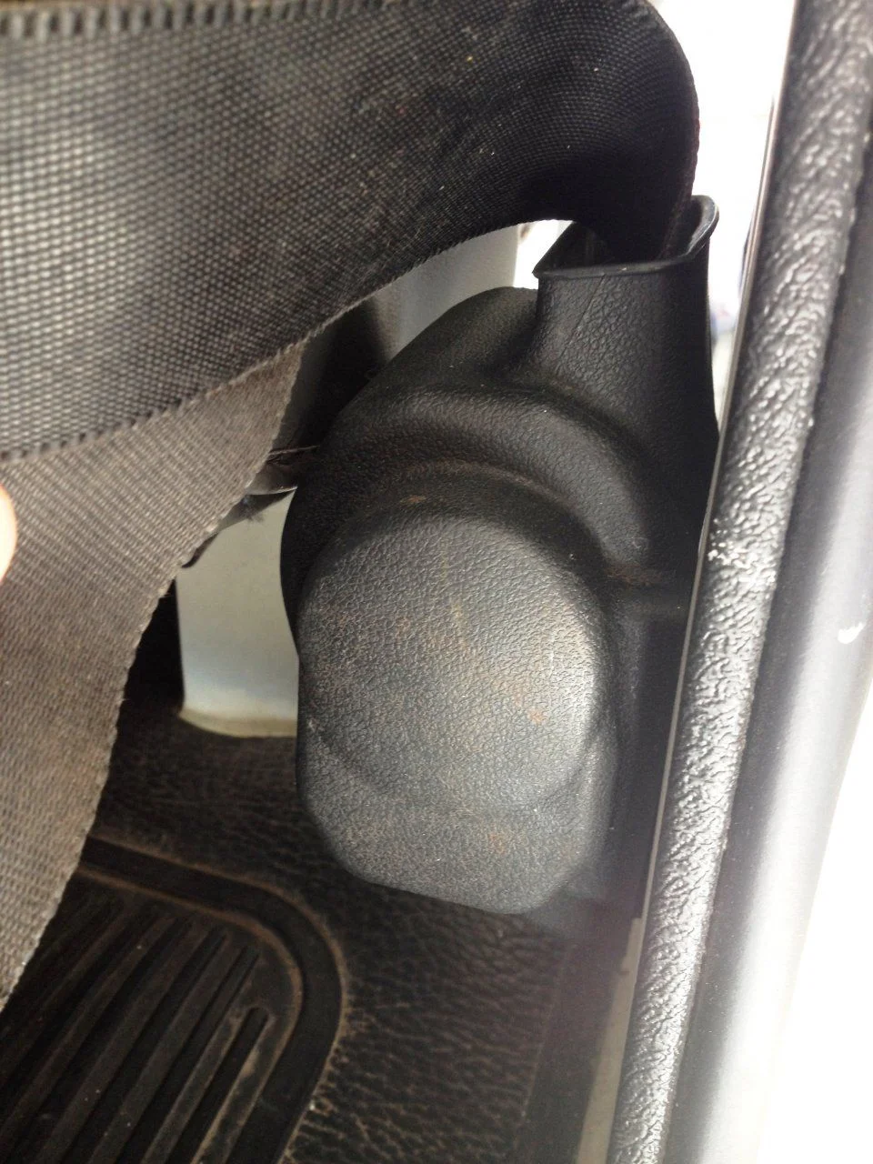

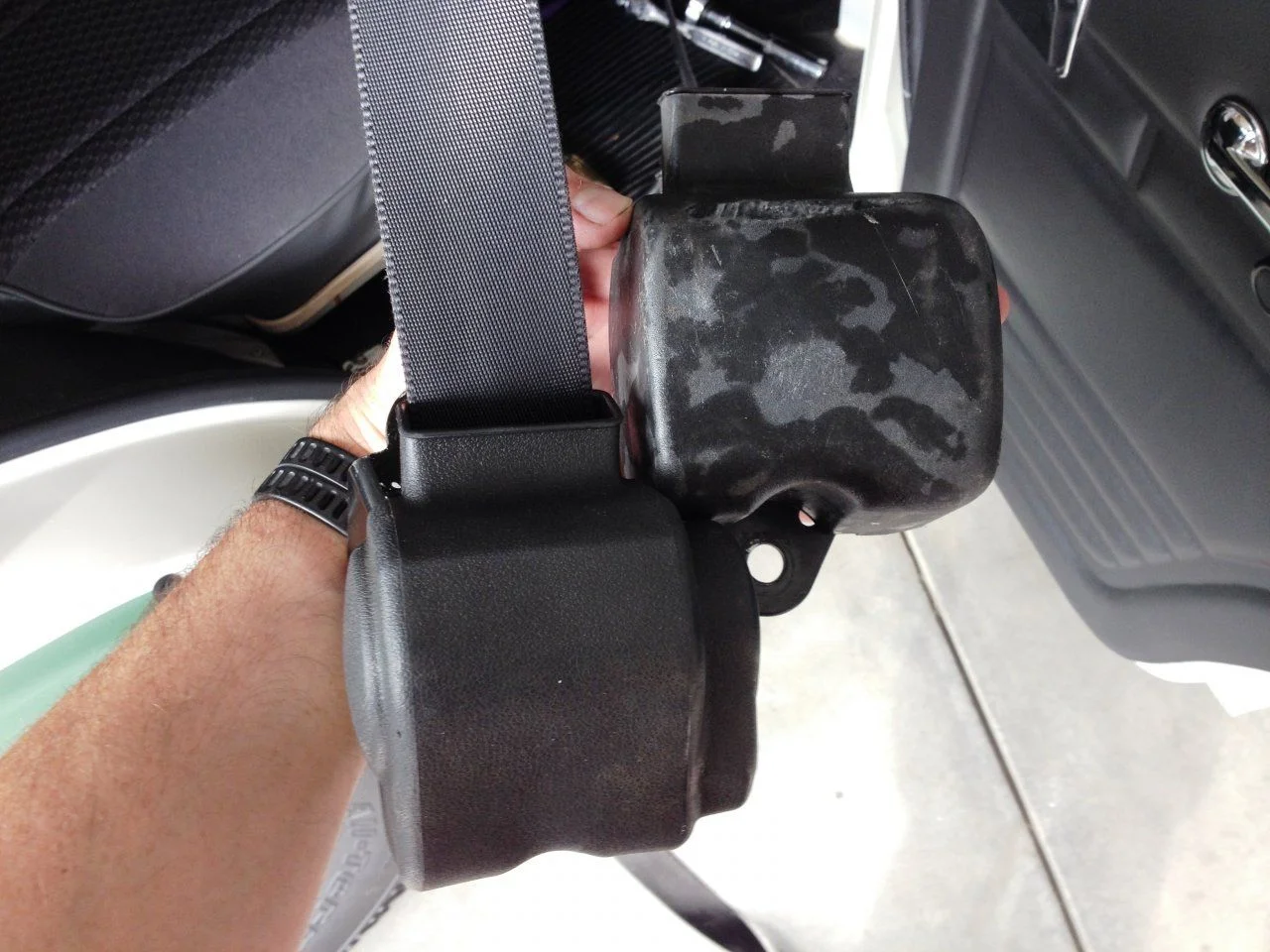

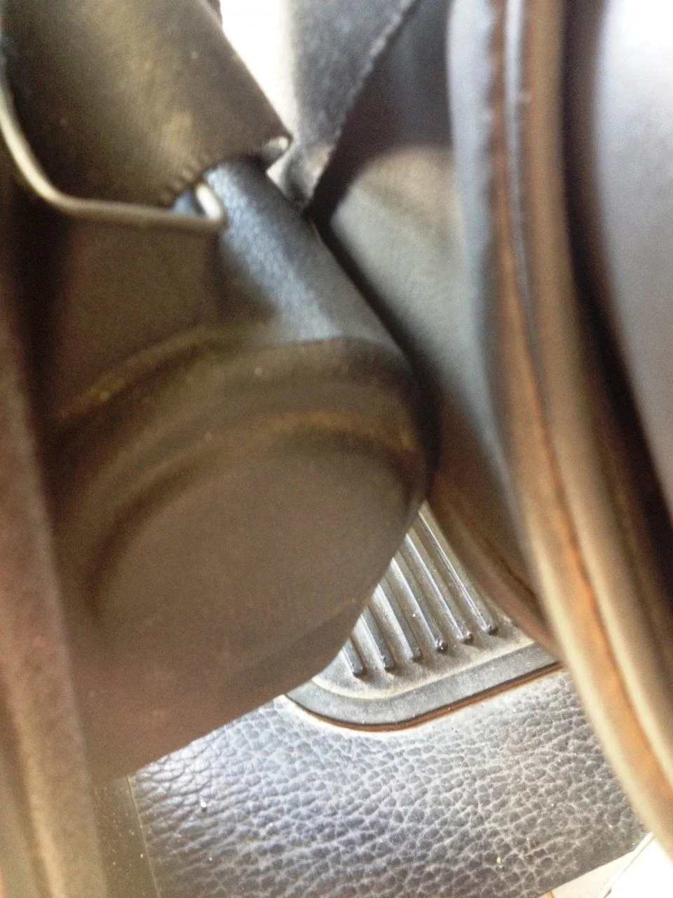

I found a set of 3 point retractable belts from a '76 Pig and started putting them in.
The retractor unit barely clears the bench seat when it is all the way back.
Both sides have the retractor on the same side - so they are not a mirror image of each other. It just looks like the retractor goes in front on driver side and in back on the passenger. These belts also have the "tongue" (part that inserts into the buckle) in different orientations. On one side the tongue points out towards the window, on the other side it points in. Go figure.
After all the fitting, the passenger side belt does not lock up when I pull on the belt suddenly. I guess the inertia mechanism doesn't work. Bummer. Driver side works well. I will ship the pass side off to Snake Oyl and see if they can fix it. Otherwise I think I will just give up and get a set of new belts.

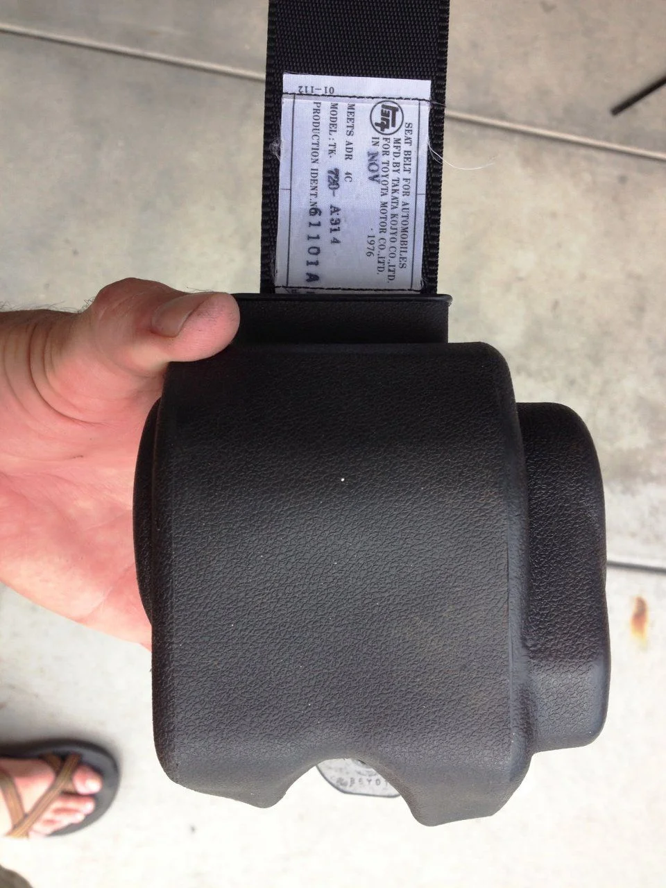

To make things more confusing, these retractors look different than some others that I had sitting around that are dated from sometime in 1978.
I looked at the belts in my buddy's 1976 Pig and he has the more "boxy" style retractor.
