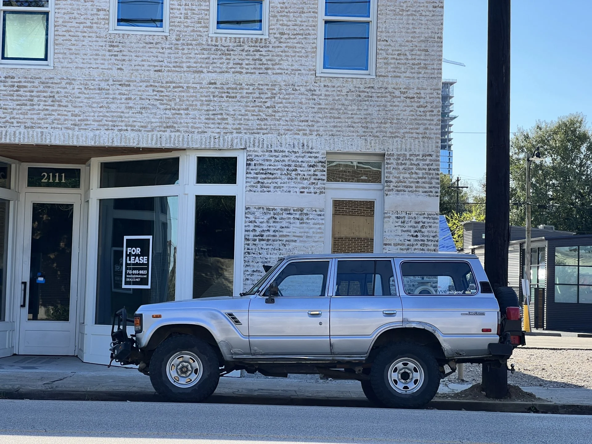

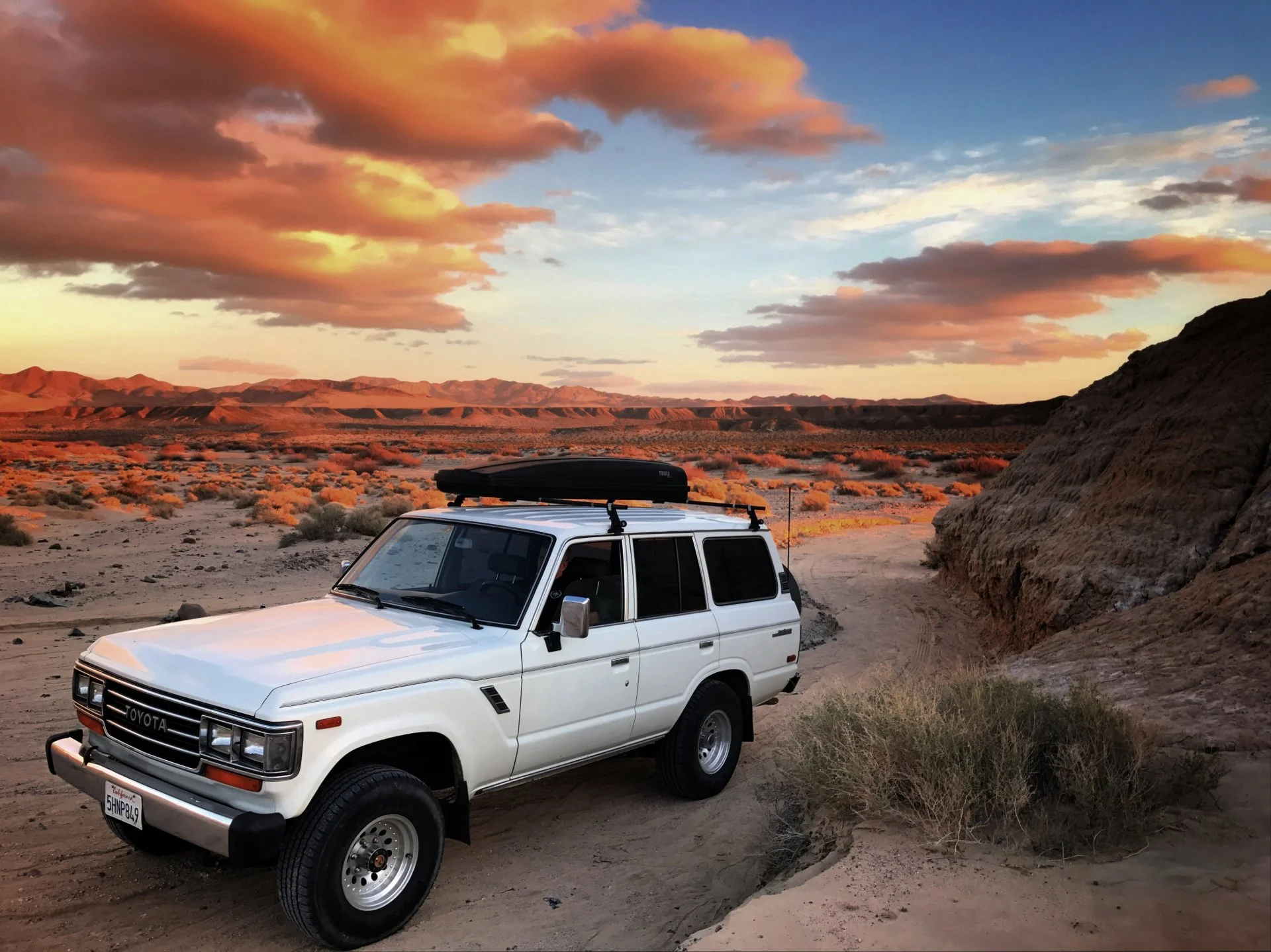

My rig needs tires, and I may update the springs while I’m at it. After purchase, I originally installed a HFS 1.5” lift with 31x10.5 Michelins. I’ve been happy with the combo, but the rear is sagging a bit even with no gear in the back. I’d consider taller lift, 2”+, but will 31” tires be too small At that point? Also, will tires larger than 31” drastically affect mileage? 10mpg is bad enough.
Photos and a description of your lift and tire size would be helpful.
Thanks!
My current setup:

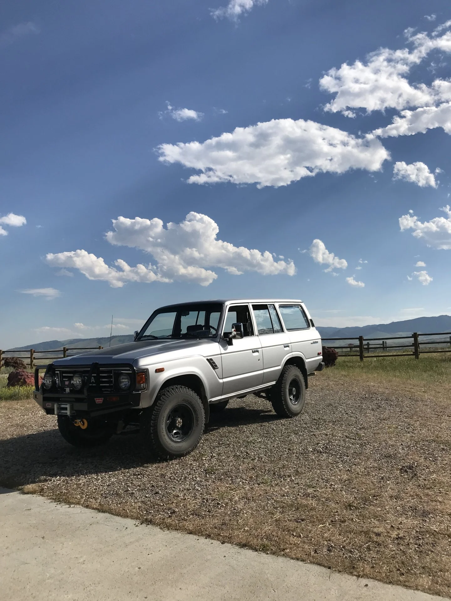

You should be getting better than 10. I get 13 city and 15 highway with a 340k desmogged 2F/h55f/3.70 gears and plenty of extra weight.

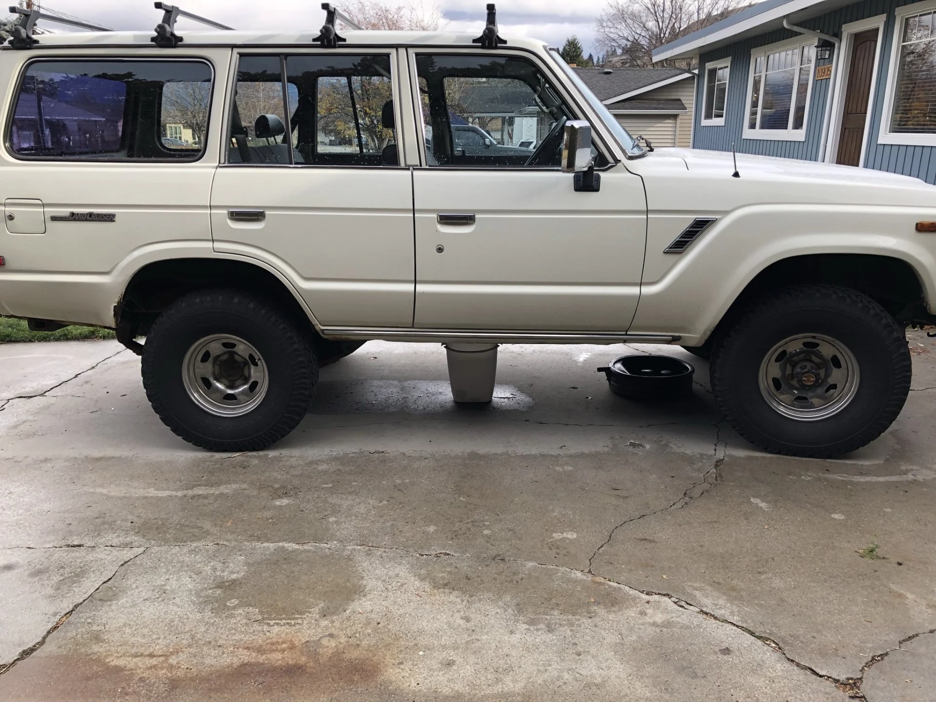

I’m on OME CS005 springs front and rear, OME shackles with Bilstein shocks. My tires are 255/85r16 or “33x9.5” equivalent in 16x6 70 series wheels. I’ve also got a 62 rear sway bar with extended sway bar end links front and rear.
Its really comfy and handles nice. The shocks make a world of difference.

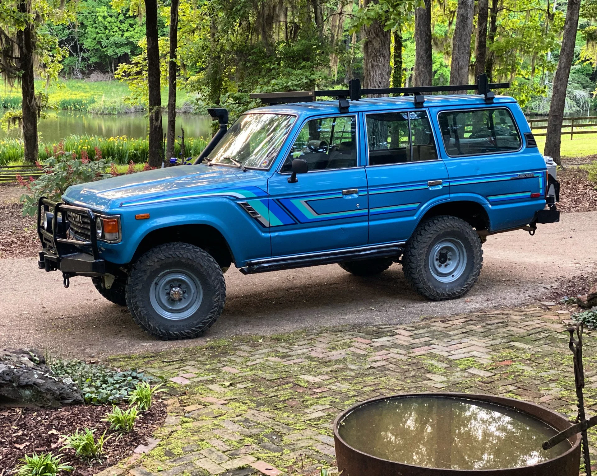

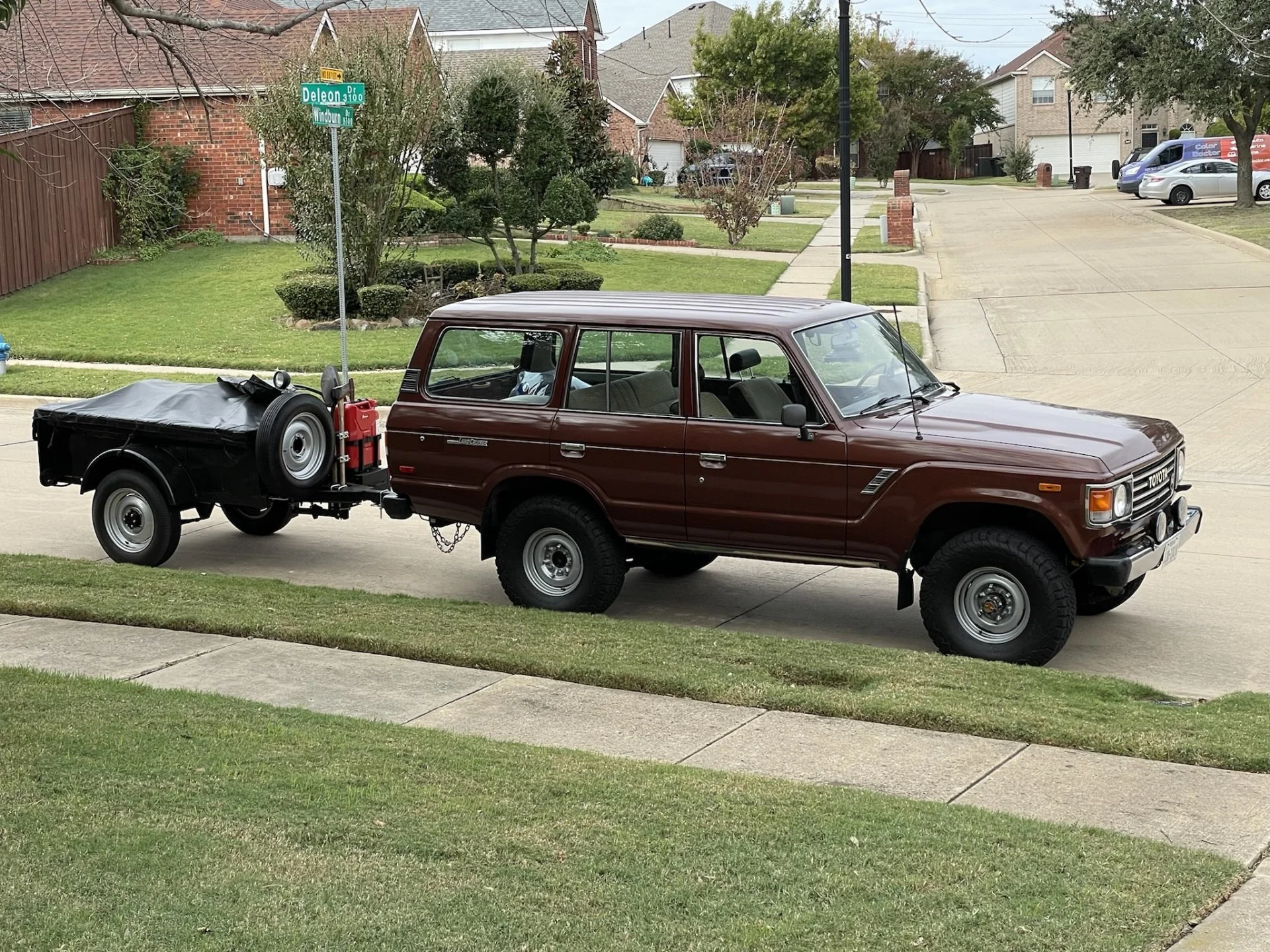

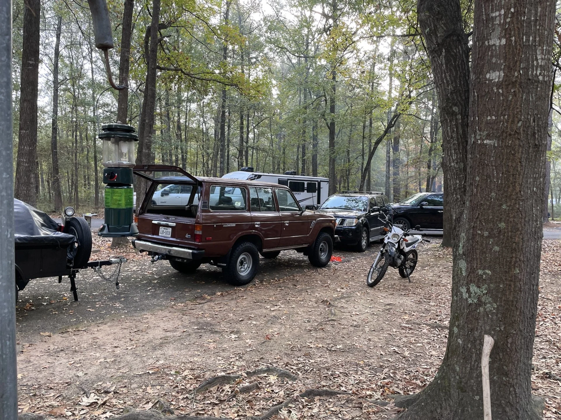

OME 2.5 Heavy Front/Med Rear BFG 33X10.5's on FJ40 Steelies. No idea on mileage. If I cared about gas mileage, a 30+YO carb'ed truck with engine tech dating back to the 1930's would be the last thing I'd drive. Spoiler Alert: It sucks. HTH.

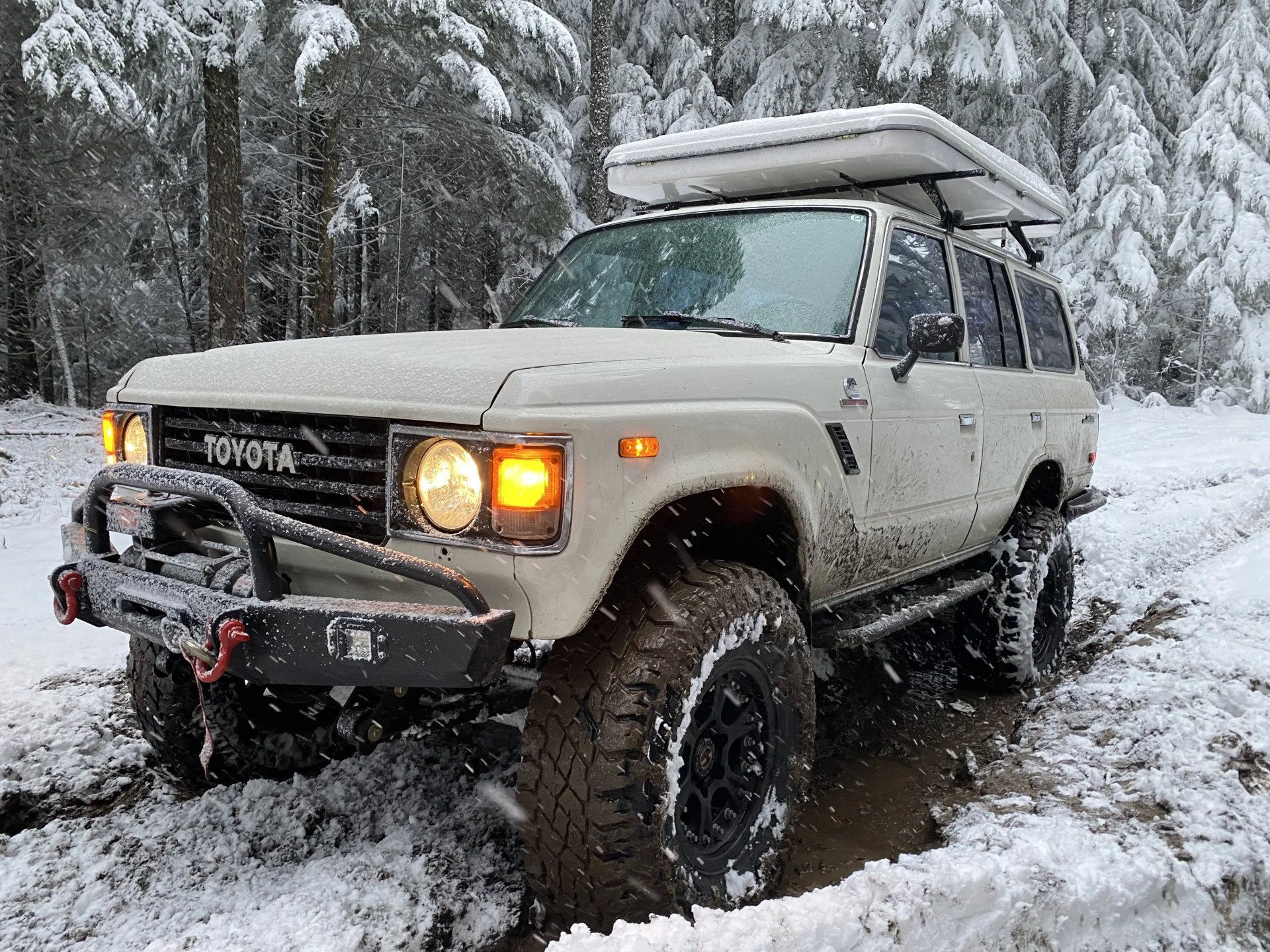

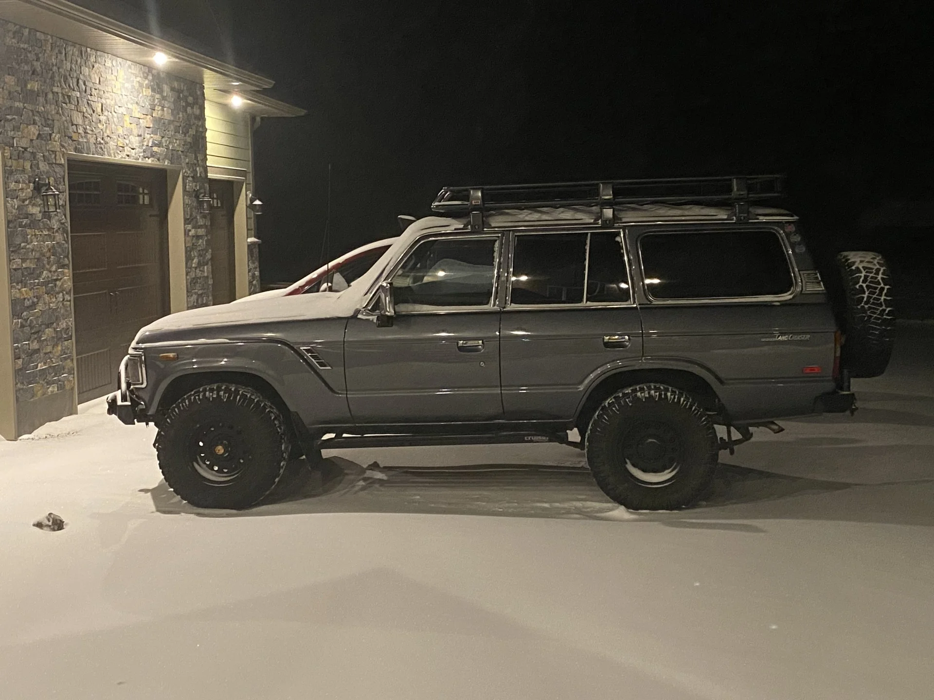

Dobinsons MRR
Can’t say enough good about these springs and shocks. Now that it’s dialed in it rides as good as my 80.
Tires 255/85-16
Yeah, I get 10-12 max mpg too
Nice rig!
Wow, yes those shocks look like they would be amazing. I bit out of my price range for now though. So your rig is essentially on a 2" lift? I couldn't see any other height options on their website. Also, your rims are 16"s? Are they FJ40s like Gretsch's? Where did you source them? You happen to know ideal rim width and backspacing?
Looks great!
I'm leaning toward black steelies though I'm not sure the actual FJ40 rims are easy to get these days. I like how they have the hubcap clips. I think I wanna go with hubcaps on mine. Do you know the specs on the rims? Width and backspacing?
Also, curious why you went with heavy front/med rear spring combo? I have a 40 gal fuel tank and rear tire carrier bumper, so I'll probably need the heavy load rear springs.

Mine are the non-riveted steelies for clearing the front calipers. Backspacing I believe on those is 3.25 and sizing is 15X5.5. These AFAIK are still readily available through any Toyota dealership (try P/N: 42601-60072 maybe). I bought mine used from a fellow mudder through the mud classifieds and had them blasted and powder coated silver.
Or try these:
As far as the lift setup, I wanted to avoid the normal silly looking stink bug rake typically associated with the OME kits. I don't have a bunch of accessories to weigh down the rear of my truck like most folks. Other than the lift and a receiver hitch its a pretty stock setup. I also have slightly extended front shackles to additionally help with any stink bug front to rear. Even with all that it still sits slightly higher in the back. Looks normal when pulling my little trailer. Its slight but I notice it. HTH.

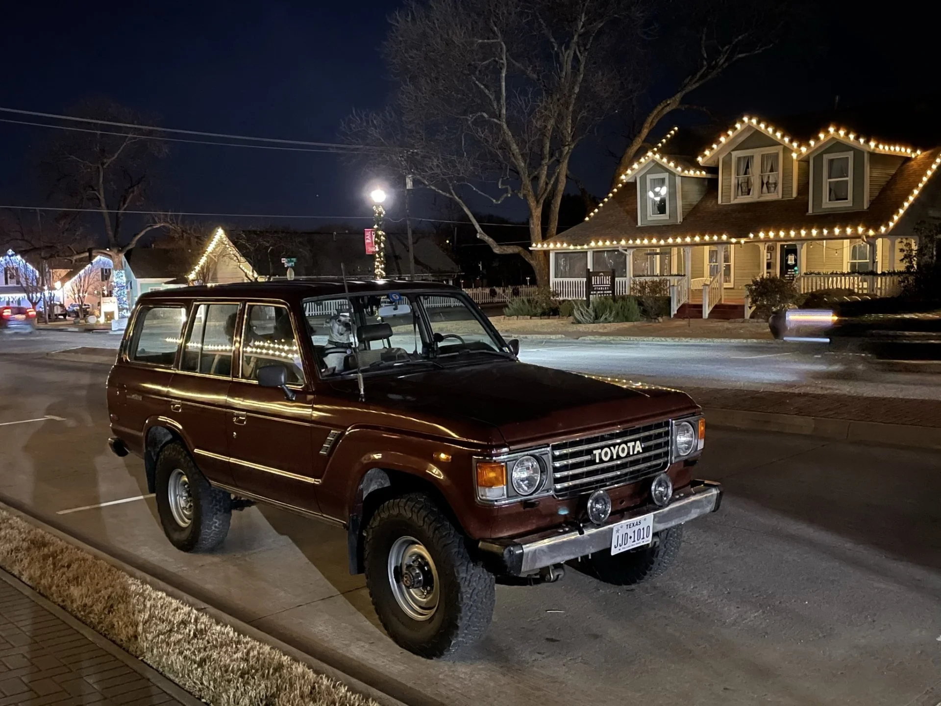

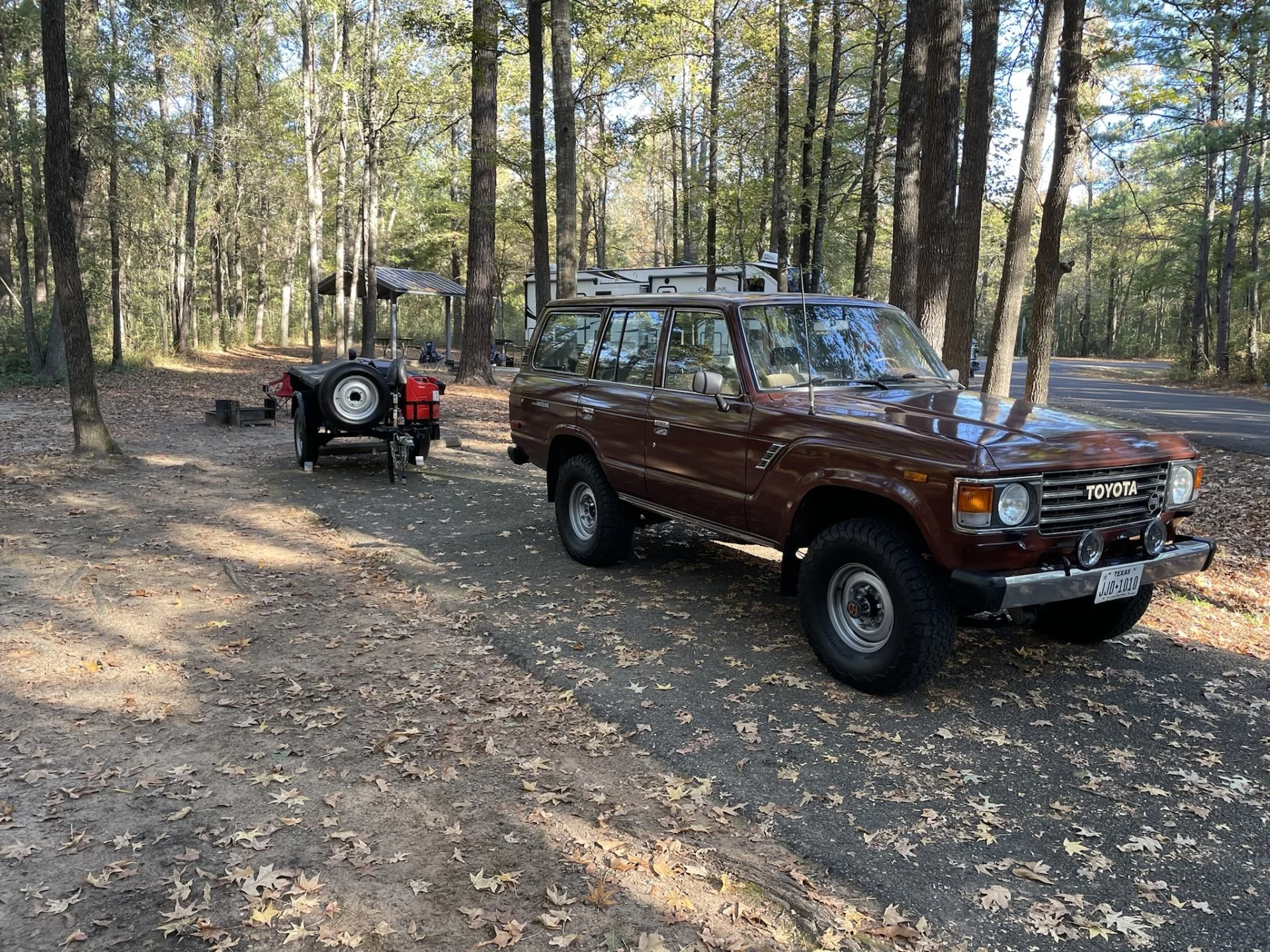

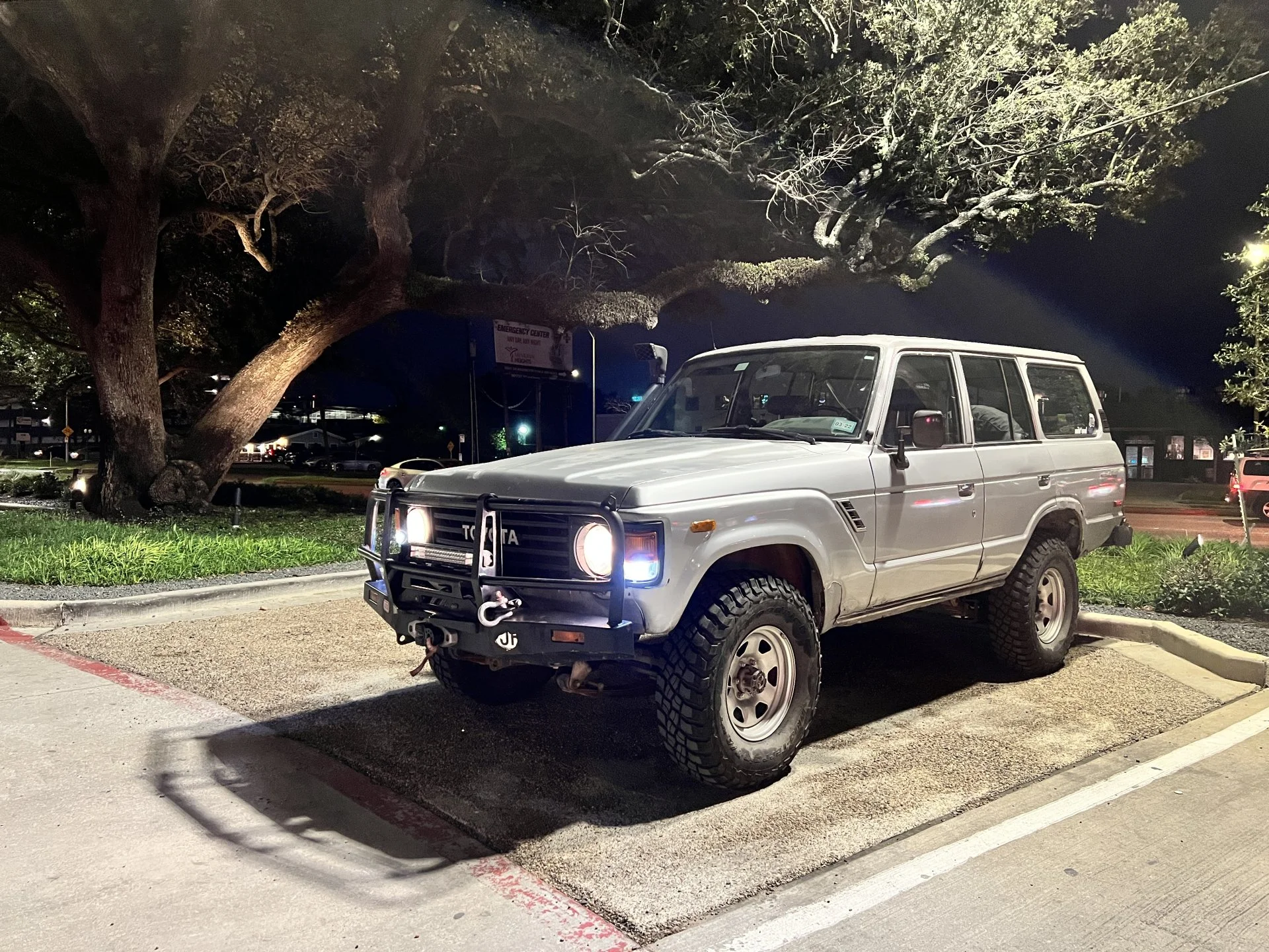

I’m on 33s” on 15” rims with a 2” OME lift.

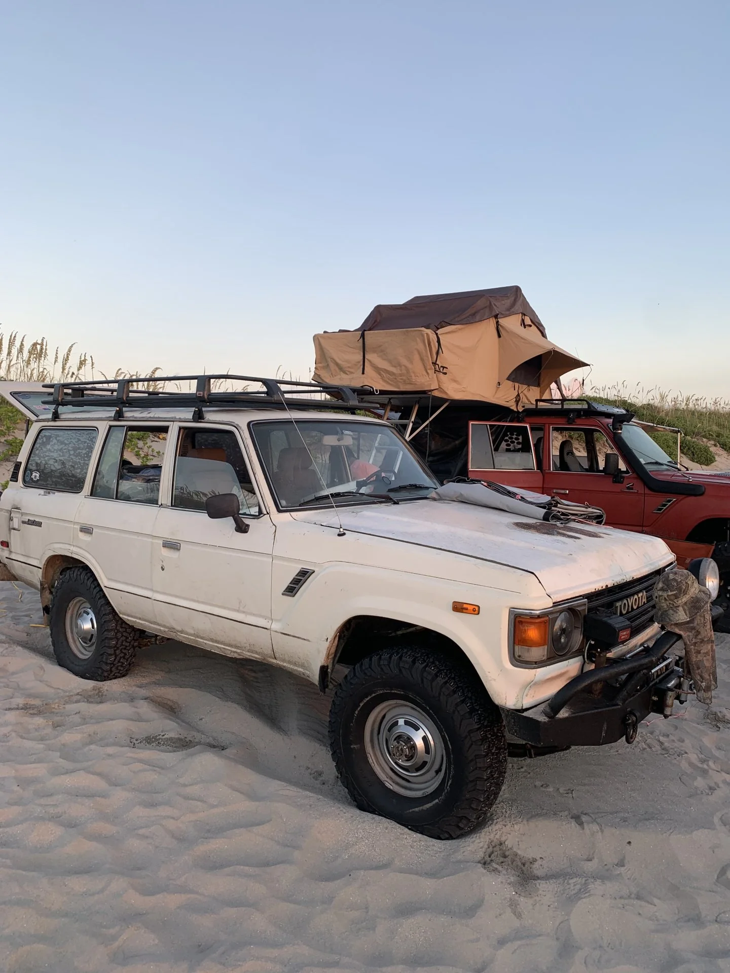

33x10.5x15 on fj40 steelies with 2” Ironman heavy lift

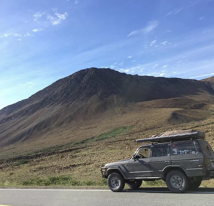

OME 2.5 heavy 255/85R16 odo 10% off
OME medium lift with BFG AT 33x10.5 on American Racing Teflon coated wheels
