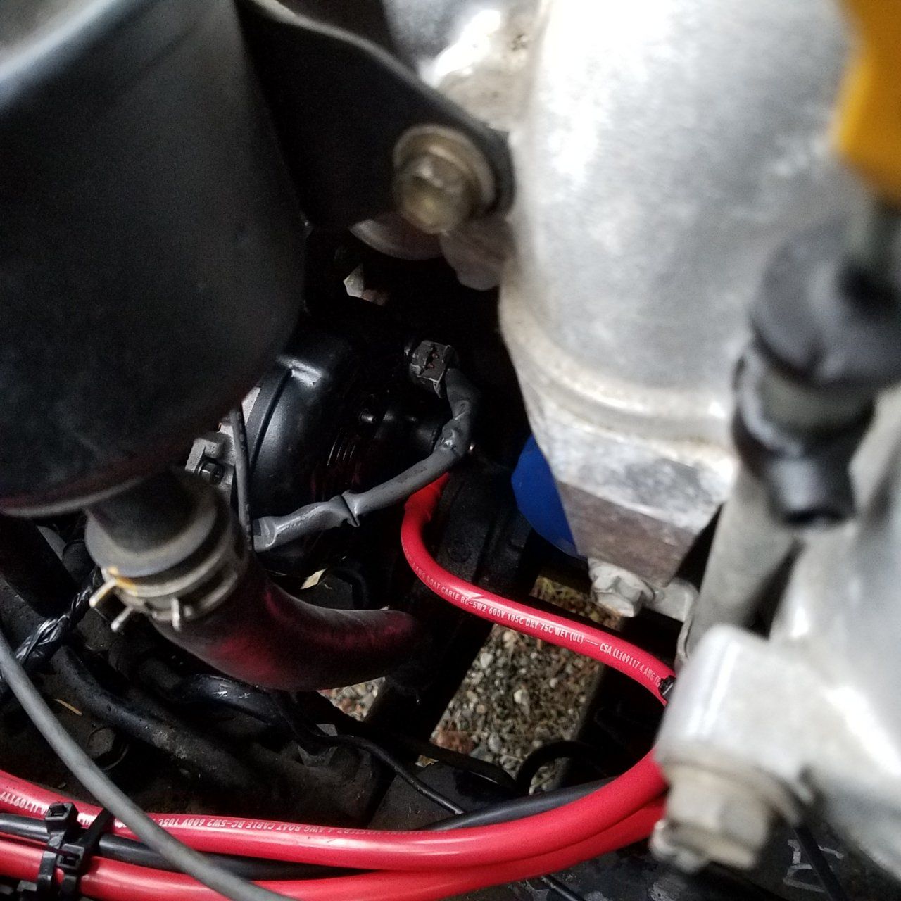

You will have to do something about the wiring as stock cannot handle the 140 amps. Might be possible to run a second higher gauge in tandem with stock but I'm not an electrical engineer and don't know. My truck is getting a 3' 4ga quality cable swapped in, I already have upgraded grounds, and a new main lead to the starter.
What do you mean the stock wiring can't handle the amps? What wiring did you Upgrade?
There main lead from the alternator to the battery.

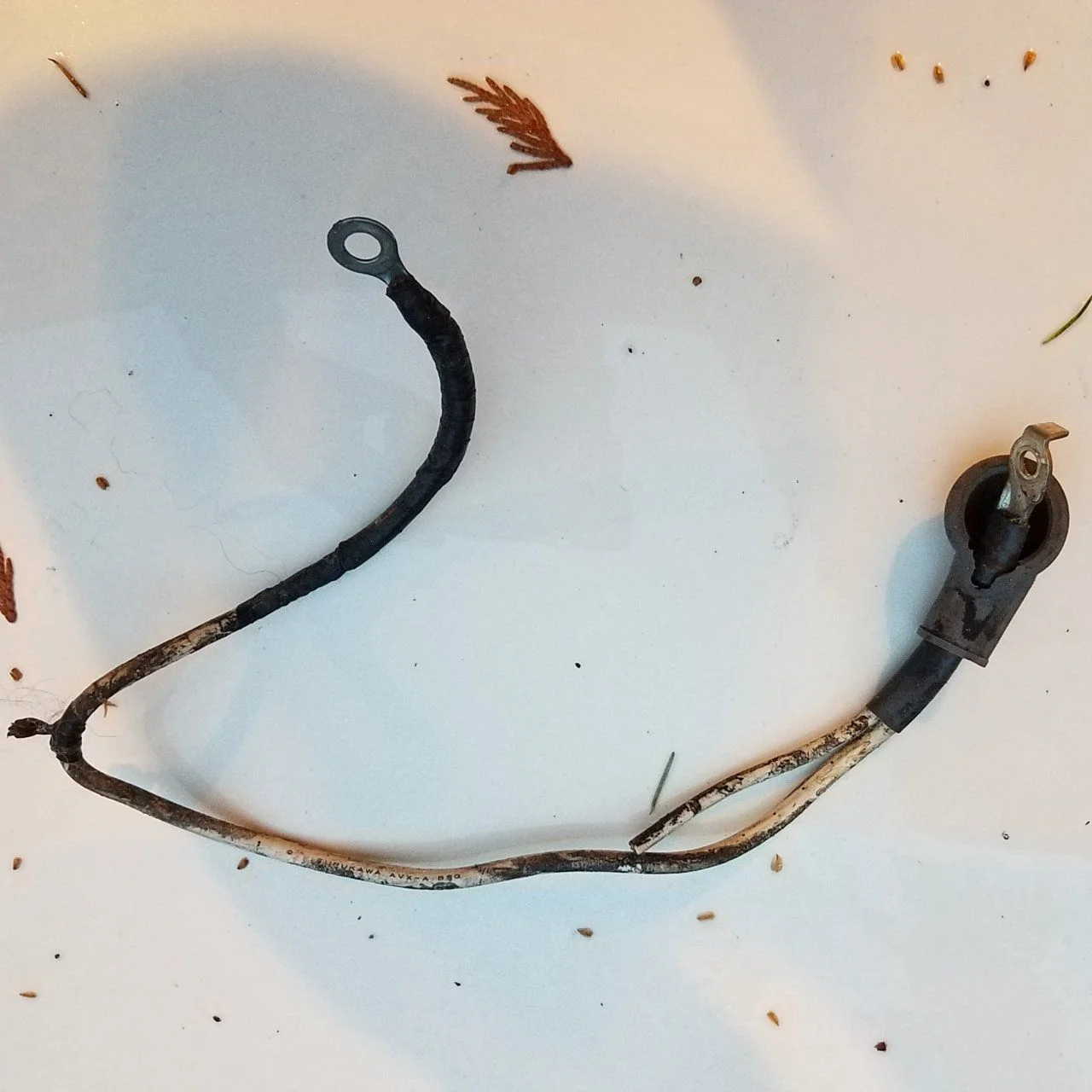

I opened the stock harness, the main lead on the alternator has 2 wires on it - 1 that leads to the battery and one that leads into the vehicle harness. I cut the wire to the battery and into the harness, and essentially connected the "vehicle" side to the battery (AM box). Ran a 4ga lead (3 ft) from the alternator to the battery. I know most won't do/like that and may want to consider a larger fusible link.
However, 4ga should only be used at an alternator with this amperage at no more than 5 ft, or at least according to the chart used at the battery shop.

If you're talking about the charge cable then 4awg is fine. But I thought it was 4awg already. No?
I haven't opened the loom on it (yet) but reached down there and it sure feels like there's 4awg in there, along with a couple smaller primary wires.
Went rootin' through the garbage, in the rain for ya.
It's typical for Toyota to either do this or split it within a foot of the alternator connector.
In the photo the connector on the right goes to the alternator, and on the left to the black box just before the battery (I think it's the AM connector... or at least that's what toyota calls that fuse on other toyotas). From the box to the battery is the stock fusible link (I personally bypassed it).
The cut wire was instead cut at the length so I cold put a terminal on it, connect it to the black box just before the battery, and wrap the stock wiring back up.
Theven primary wire appears to be 6 if not 8awg. I will, however, admit that the 2nd wire might be able to absorb some of the amperage and in tandem act as a higher gauge wire, but again - not an electrical engineer and unsure if it suffices.
4awg up to but no more than 5ft was the recommendation from alt to battery. I had mine made at 3ft.
