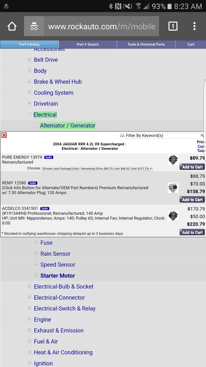

Possible bolt in 140-145a alternator
2w93-10300-ab
Pretty sure this is the part number
That's because I was being nice and doing the research for a part number at Rockauto for you, the part number is an ACDELCO reman unit, original manufacturer is ND.
So it's a Denso rebuilt by AC Delco? Thanks.
Too bad it won't fit in a 3FE...
