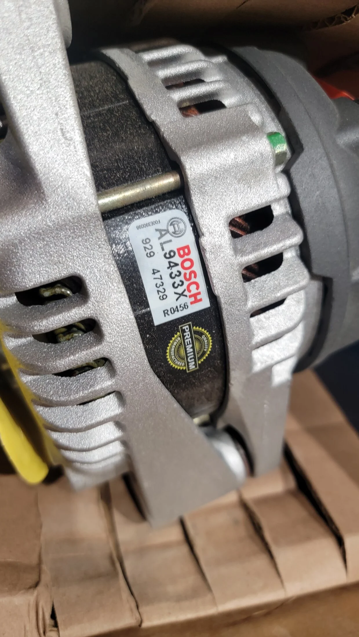

Sorry to revive this, but it seems like the jag battery is still the best route considering the non-existent tundra/seqouia bracket.
To add something, Rock Auto has a Bosch reman battery for the 03 XKR (al9433x) that supposedly pushes 220a. I confirmed this by looking up the pn on Bosch's site. I just ordered one, I'll report back when i get it on and can amp clamp it.

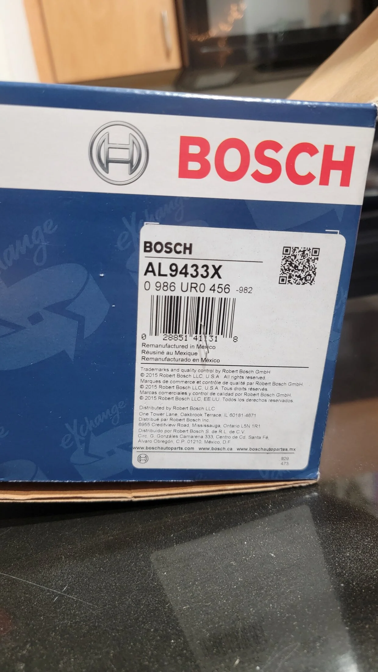

@Tam4511 - Did you receive your AL9433X from Rock Auto? I signed up for notifications and ordered one when it came in stock, just got "it" today. The box is "correct" (labeled AL9433X), but it's an AL1290X (90A, different case), so it's going back... (never done a return to Rock Auto before, ah, good, turns out returns are free for a mis-boxed item). Make sure you check yours before the return period is over!
Good call, I just checked mine and it looks to be right.
Did you ever test if that AL9433X will fit?
