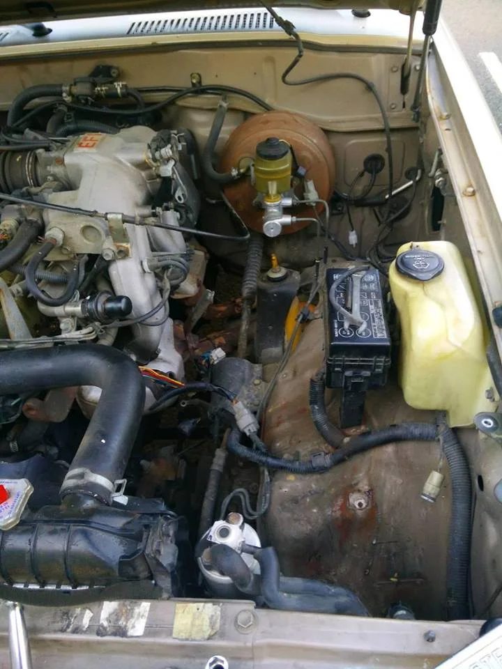

Went ahead and deleted the EGR, Smog Pump, and Friends. This frees up plenty of space for a second battery, which I'll install later.
Fender Space:
Wit's End Keychain (via @NLXTACY) Mounted where the EGR was.
