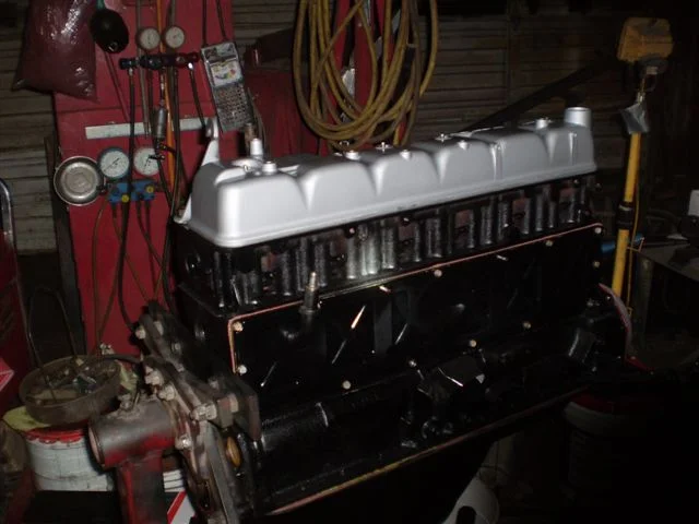

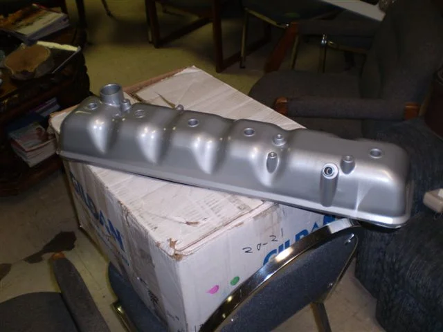

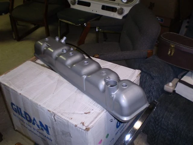

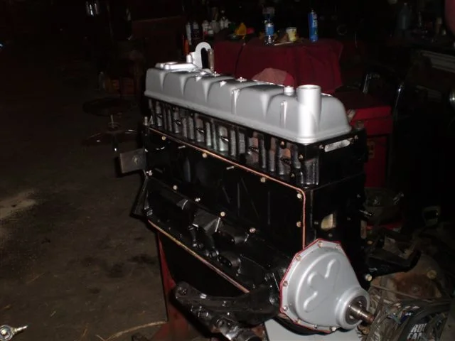

Had to run down to the shop, shot some pix.......The last one is sitting next to a polished one, I have 4 or 5 hrs in it, about 30 minutes in the painted one.......

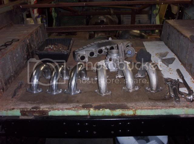

My efforts on the engine i'm fitting to my 40. This took about a week and a half of late nights
parts before
After. Still needs a bit of work. Few spots i'm not happy with but i'm waiting until the engine is rebuilt and ready to go back in.
