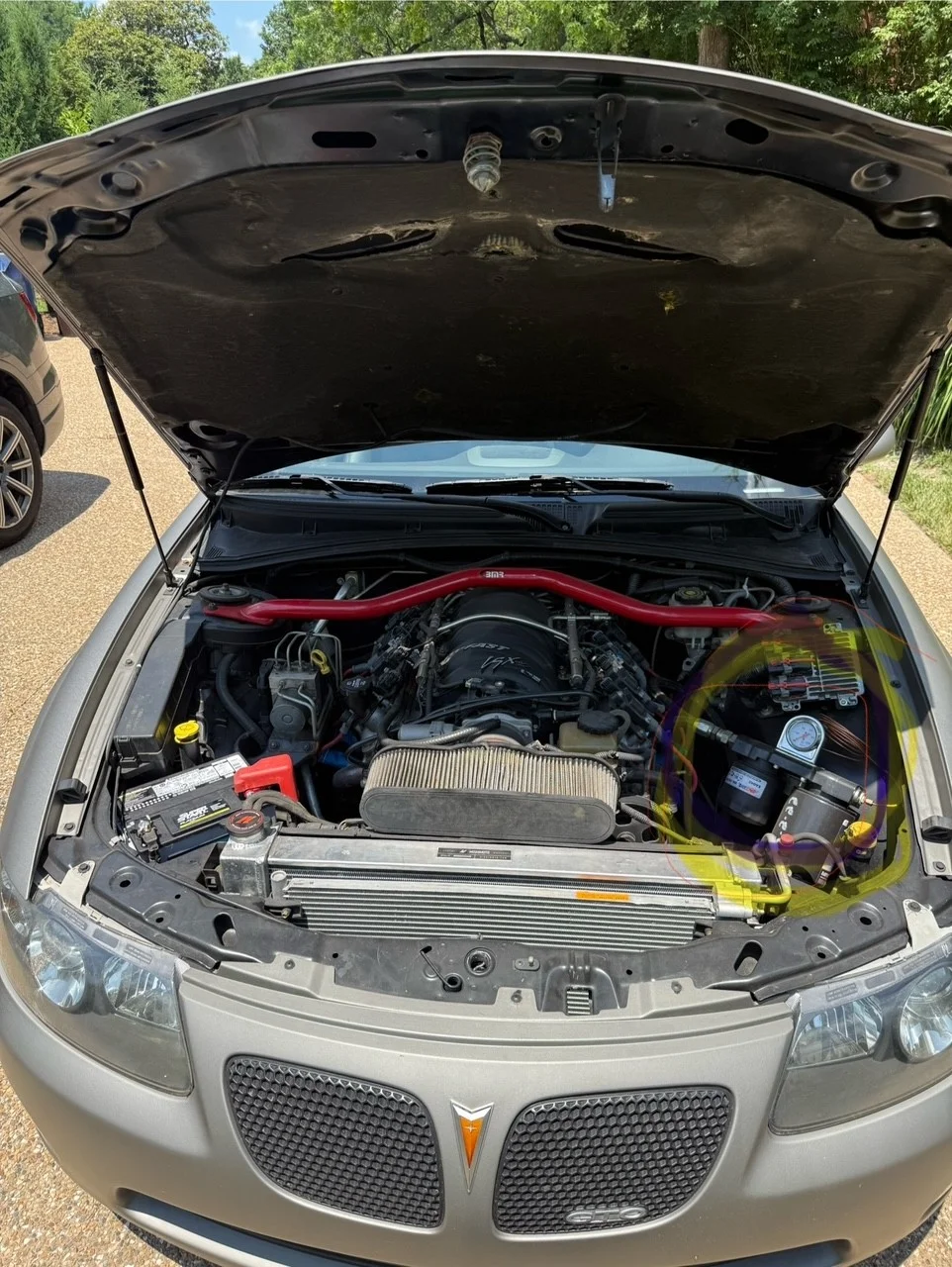

On almost all of my builds I install a dual remote filter setup. Here is why: Bearing clearances range from .0025 to .0035 on most builds. this is a good rule of thumb for crank mains and rods, cam bearings, and Piston to cylinder tolerances tend to be in that same range. The OEM oil filter is a "full flow' type, meaning that when the demand from the oiling system exceeds what the filter can pass (Volume, but measured as pressure differential) a check valve opens and unfiltered oil is circulated through the engine. Most commercially available oil filters are about 85% efficient @ 30 microns. (That's while the check valve is closed). a 30 micron particle is about .0012. Particles of this size that clump together can become embedded in engine bearings and around piston ring lands. Particles like this are also hard on engine oil pumps, and will gradually degrade the pump's performance.
The setup I use relocates the filters to a remote location. On our diesel pickups we put them on the outside of the frame rail. On my hot rod builds, I usually mount them on the inner fender - I have attached a photo of the setup on my GTO. The small filter is a high quality full flow filter with a check valve and the larger filter is a dense media type that has a rating of 99% efficient @ 2 microns. The output of the oil pump is restricted by an orifice at the inlet of that filter, such that 10% of the oil stream is continuously filtered at all times. This setup ensures that my engines are circulating the cleanest oil possible. As a bonus, this setup adds about 2 - 2 1/2 quarts of oil to the system.
We change the small filter every 10,000 miles, and add makeup oil. We also take an oil sample at that time. We monitor wear metals, contaminants, and oil additive elements. We also watch viscosity, fuel dilution, and in the diesels soot.
The hoses we use are air brake hoses designed for commercial and industrial trucks. We have never had one fail.
