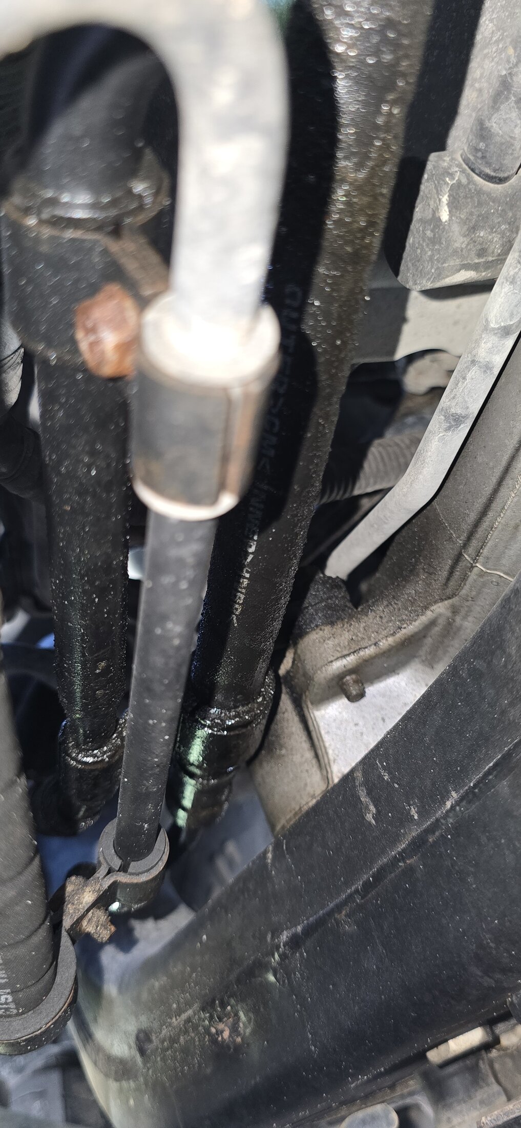

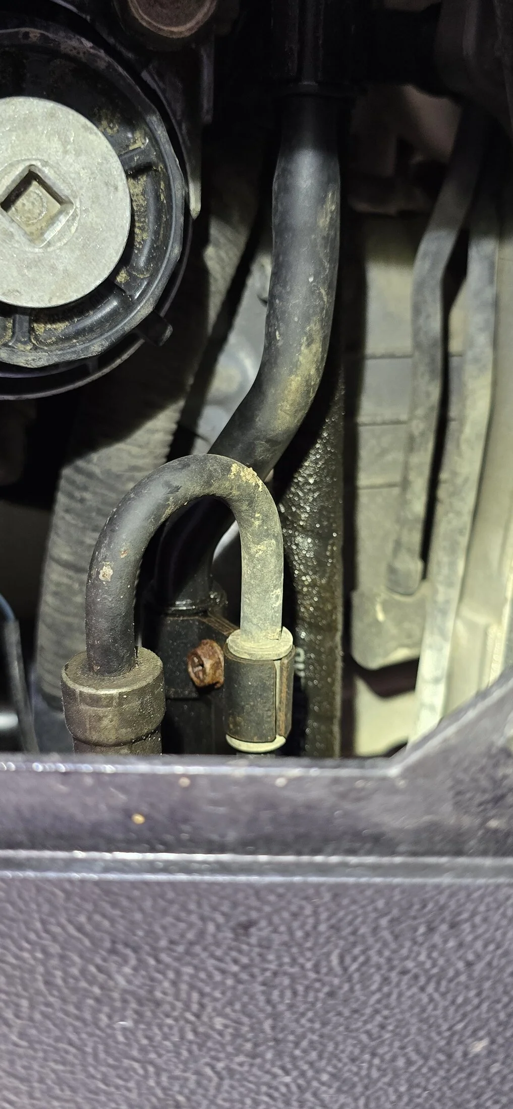

Hey all, I've tried pulling up coolant and oil line diagrams but cannot figure out what this leaking line is down near the oil filter. Can someone assist?
View attachment 3850081 View attachment 3850082
That line is for the power steering. Are you sure the leak isn't coming from above that? At least one user here has had to replace that line from a legitimate PS fluid leak at one of the crimps, but many more of us have slow oil leaks from the top outer edges of the front timing chain cover that end up all over that line.

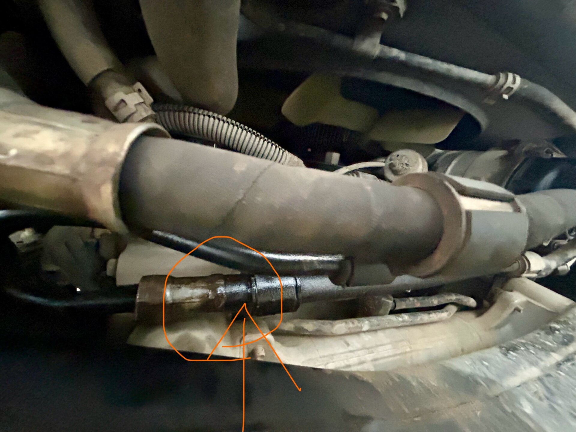

Mine started sweating there, then it gave away started leaving a puddle. Steering rack was bad.

I'm not seeing a leak anywhere else looking from the engine bay and from below. It also looks like there is some spray taking place to the right of the line on my last photo.
Looks like a weep coming from the high-pressure power steering line. I delt with this a couple years back. It developed slowly and I replaced it at my convenience and just monitored the fluid level. The residue you see on the rack is more then likely power steering fluid from the line being blown back by the cooling fan. Or could be a different fluid as these 5.7's love to weep, seep, leak as they age. The part is expensive from the dealer.
