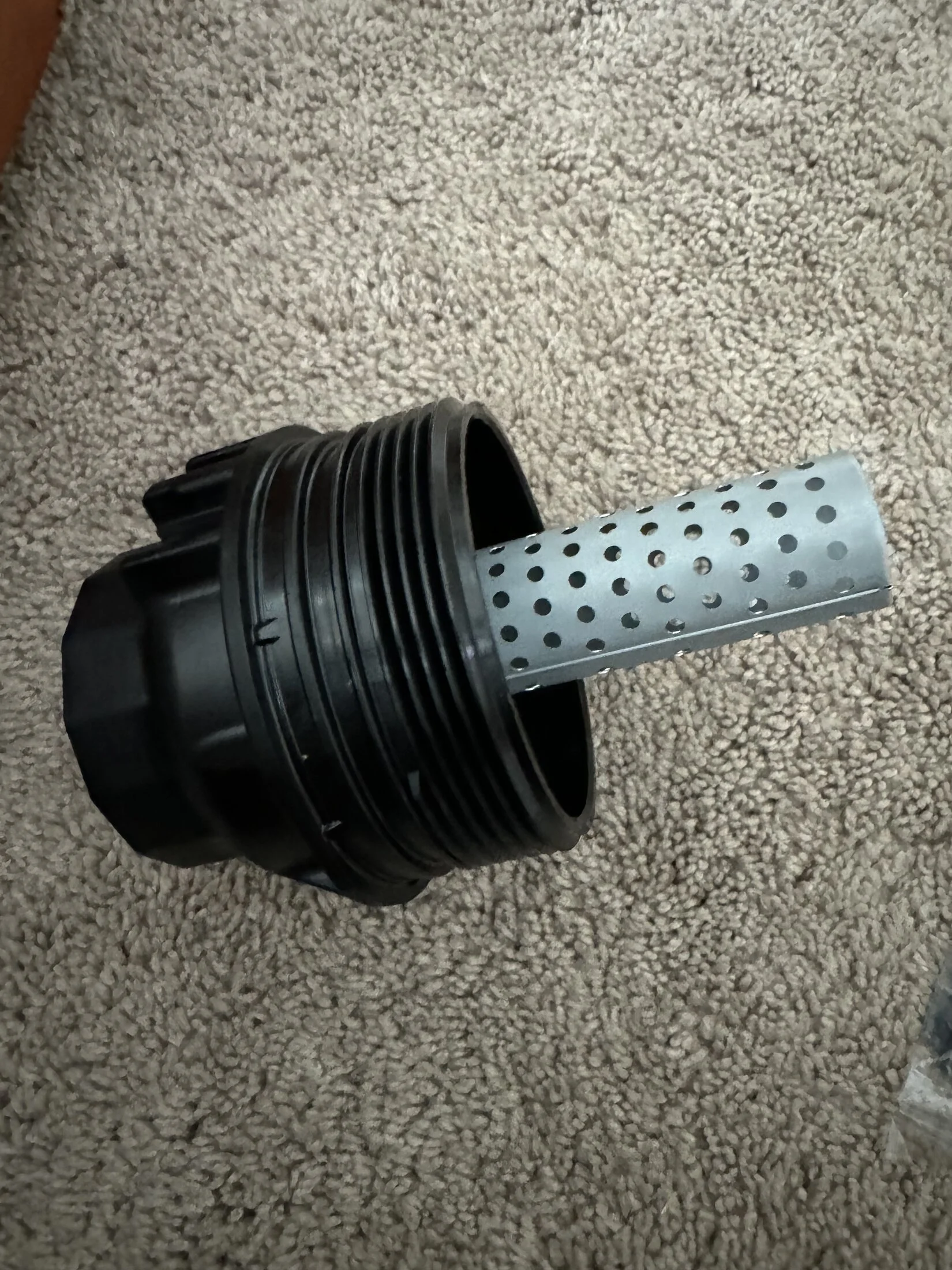

As for the bypass, the Car Care Nut is wrong with his explanation, and I wish he would update the video. The coil spring has nothing to do with the bypass. It does two things, allows for some variance in oil filter height, and allows the drain flap to operate. The bypass valve is located in the base of the perforated tube, and is difficult to mess with.
Not only that, with a decent understanding of hydraulics the filter pushing up into the housing can't be a pressure relief valve in the first place. I've been skeptical of that claim since his first video warning against disturbing that spring.

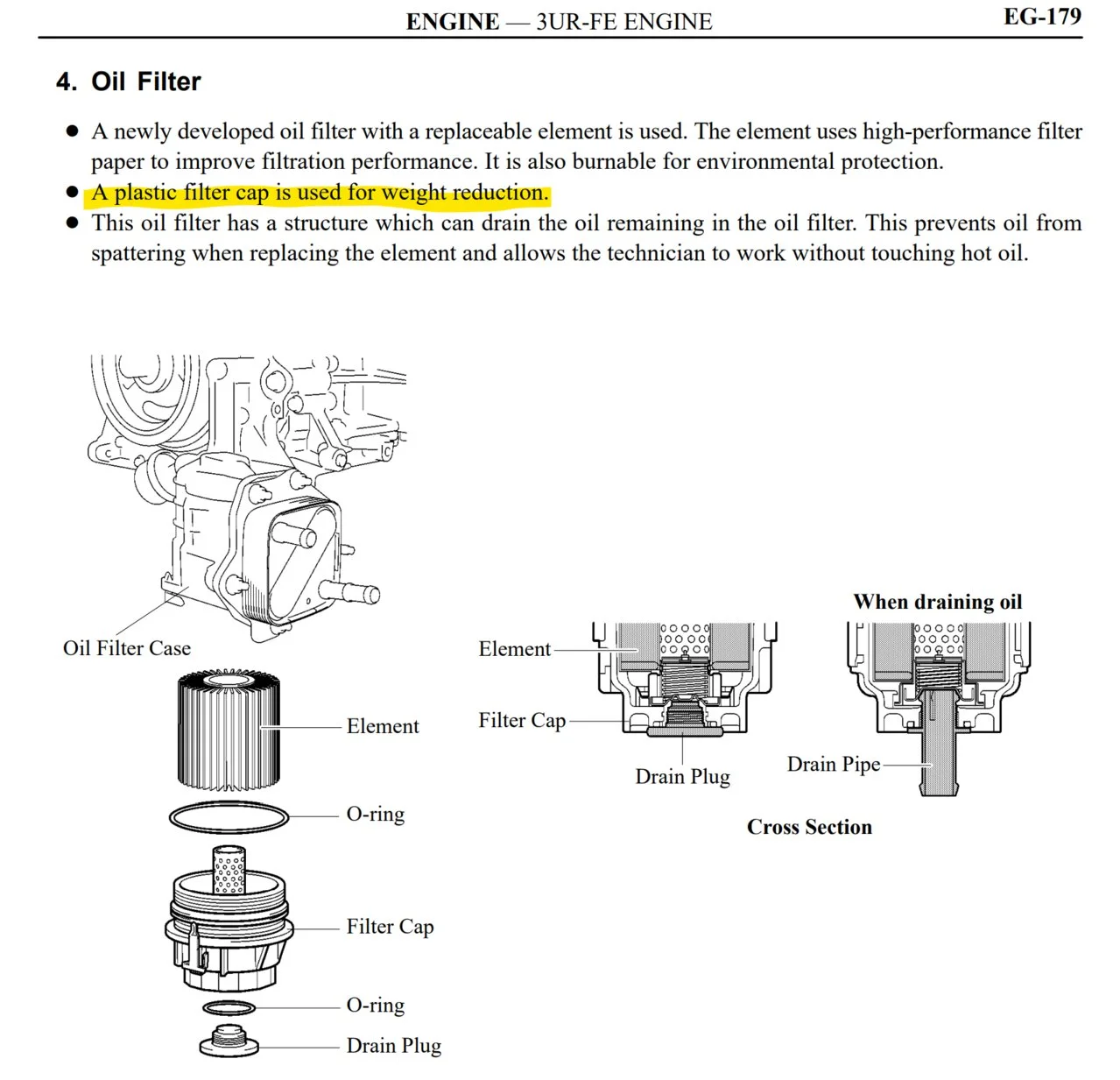

My remaining question going aluminum/light alloy and looking at the thread cross section drawing;
Can it scratch the female O-ring seal area over multiple filter changes?
While the O-ring elastomer will conform to some surface imperfections, that is something to consider.
~20 oil changes for me so far with an aluminum cap and no hint of issues in this area. With the design being as it is (the external threads are mildly rounded) and the way most people seem to do their oil changes, I suspect you'd basically have to be trying to do damage for it to actually happen. Now if the cap were made of carbide or something.. Fortunately it's not.
And I can confirm VWAG and MB vehicles from the mid 00s use plastic cap as well, though both have a different o-ring format. It's more like an elliptical cross section and seals against a V area in the housing. I'm not entirely sure why they did this but think it may be to reduce spillage from the thread area past the o-ring when the cap is loosened the remaining way, as ours do.
