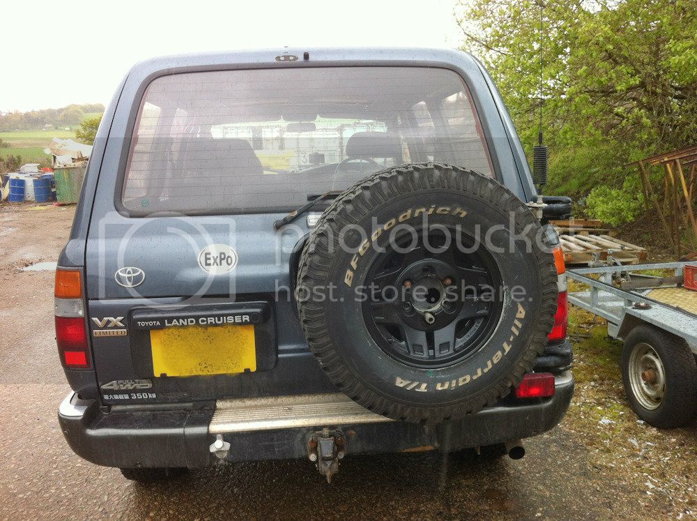

I assume that everyone talking about 'rated' weights and load limits has their towing points inspected annually on a 15 to 20 year old vehicle and has them certified as being still within spec?
Thought not.
That hitch point will do the job but you need to accept responsibility for the possible outcomes if it isn't up to the job for whatever reason, deterioration, excess weight towed, faulty fasteners or whatever.
I'm happy that it will do the jobs I require of it but I'd take that hitch off if I sold it and let prospective buyers make their own decision.

I've been welding around and on pintle hitches on work trucks most of my life. I've laid under the back of my 80 and looked at the crossmember for quite a while analyzing how it's built. There's no way I would tow anything over 3-4000 lbs without doing some beefing up behind the crossmember. A piece of 4" channel and an hour of cutting and welding might save somone's life. Towing that cigarette boat posted above on a stock crossmember is bordering on criminal. If that trailer gets away, somebody's wife or child is likely to die, and I know I wouldn't be able to live with that.
