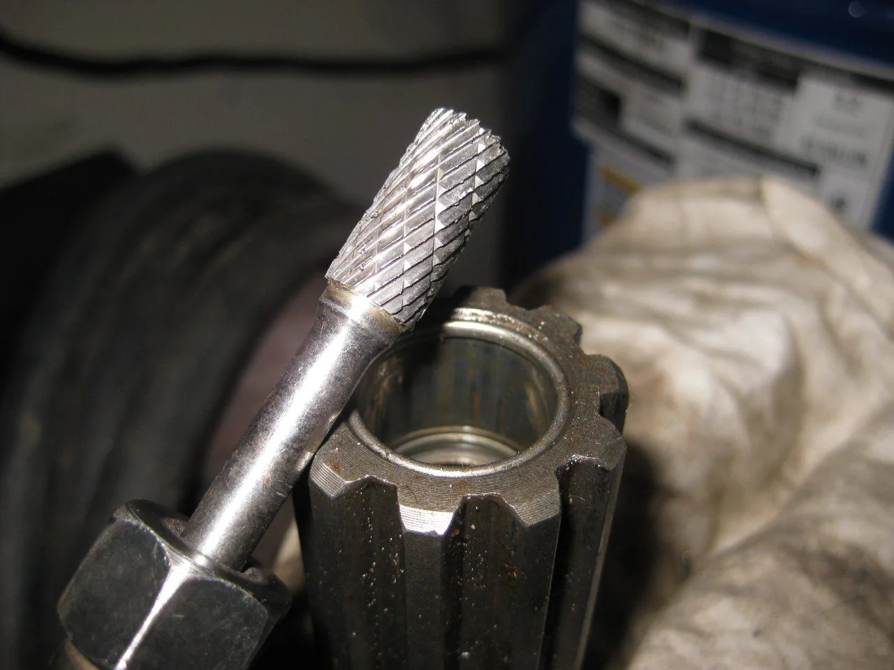

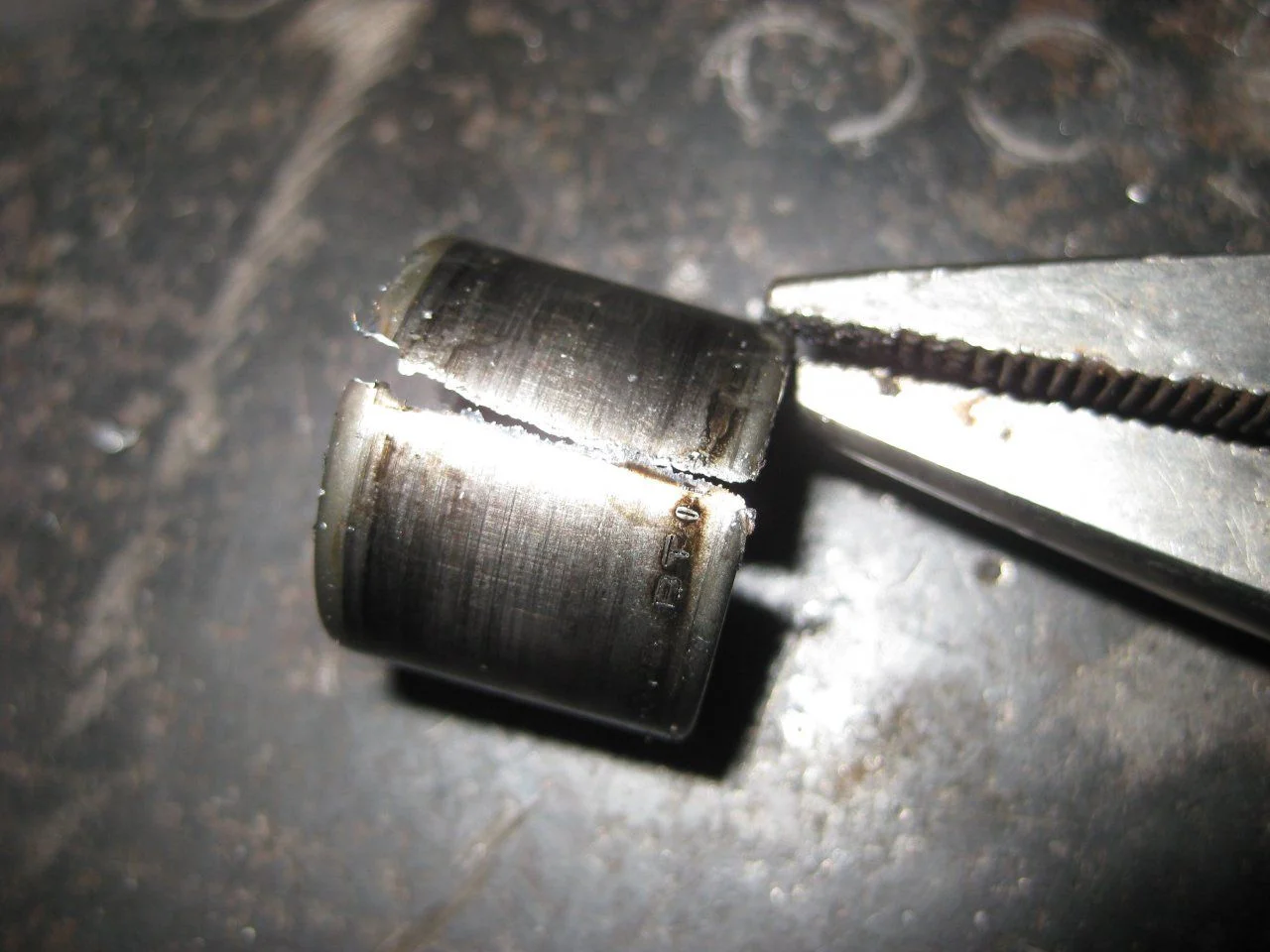

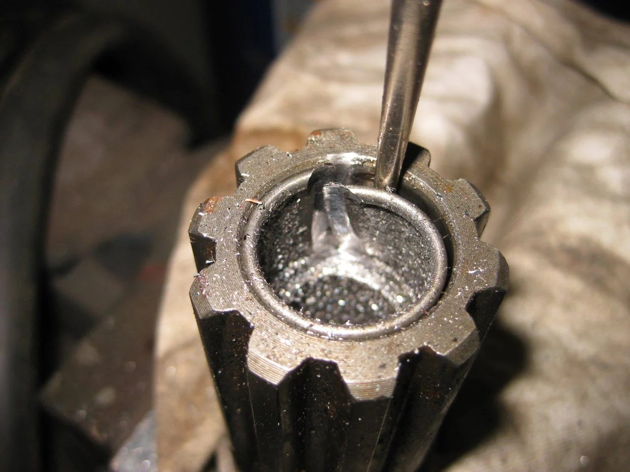

Yikes! no good. I'm guessing the outer race does not have enough of a lip for a puller to attach and grab onto right? I'd consider a die grinder with a carbide burr and then carefully split the bearing. Run it at a very high speed and go slow. I use one to split an internal bearing in the transfer case and I've done it many times. Something like this...

The bad news though, if your pilot bearing failed and you drove the truck for any amount of time, the input bearing in your transmission is also very likely damaged. Without the pilot bearing in place, the input shaft is able to "walk" around and place load on the transmission input bearing. It will wear it out FAST. Here's one more pic of what I mean by "splitting" the bearing. Once you cut and weaken it, you should be able to get it out pretty easily.
