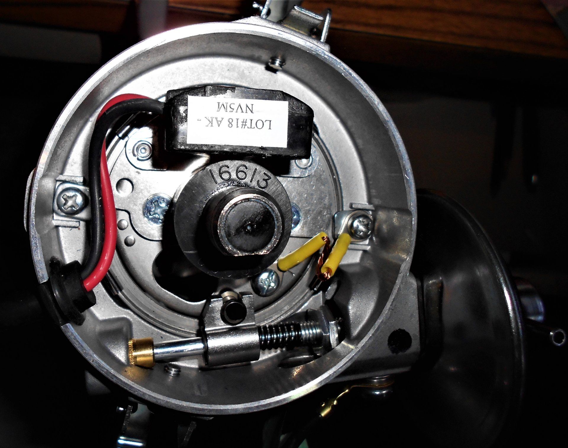

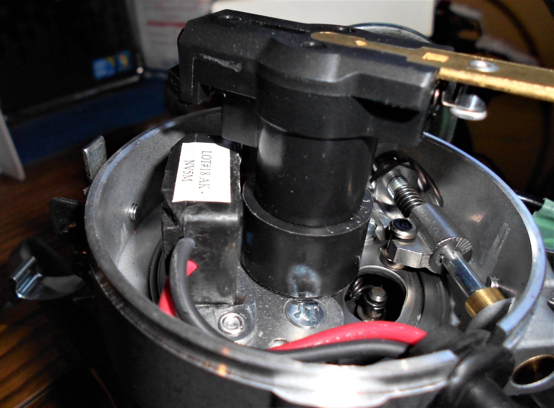

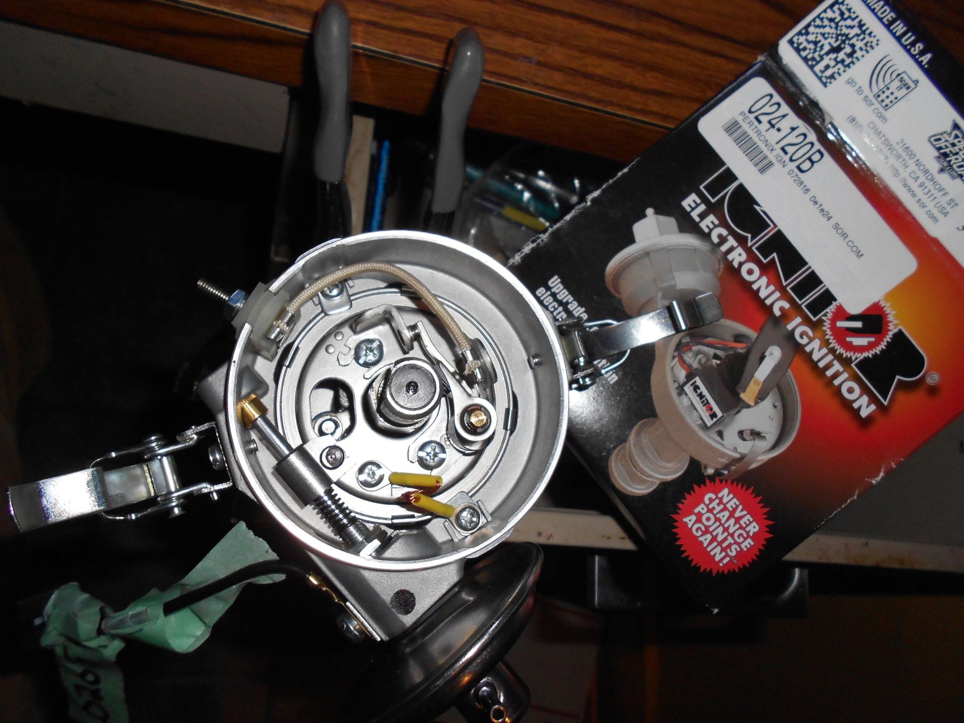

Hey Brice ,
I have been slowly but steadily tweaking My complete new F & 2F ignition system installs past few years both on my own trucks & Client shop jobs , here's the latest set up I go with & why :
- OEM toyota Plugs & wires & coil wire ( Reliable Fit , finish & long term performance )
- OEM toyota Internal Ballast Resister Coil W/ bracket ( Reliable Fit , finish & long term performance , ballast inside lives forever , unlike external ones , the bracket will mount on a 2F cylinder head upside down to migrate any water off stay dry and is hovering right over the distributor cap )
- @Racer65 Med Cap anti-over REV Distributor ( Less moving parts then small cap / NO points adjustment dumb clear dial cap to Crap off and water to migrate inside dist. assy , Shop Clients can't turn and play with it themselves )
- Pentronix Igniter II ( easy to install , easy to hook up to the coil only 2 wires , Long term reliable HIGH Quality part , No Moving parts / maintenance free , For most part entire system with exception of the spark plugs themselves are Long-Term Maintence free , with Minimum Moving wearable parts )
I would Highly recommend the Pentronix Igniter II set up for your Small Cap Dist. assy

The ‘medium cap’ dizzy will work just fine with the stock side cover.

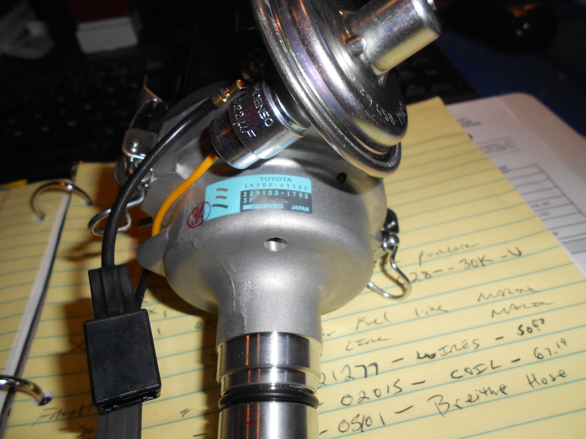

i have been trying to figure out which model dist i have. it looks a lot like the one in your photos. the model tag is vary hard to read. can anyone help determine which dist this is so i can order the correct pertronix kit? Also is there any reason not to use the flame thrower coil with the pertronix?
4/77 FJ40
Thanks!

That looks like a 61021 to me.

- Get a better photo of your green tag that shows the top portion
- looks like the first half of the part# is 19100-61 ### ?
- Reason NOT to Use the Flame thrower coil is it's Not a OEM Factory Toyota Part & it will Not have the correct Mounting U need bracket with it / On it

corner was lose so i peeled it off. this is about as good as it gets. I think it does look like 61021. is it worth keeping and adding the pertronix or should i change it out?
Thanks for taking the time to respond!
61021 like @65swb45 suggested
It looks like Age & Time have taken its tole on it , Theirs nothing better then Fresh Hot Spark Combined with New NO WEAR Moving parts / tight tolerances & clearances keeping timing in check Solid ......
BuY a new one and invest the pentronix time and resources there

my current setup is a new non usa oem dissy with the gen 1 pertronix kit.
only in sevice a few months now, but so far i like it.
can you point me in the right direction as to which new dist will work well (link or modle number)?
Thanks!
This is the Medium Cap Dist. assy I use in my own truck & install in my shop client vehicals 19100-61180
Read My 2 cents a few post's above on why i like this set-up from A OEM Toyota Genuine Parts Point of View
