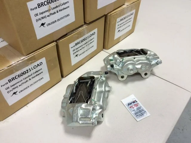

Kurt, do you stock calipers? If so, what brand? Looked on your site awhile back...you guys need a "brakes" tab ;)
We need a ton of new tabs, working on that :D
We don't stock calipers for the 80 Series yet, it is in the works. We have an exclusive offering of all Japanese loaded calipers from all OE manufactures. Currently available for the 4x/5x/6x/7x but coming 90+ applications in the future. :D
