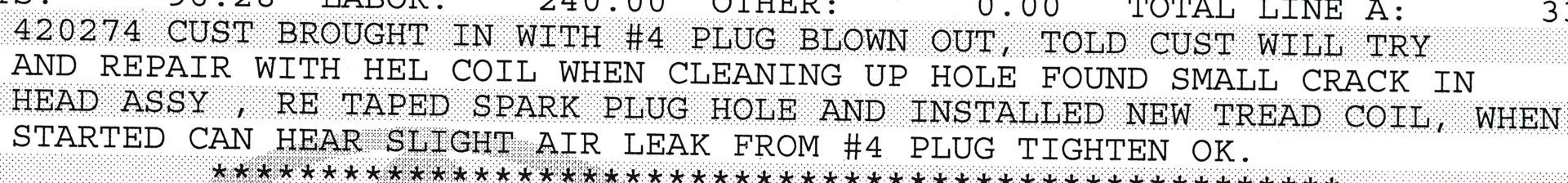

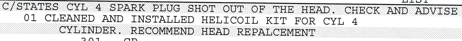

I guess the final remnant of my old DOA engine finally gave up. There is a new cylinder head in my future.

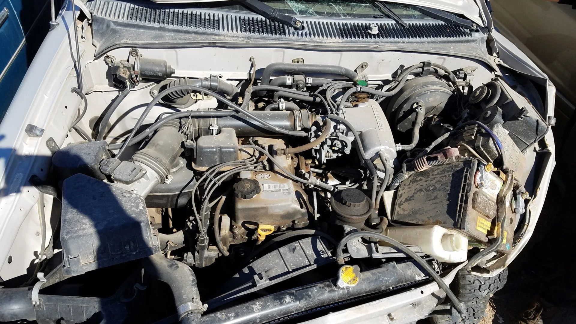

I've been saying it. A 3RZ-FE is in my future, and it's been elevated on my list. Today, I went and looked at a donor and tried to purchase just the ECM. Jack arses at the boneyard wouldn't sell me the ECM unless I bought the whole engine. So I said "show me the engine." Sucked. Heavy front damage to the truck. Damage to thermostat housing, water pump, air box, fan and clutch, the emission box (charcoal canister), air tube to throttle body. Some of this stuff I can source at the U-Pull.
They are going to pull the engine so I can see the front end damage. Accessories were OK. Questions are the timing cover (cracked by the water pump impact?), and crank pulley. If they can't sell the engine, then they will sell me the ECM a la carte.
Wow, that one took quite a hit to the driver's front corner.
Ya, battery is not where it belongs. Truck was very rolled. I'm hoping enough survived.

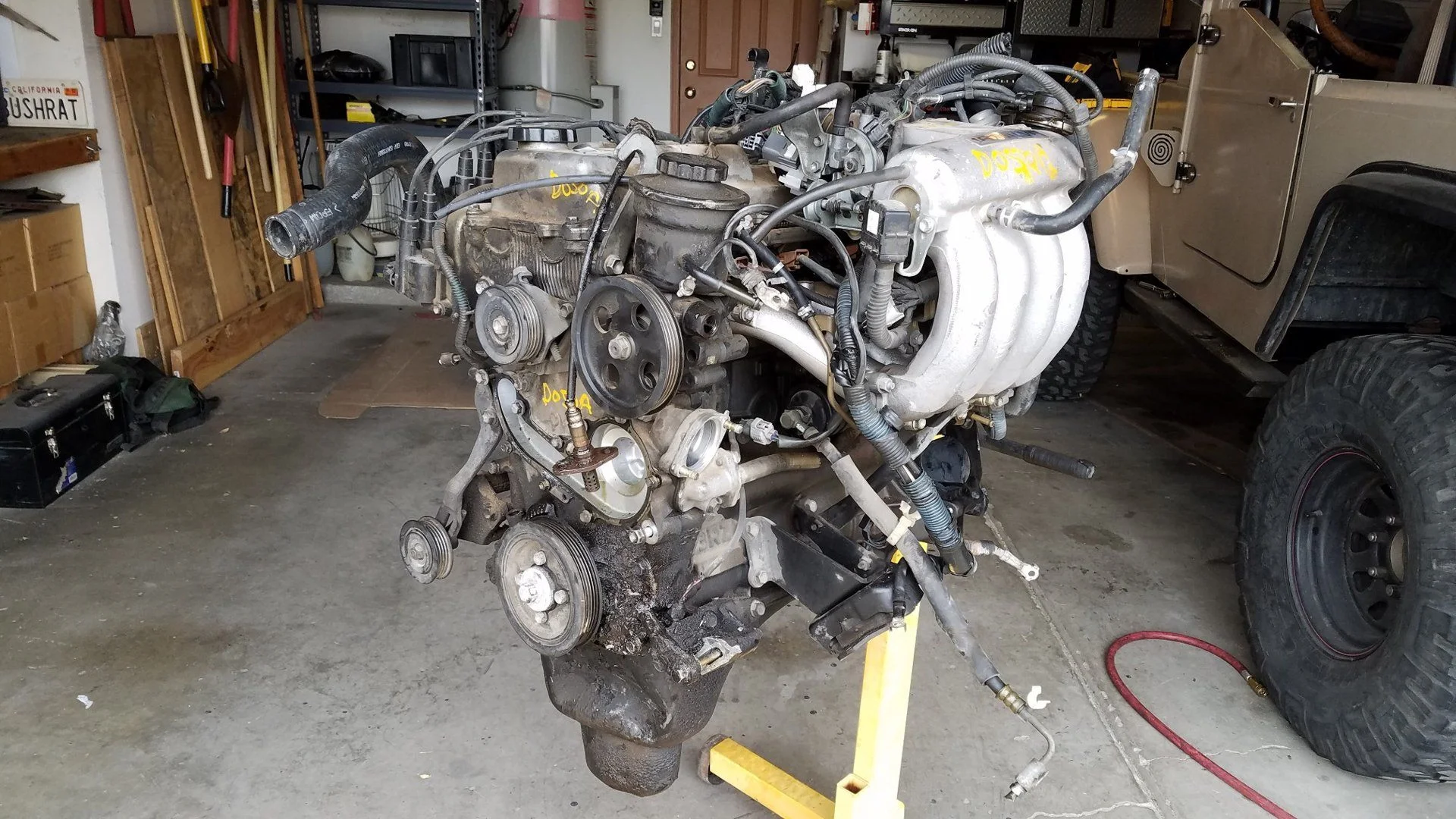

A little bit about this engine. It came from a 1998 4Runner with about 250K miles. The truck had never been serviced at a Toyota dealer. It was involved in a nasty front end collision. There was lots of damage to the engine, but nothing I can't deal with. Damage, that I know of after seeing the engine hanging:
  • Alternator was broken off the mount. I think the mount is OK, but I won't know until I get the engine cleaned up a bit. The adjuster was destroyed.
  • Charcoal canister was destroyed.
  • Thermostat housing is busted into three pieces.
  • Timing cover is cracked.
  • Water pump? What water pump?
  • Jury is out on the crank pulley. The AC and PS pulleys are bent, but from my pics it looks like the main pulley might be straight. I think the AC/PS pulleys from a 3.4L V6 are the same and they are bolt on.
  • Oil pan was bashed. Not a big deal since I need to replace it anyways with a rear-sump pan from a T100.
  • The engine harness was pinched between the engine and the firewall. There were a few broken wires.
The only accessory I kept was the PS pump. The pulley has a slight wobble.
I found a thermostat housing at the U-Pull.
I failed at finding a boneyard timing cover, so I ordered an AISIN timing cover from Rock Auto. The AISIN was cheaper than the other aftermarket covers. Go figure.

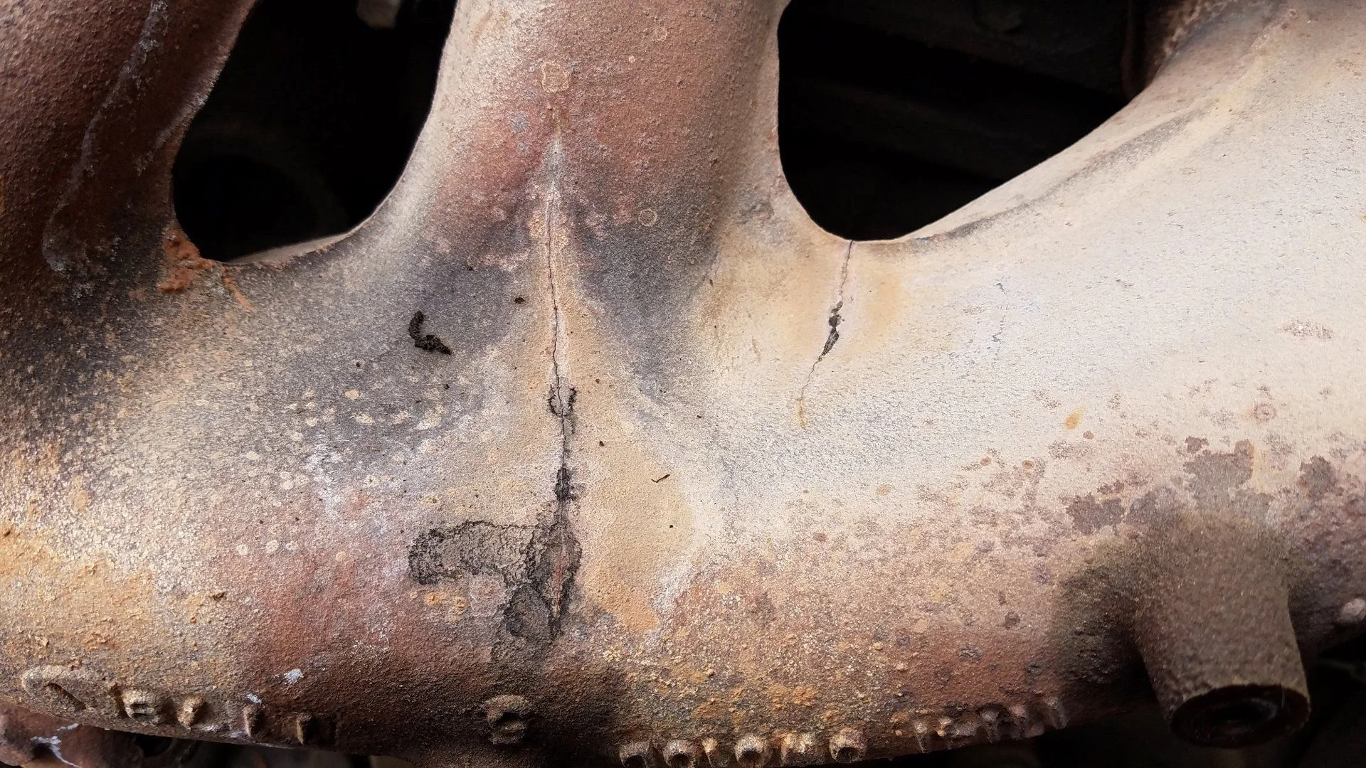

Exhaust manifold. Cracking is a known issue. Solution is the manifold used on 2001+ trucks that looks like a mini-header.
