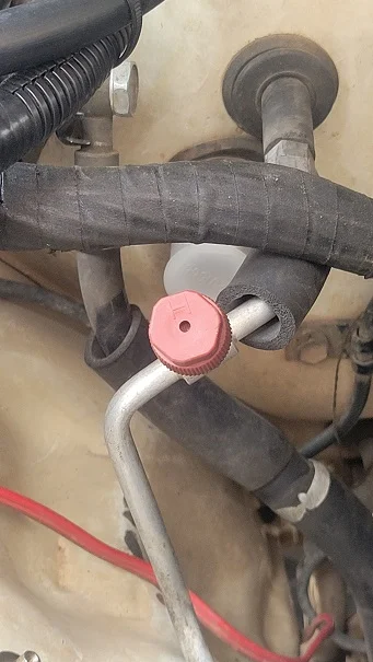

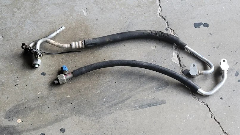

Back at it. Today was AC day. I worked on cobbling AC hoses, and installed a different high pressure line. My 22RE had the service fittings on the compressor. The new compressor doesn't have service fittings, so I needed them on the line/hose. The setup from a 1988 truck was the ticket. I just needed to adapt them to the manifold on the compressor. Hoses were mocked up so I can take them to Action Hose on Monday and get real hoses made.

Hoses ready for Action Hose
High side fitting at the firewall.

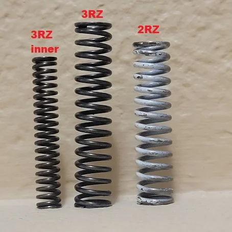

2. Oil pressure. When Robbie did the balance shaft delete it jacked up my oil pressure. Like 100psi jacked up. LC Engineering said folks run that all the time after deleting the shafts, but they did recommend removing the outer spring on the pressure relief valve. I did that, but pressure is a tad lower than I would like (40psi@3000rpm). After doing some homework I'm going to install the spring from a 2RZ (2.4L), which doesn't run balance shafts. The spring I'm running now is the inner spring (of two). The 2RZ spring is the same diameter as the 3RZ outer spring, but half way in height between the 3RZ inner and outer spring.

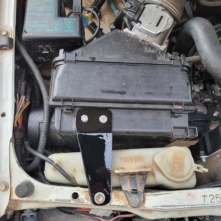

Something a little bit more fun ... and easy. I made a bracket to bolt down the air box a little better. To make this box work I had to cut off two of the mounting points. It's also attached using one of the mounting brackets under the fuse box. The bracket I made holds it down nicely from the front. The two bolts in the box are attached to rivet nuts made for plastic.
