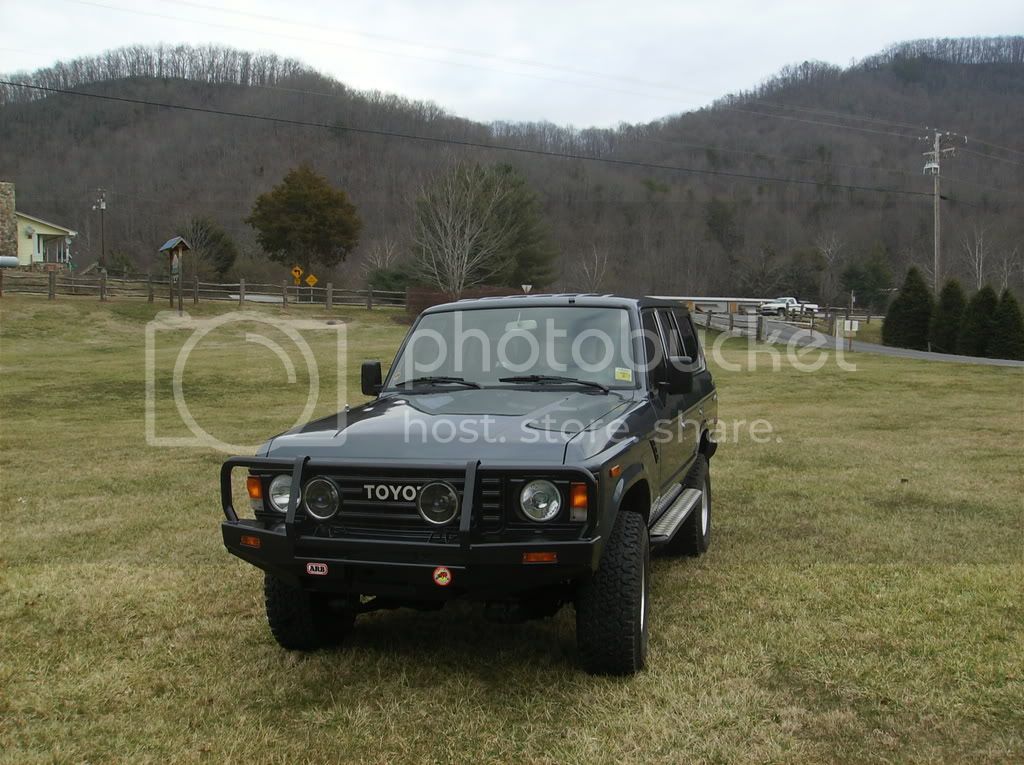

Sprayed with black hammertone- lasts about a year between touch up and then only a few spots
Dude - that is a seriously beautiful wagon... How does it stay so clean? Do you keep it in the closet?
Way Nice and clean smky! whose driving lights do you have mounted on that ARB? I'm looking to black out my plastichrome too but my body paint is no where near that.:cheers:
Miloslavich - you have my dream team of vehicles... I'm getting an 05 sti (best year) in rally blue to complement my 8b2 cruiser. I had a rex but it was destroyed by a tow company who didnt disconnect the driveshaft. sad sad story. apologies for off topic post
If it would fit I would keep it there :D
The lights are Hella Black magics- the headlights are ipf lense and bulb with the harness and honestly my high beams are brighter than the hellas. go figure:meh:
