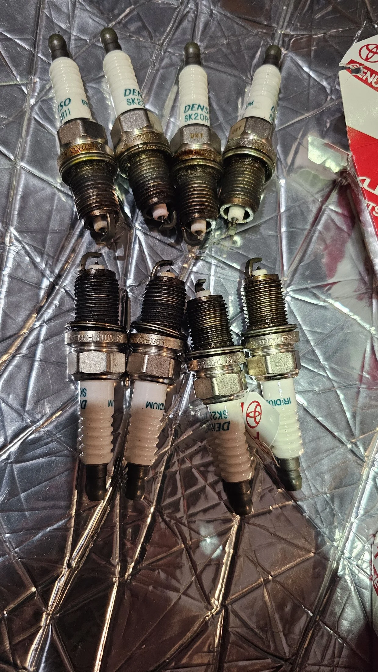

Looks like AS was definitely used when my plugs were installed. I'm am going to remove them all, do the spark and compression. And install new ones without AS. Based on the condition of the #3 plug i removed comapred to the #1 i think this may be my issue.

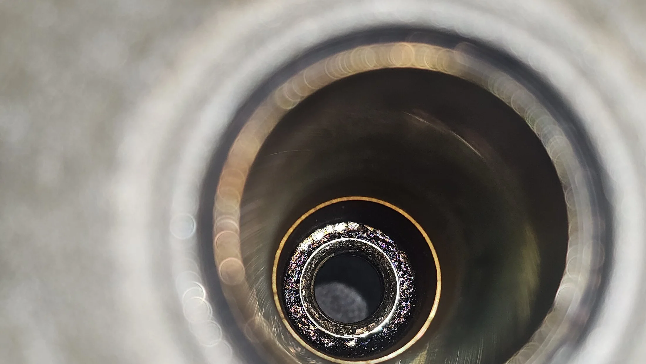

Should I clean out the residue at the base of the spark plug tube? Also do should I remove all spark plugs to do the compression test?
Again I state: I would not use. But, anti-seize on spark plugs threads, does not cause misfire.
I blow out spark plug tubes, with air pistol. Before removing spark plugs.
I'll clean tubes, using a homemade swab: Coat hanger wire, with rag attached by crimp in end of wire. Spray rag with cleaner. T-body spray cleaner or similar.

Well guys. I want to thank everyone for all the help. Especially @2001LC. Problem solved. I repaced all spark plugs and coils. Everything else checked out. Running like new. Sooooo smooth. CEL is long gone.
All the SPs were barley tight. With a lot of AS on them.
Glad I caught it early. Very relieved.
