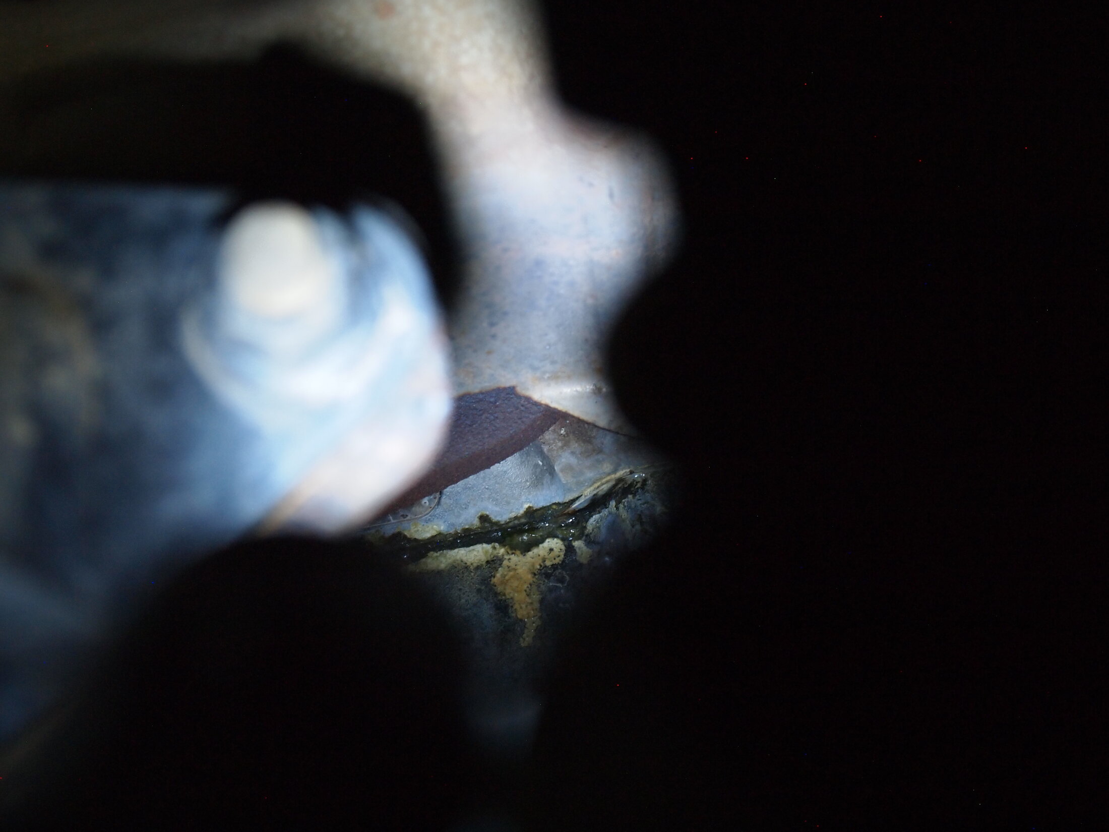

I'd visual inspection head gasket. With a flashlight. 98-05, we can get our eyes on 95% (100% of outer, and 90% of inner area under intake manifold). With a borescope we can inspect 100% of head gasket in all years. Also, look at all points of possible coolant leak, for signs coolant.

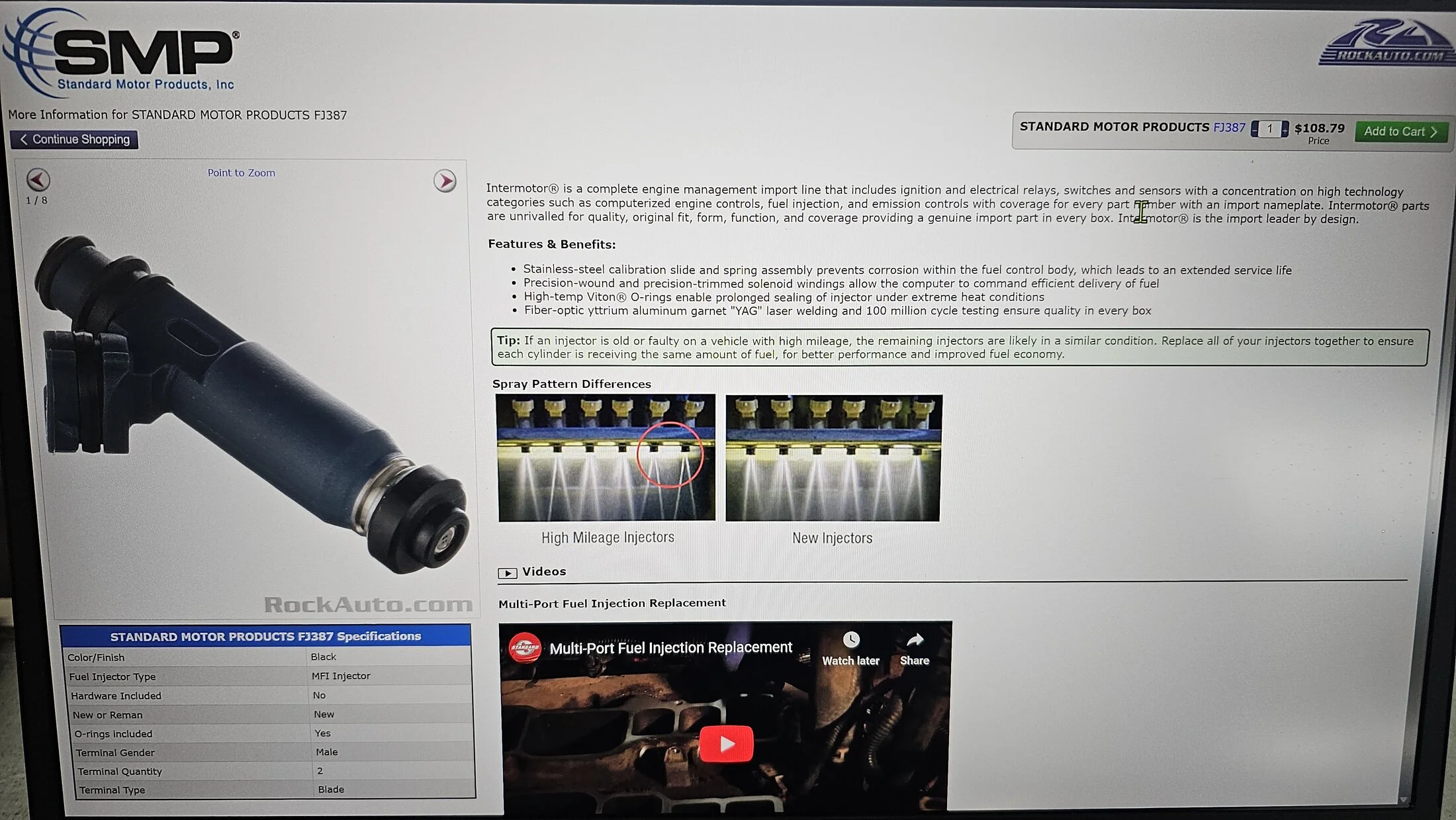

We then check fuel injector (FI).
Easy first FI test. With engine idling. Pull wire housing block, from FI. RPMs should drop. No RPM change, fuel injector is not delivering fuel.
Most times, when we find "fuel injector is not delivering fuel". It's a dead fuel injector.

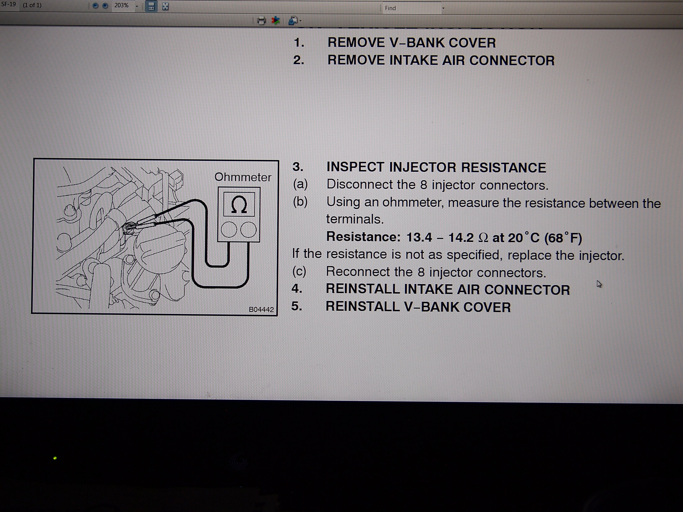

Next, easy FI test, is resistance. If FI fails this, I replacing the FI.
But it can be short in wires to injector, or even issue with ECM not giving signal to FI.

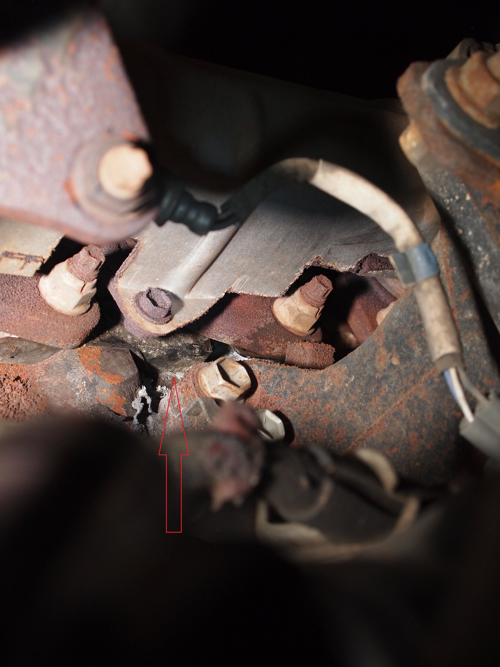

Regarding the head gasket. What are the best locations to be able to see it. I havnt had any coolant loss over the last two years. Again. I have only driven it about 1,000 miles.
As per the resistance. I unplugged just the #3 FI and got about 16ohms. I checked #5 and also got 16 ohms.
With mirror.
Also from below, shields off.
Between intake manifold plumes
Or
Borescope, directional.
If good multiment and at 68F. That's to much resistance. Since both, read 16 ohms, likely their both fine.

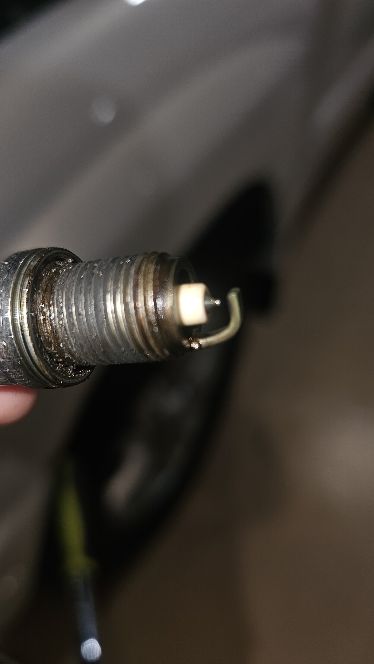

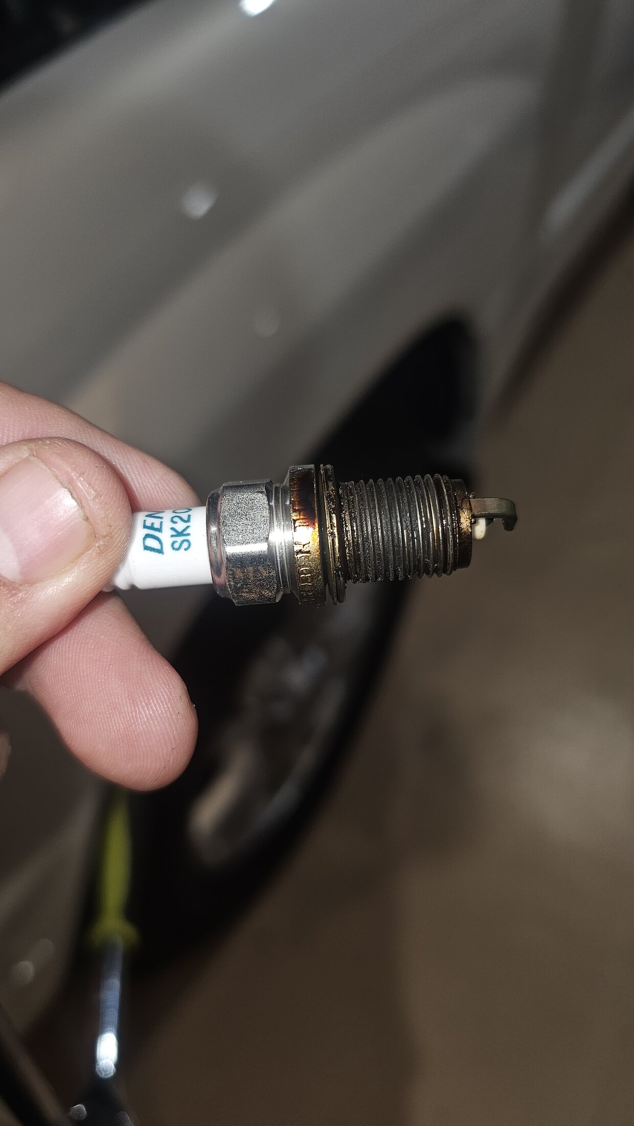

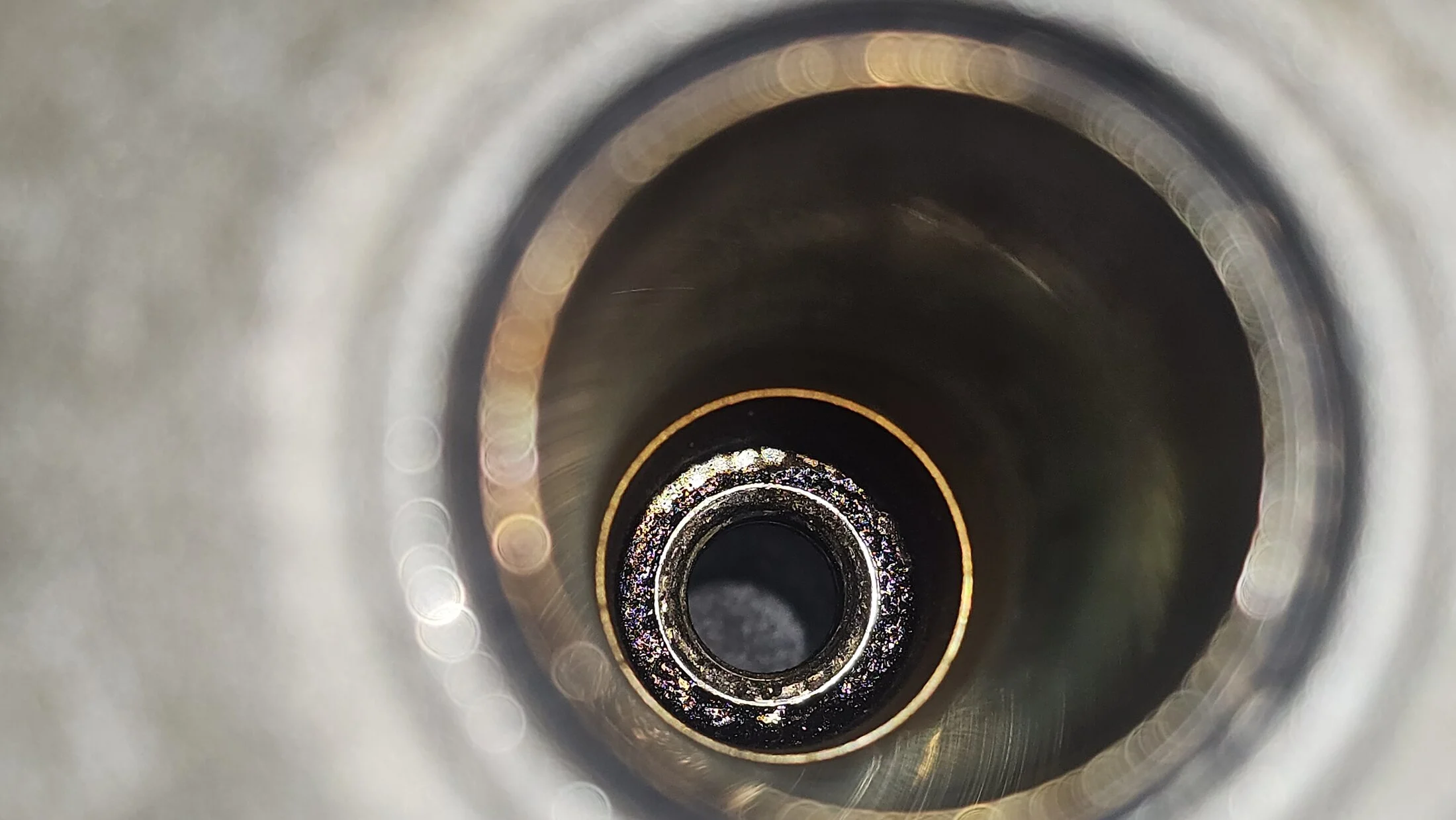

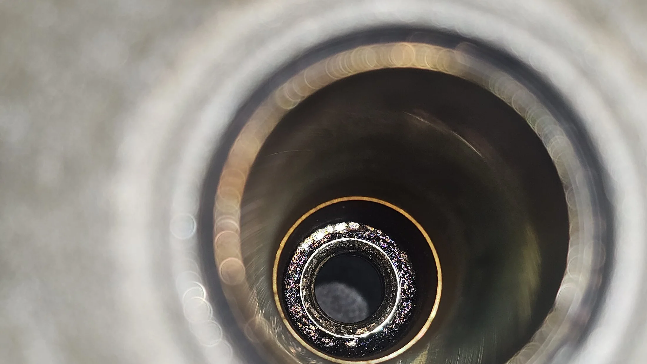

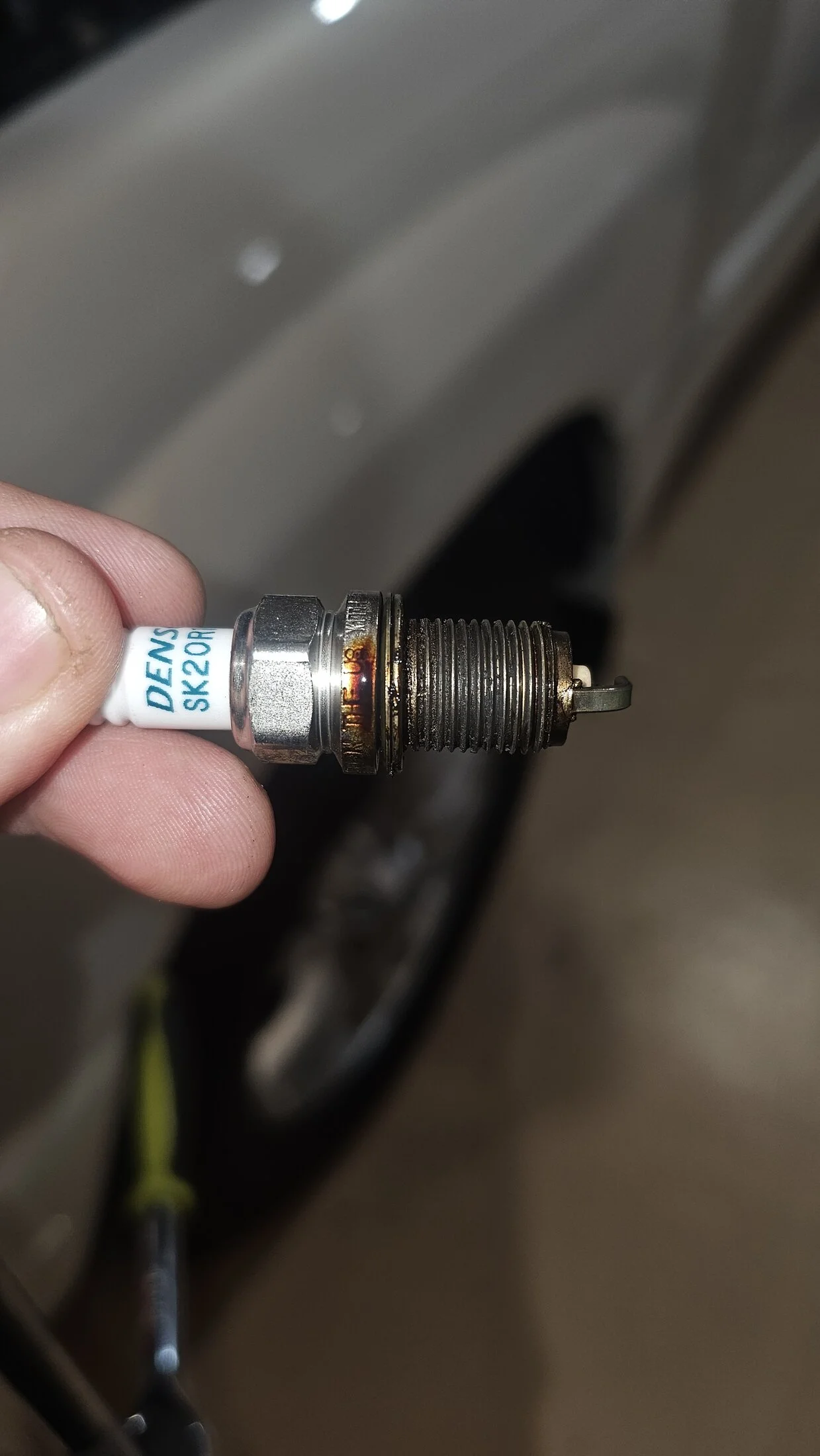

Just pulled my #3 spark plug. This is after 2 years and 1,000 miles after install. Thoughts on findings?
There shouldn’t be any oil on your plugs. Looks like time for valve cover gaskets and spark plug tube seals.
Looks like the plug was loose and wasn't sealing properly.
Maybe backing out? Looks like my guy added anti seize to the threads. Unfortunately I dropped the coil bolt. Removed the underbody trays and no dice. Can't seam to locate it. Maybe went into one of the holes of the subframe or control arms. 😬
Just pulled my #3 spark plug. This is after 2 years and 1,000 miles after install. Thoughts on findings?View attachment 3888488View attachment 3888489View attachment 3888490View attachment 3888491View attachment 3888492
Is there any oil on top tube seal?
Was spark plug tight (could you tighten more)?
Is the spark plug electroid (tip of plug) oily?
Did you get spark, during sprak test?
What was compression? (Throttle body open, fuel pump disconnected, 250RPM)
How did head gasket look?
Bad coil may have resulted in fouling spark plugs. Try cleaning with gasoline, do above test. Then, if you get spark and compression.
It happens. Hopefully it didn’t drop into the cavity of a pulley or between belt and pulley where it will rattle or lock up. @2001LC has you squared away with where to go next.

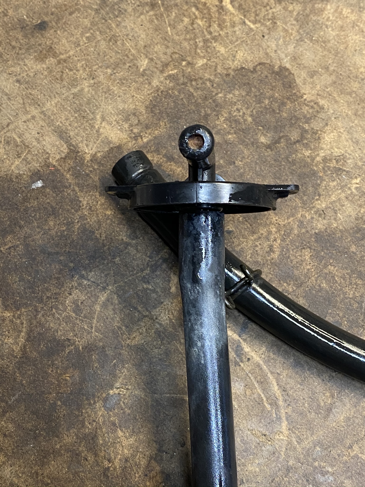

1.No oil on top of tube seal. The oil you see on the picture is dry and sticky. Not wet.
2.Spark plug could be tightened a bit more. But since I don't have a torque (on order) I didn't want to turn more. But definitely not tight to the right.
3. Electrode dry and in perfect condition
4. Didn't do spark test. But I did pull harness while engine running. Didn't feel much of a rpm drop. Check engine light never came on again after I plugged it in. Not until restart.
5. No compression test
Head gasket looks intact. No anomalies with the coolant or overheating.
When we've a loose spark plug. Combustion gasses can pass its threads. More so, during engine warm up. The dry and sticky oil, is likely byproduct of combustion gasses.

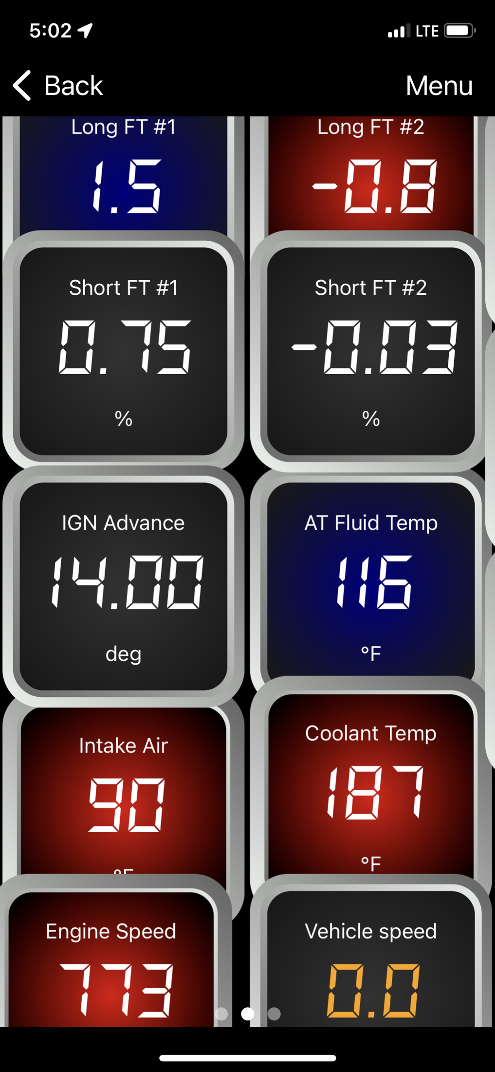

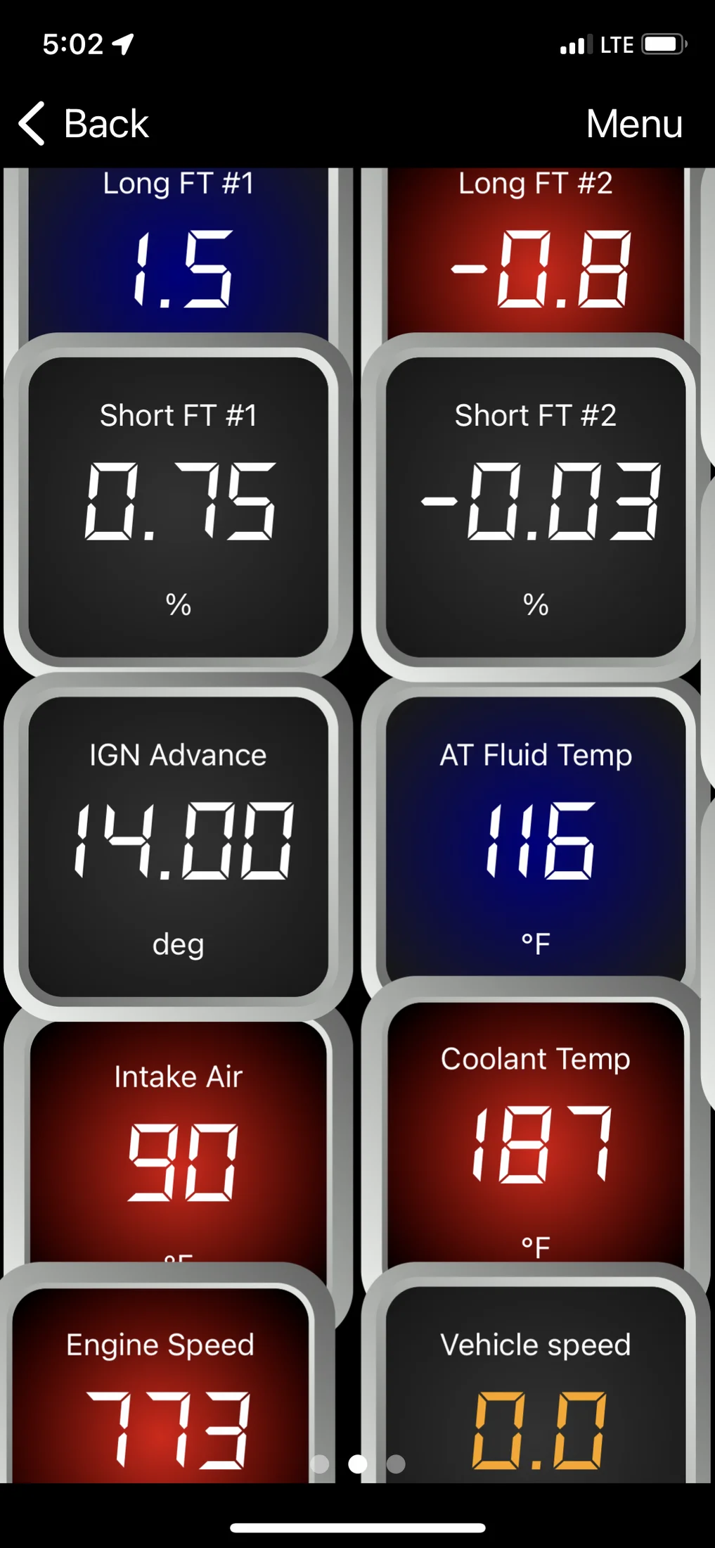

When pulling (disconnecting) fuel injector harness (wire housing block), while engine running. "Feel" is not very reliable. "Look" to see RPM change.
You can have someone watch RPM gauge, in combination meter (dash). But I find watching RPM in tech stream, much better than watching dash gauge. Since the drop is minor, dash RPM needle won't move much. Best is, to see actually digital reading of RPM. Say 773 RPM drops to 720 RPM.
I use my smartphone and with OBDII wireless connection device. These sell for from $20 to $200.
Read out of date points, I picked on my smartphone.

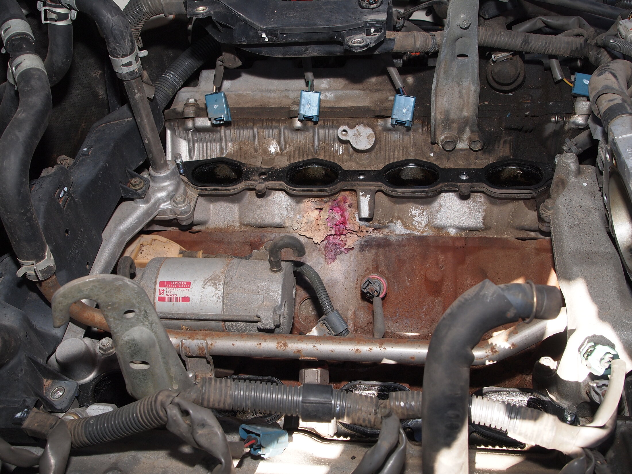

I've seen more than one with floaters in coolant system. Most, I found stop leak had been added. Some, I had no idea as why (where leak was). In a few, I found signs head gasket leak.
Sometimes when a stop leak added or a coolant or additive, not compatible with our coolant added. We get unintended issues. One is hose/cap to reservoir gets clogged.

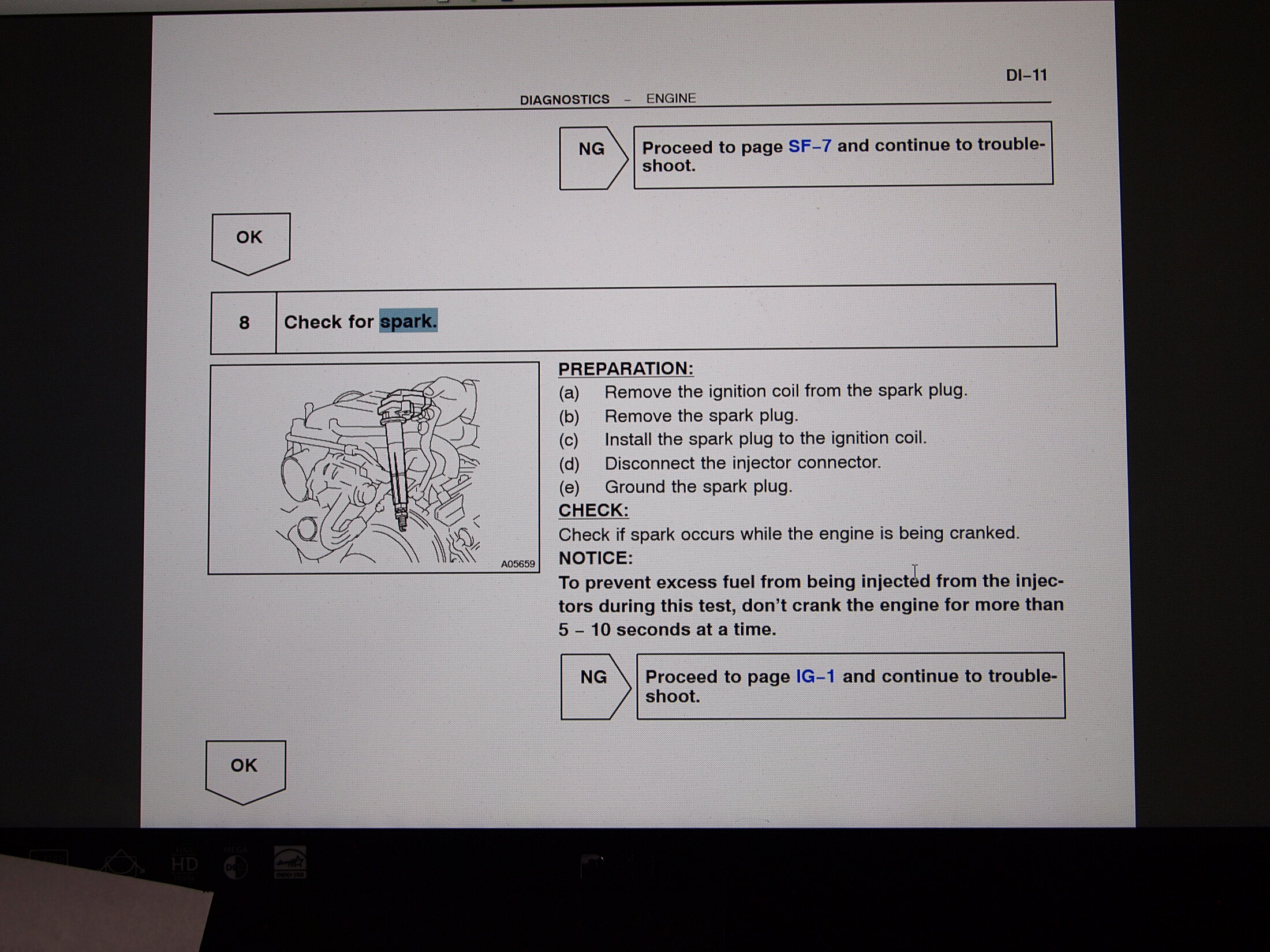

Thanks for all the info! What's the best way to ground the spark plug?
Warning:
While spark plug out and cranking engine. If fuel injector working and power to it and fuel pump. Fuel vapor can blowout spark plug and ignite from spark.
I cut power to fuel pump, so no fuel to engine (engine will not start).
We've a few ways to cut fuel delivery:
  • Remove FOB, from IG key housing. FOB houses immobilizer (cuts off power to fuel pump) chip. Security light keeps blinking, when IG key in IG SW. (engine will not start)
  • Pull fuse (98-02 EFI fuse IIRC). Cut power to fuel pump. (engine will not start)
  • Disconnect wire housing block (98-07) underbody, below DS rear door, near frame rail. (engine will not start)
  • Pull wire from fuel injector, of cylinder(s) spark plug removed from. (Engine "may" still start and run.)
Ground the spark plug:
You'll see the engine hoist hook close to, #3 cyl. By touching metal of spark plug to metal hook, it will be grounded. Have plug in coil and wire on coil. Just hold plastic of coil, to insulate your hand from shock.
You can compare spark, to another cylinder, like #1.
When replacing the spark plugs. Should I use anti seize on them? Or just install directly?
You'll get mixed opinions on that topic. Personally, I use a tiny tiny dab of anti-seize. Don't goop a bunch on and you'll be OK.
No anti-seize (AS).
I'm using 18ft-lbf torque on spark plugs. If threads lubed with AS. I'd actually be, between 27 & 36ft-lbf at 18ft-lbf. A safe torque may then be 10ft-lbf. Which we already have walk out issues at the FSM of 13ft-lbf.
If spark plugs walk out. The combustion gasses well mix with AS in threads and cook. This will stop the walking out as the mix hardens. But will make plugs extremely hard to remove. If not removed soon. Just to break free, they'll be very very hard to turn. Most can't even get them out.
