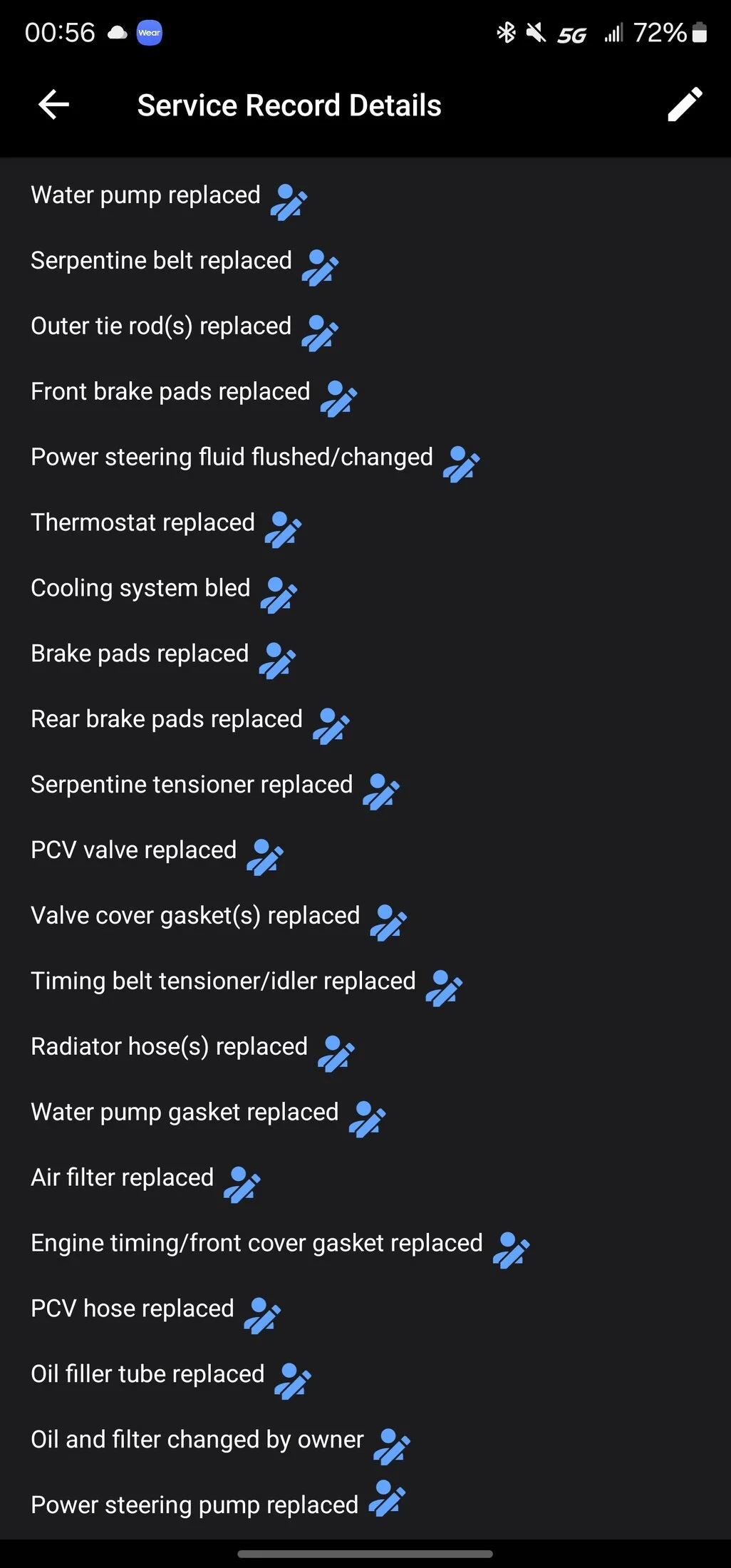

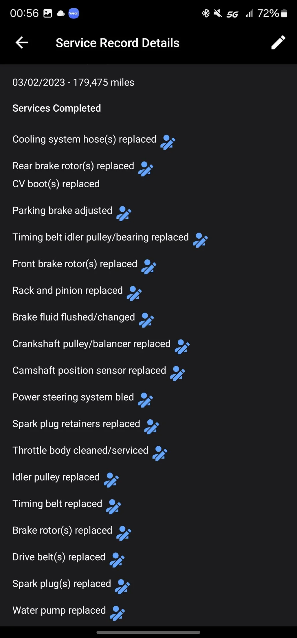

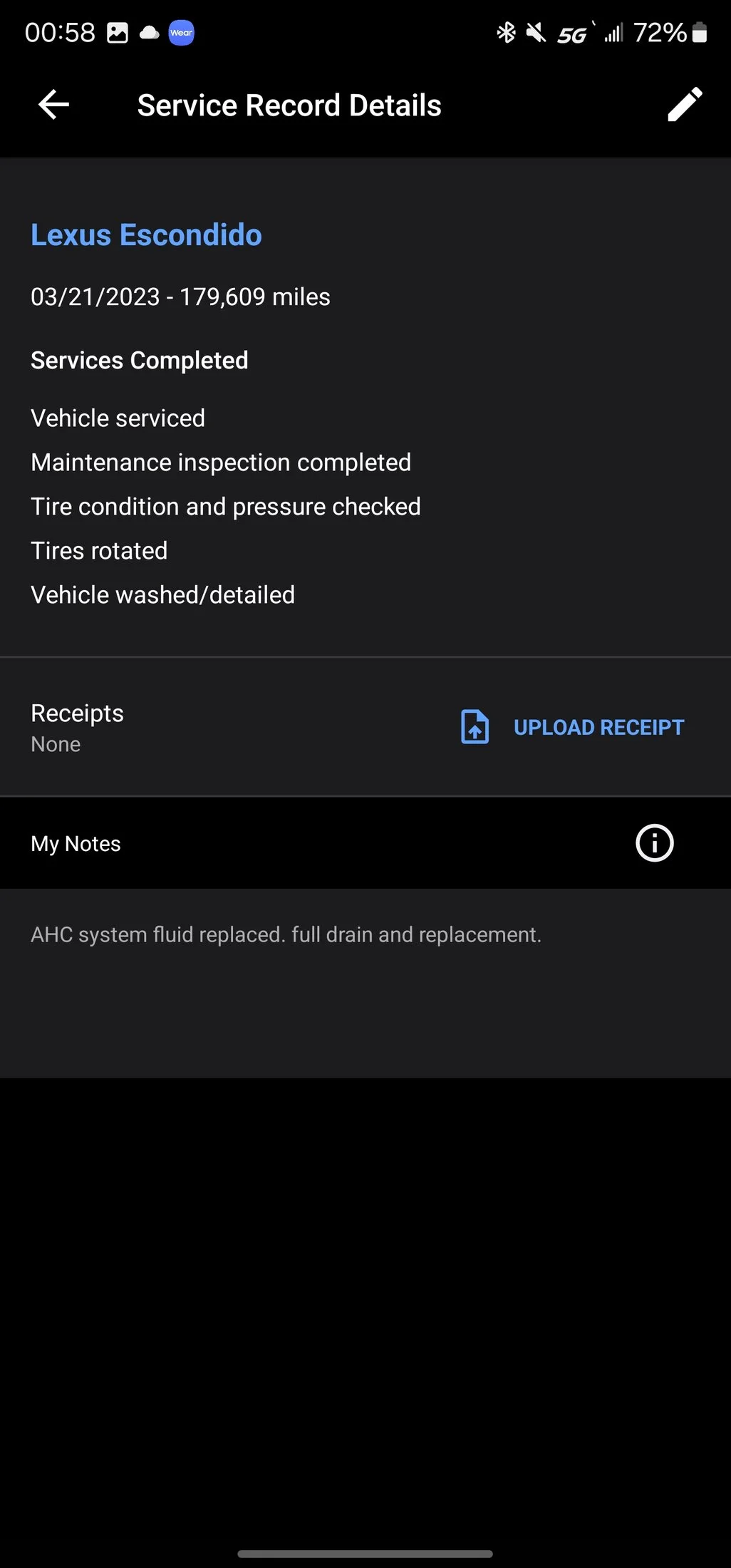

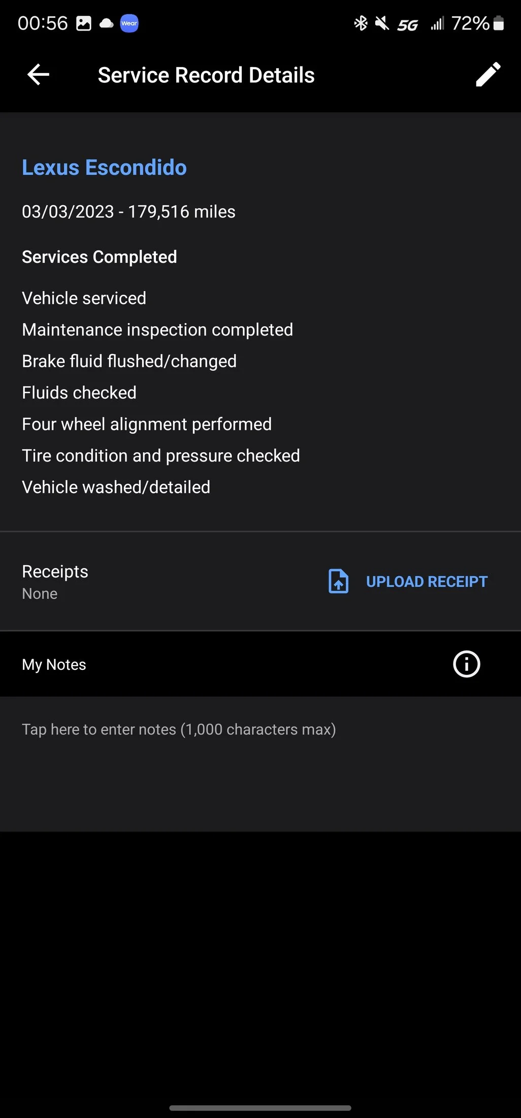

Here is the work that's has been done to it in the last 2 years. Current mileage 180,633.

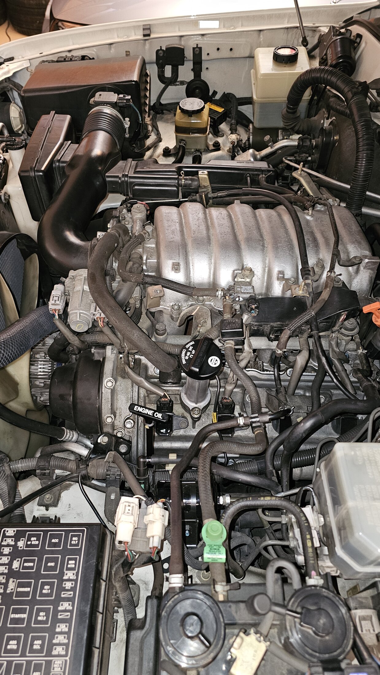

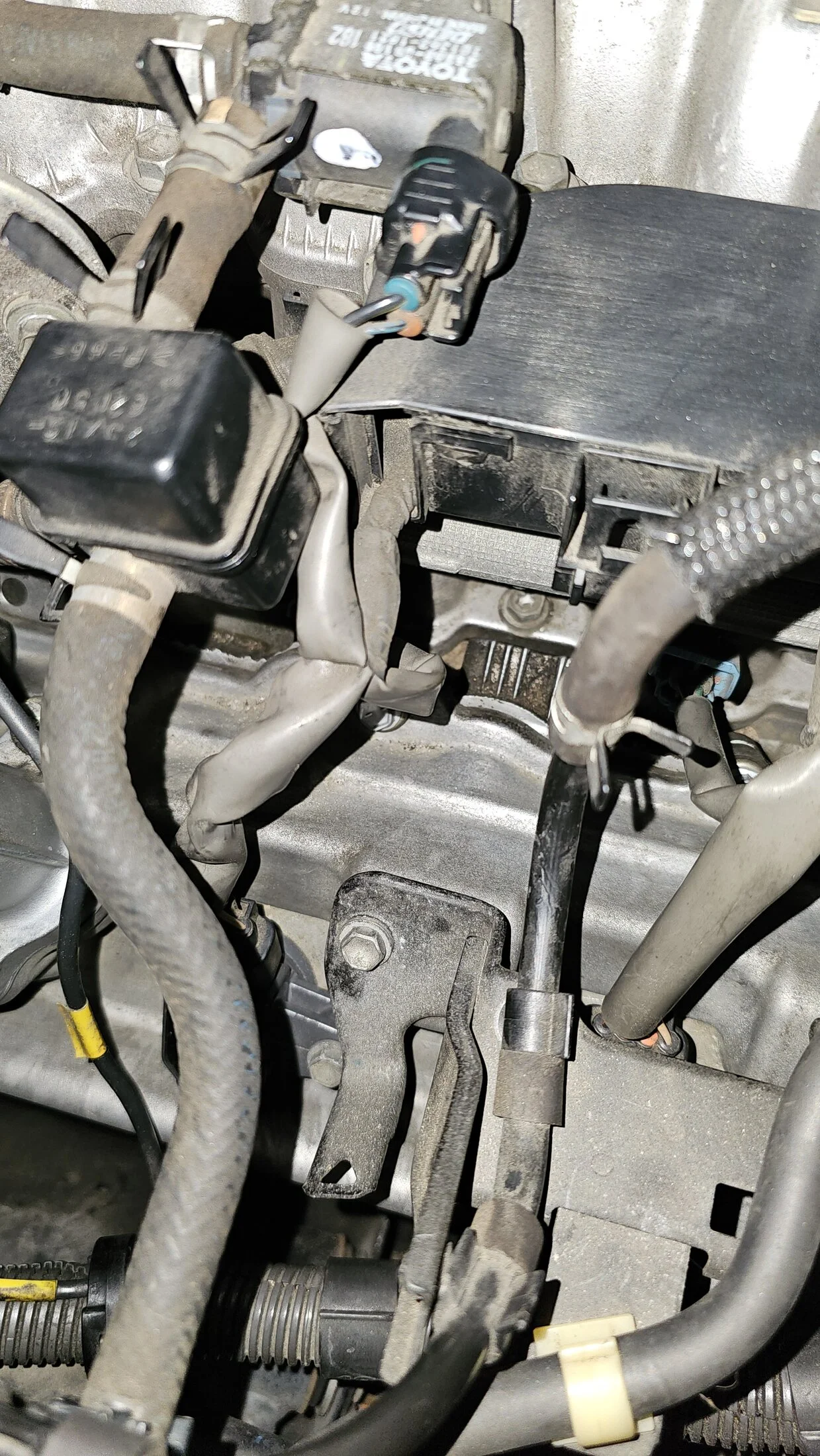

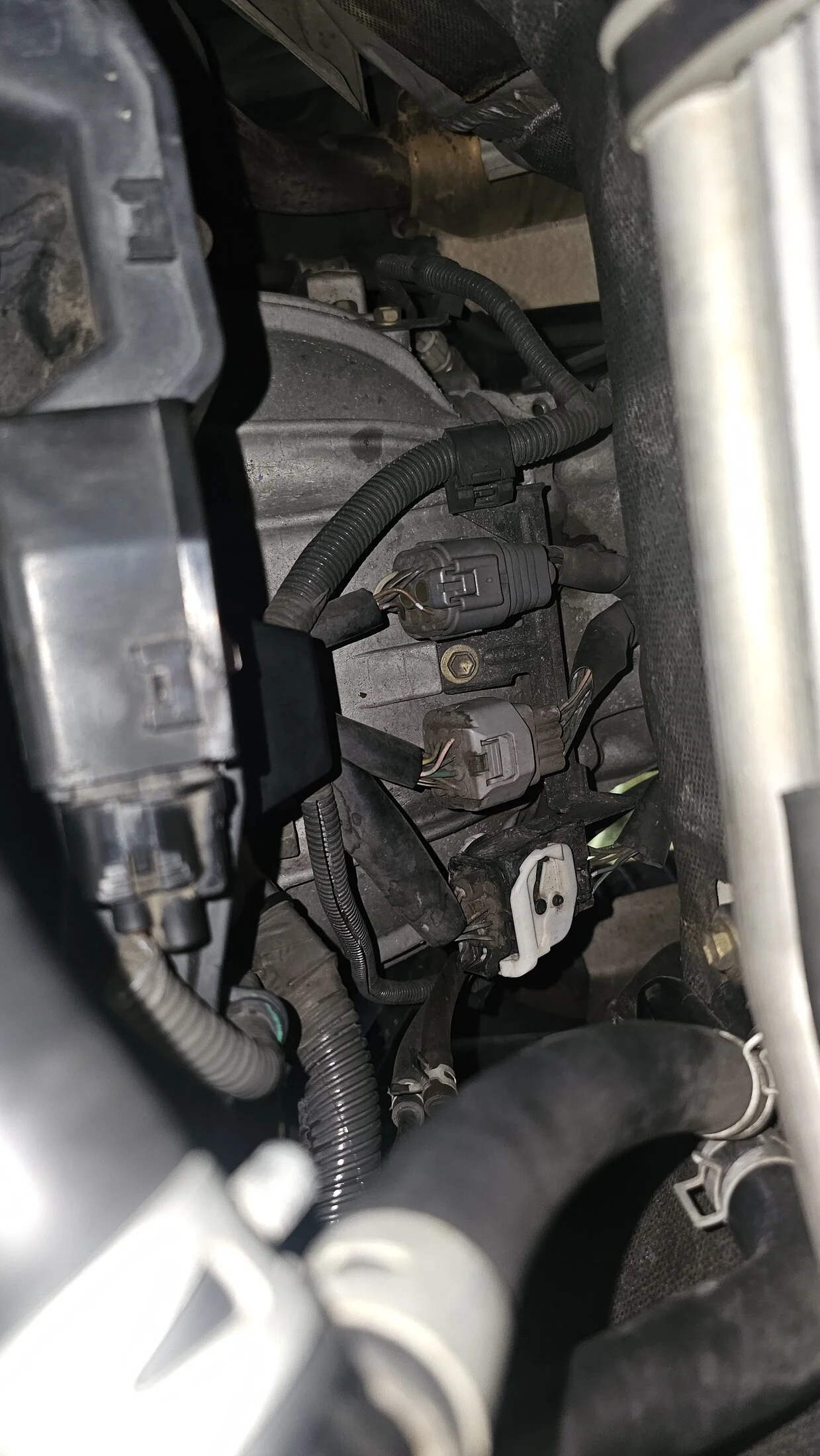

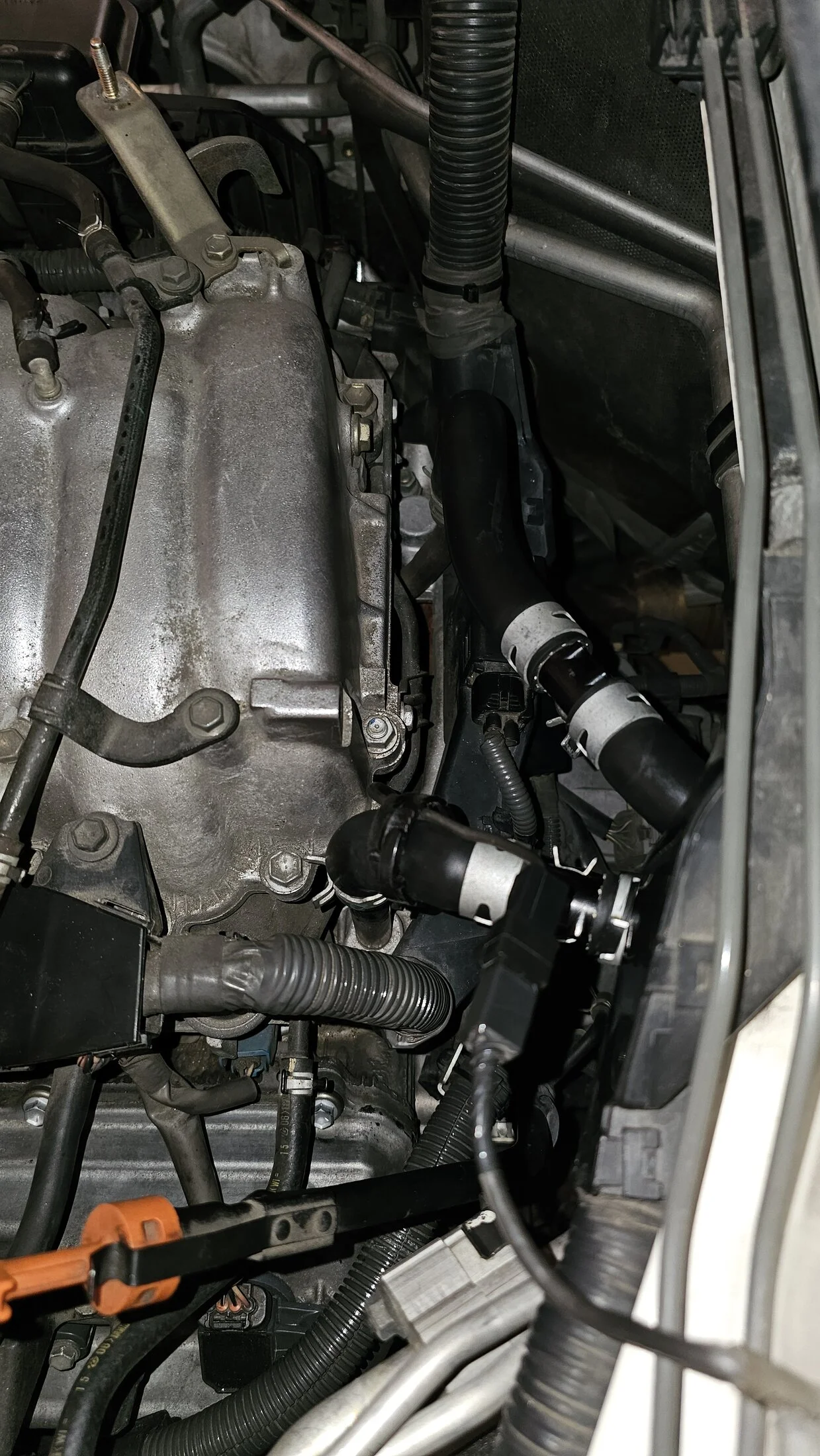

I checked the area around the tees. All looks normal. I did get done coolant spillage when changing them but I don't think that would have gotten into the wiring or harnesses? They seem well covered. Plus most of the coolant ended up on thr ground.
The area looks normal to me. No obvious hose or wiring issues.

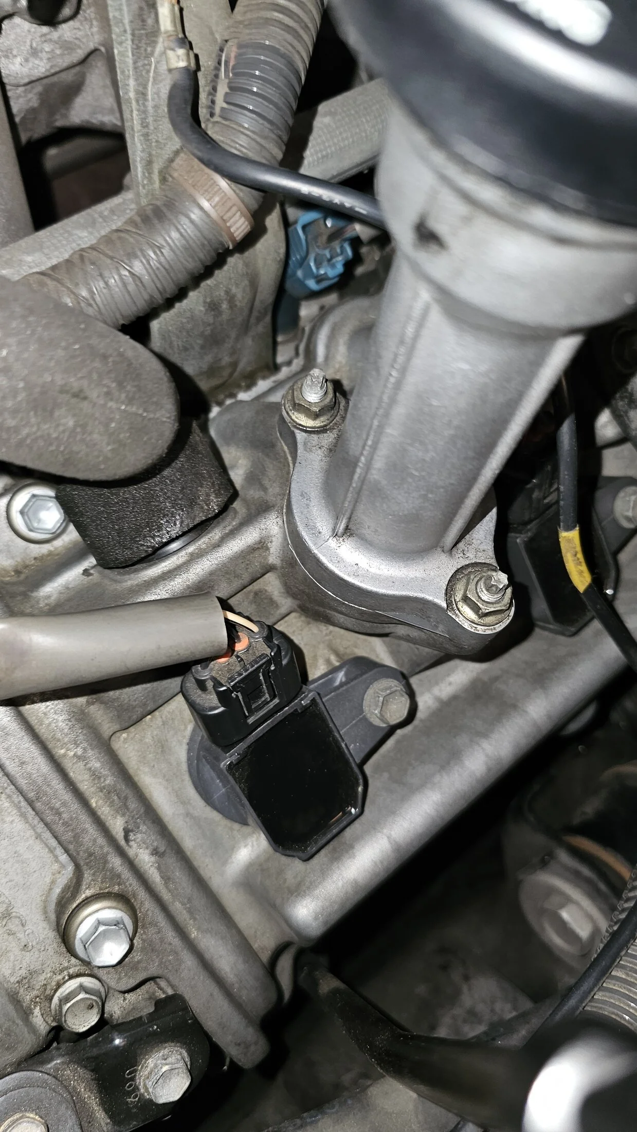

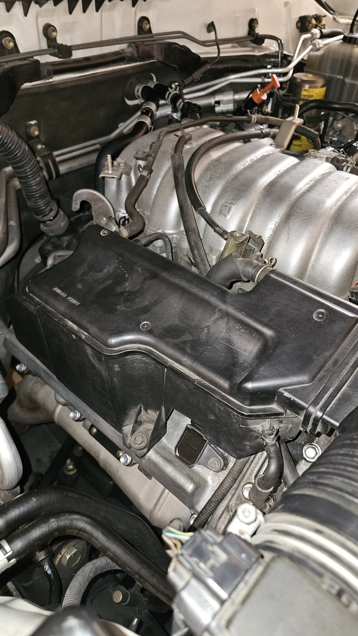

Here are some pictures of the engine area and behind the tees if you guys spot anything out of the ordinary. Thanks.

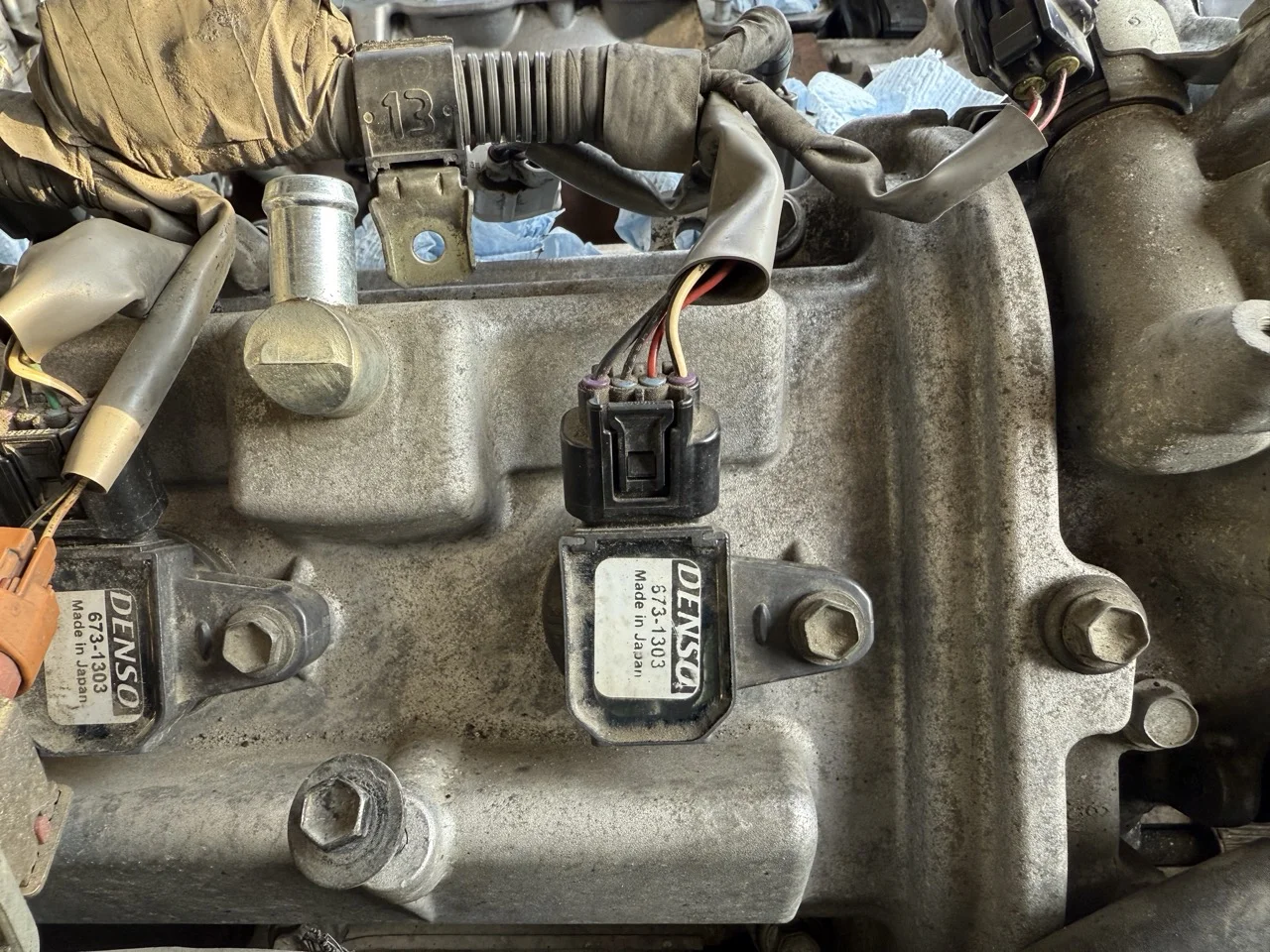

I swapped out the coils. 3 to 1 and 1 to 3. Still getting the p0303 code immediately after startup.

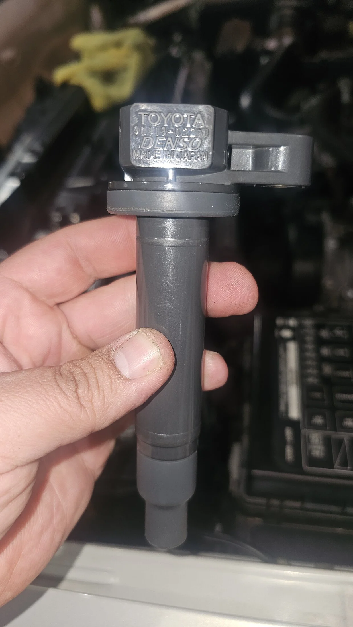

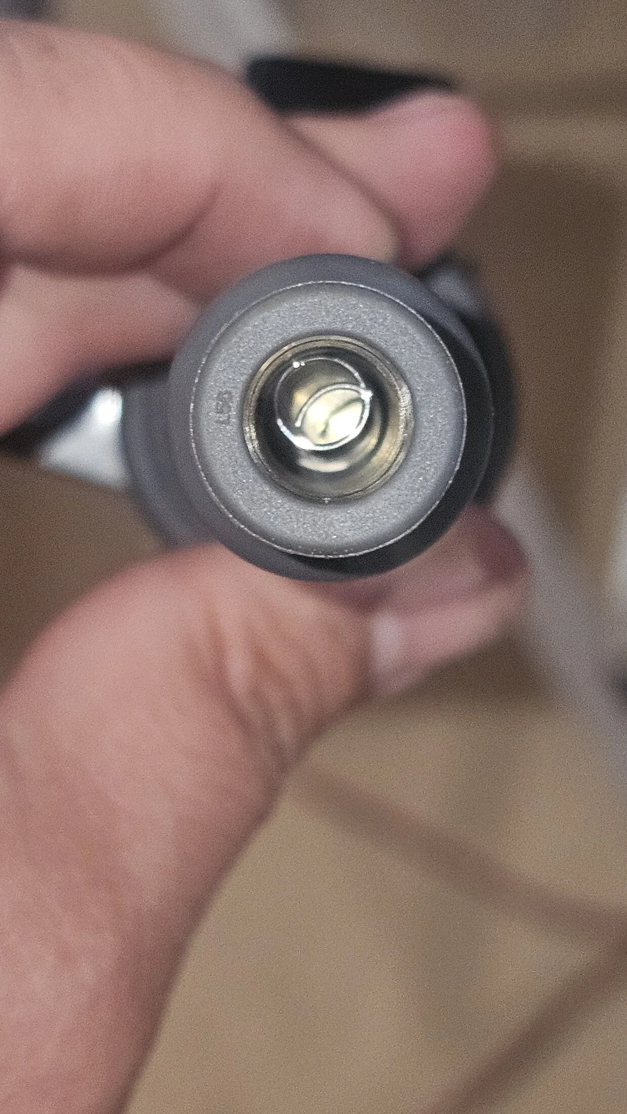

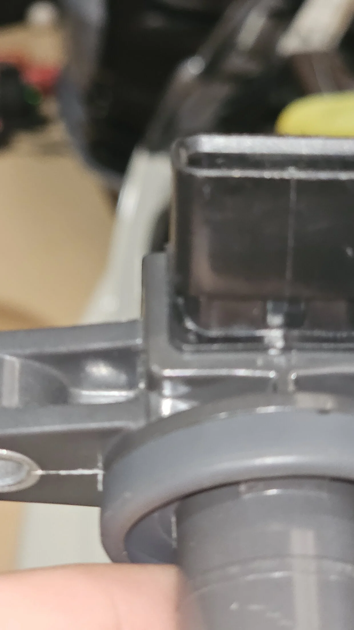

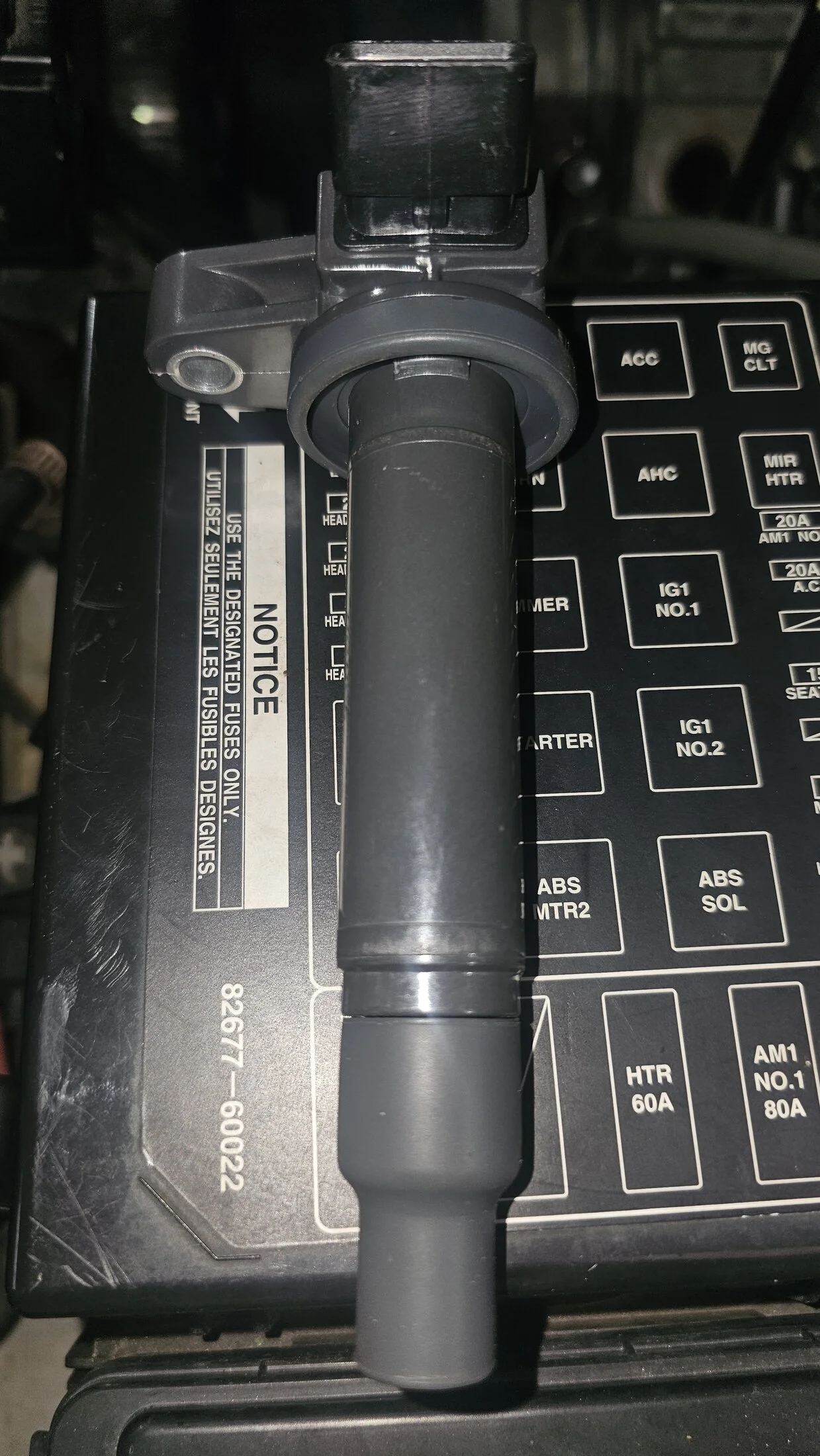

Did you clear the code after swapping the coil or you start the car without clearing the codeView attachment 3882629? Picture of the coil in my car just for reference.
From my research the ones with the stickers are direct from denso. But after looking into it it may be that I was duped. They were off a "legit" ebay seller.
I disconnected the battery for 30 mins. Swapped the coils. Reconnected,
started the car and cleared previous codes. P0303 popped up immediately after.
