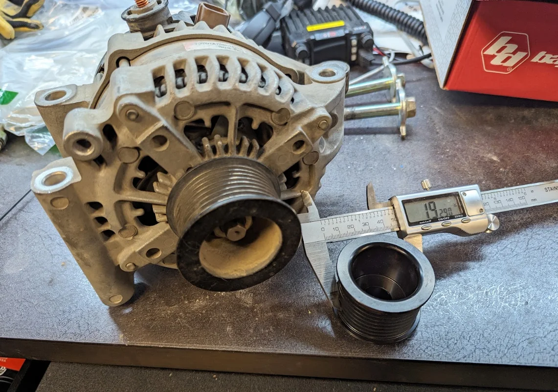

A smaller alternator overdrive pulley and matching belt to spin the OEM 180A alternator ~16% faster. Not necessarily to expand max output, but to add low rpm output support and longevity against added loads.
Stock pulley is 2.25". Overdrive pulley is 1.93".

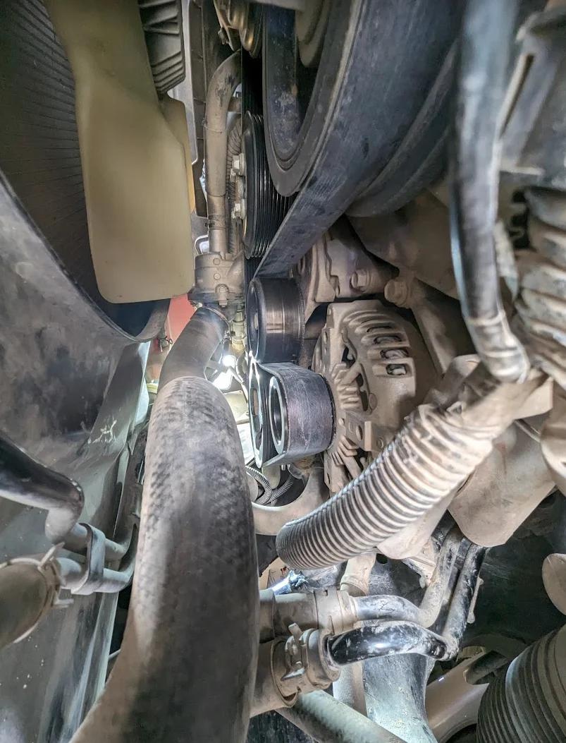

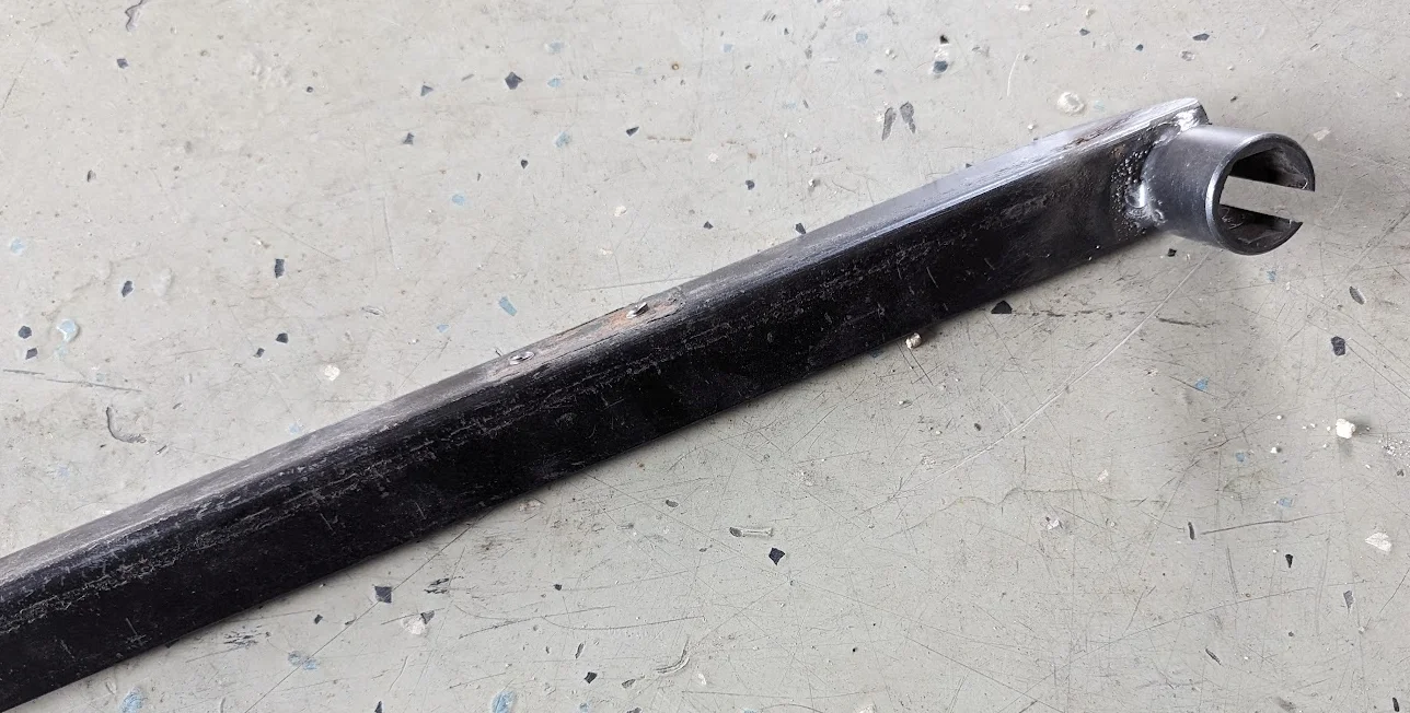

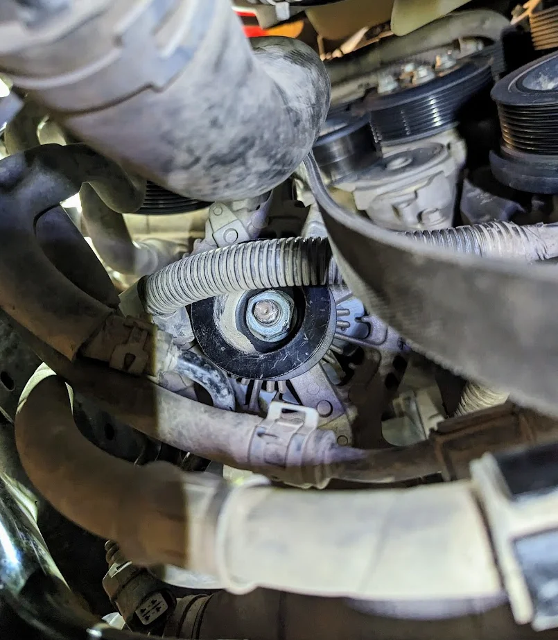

Doing this job with alternator in situ is no joke and I wasn't able to remove the pulley. It's tricky to get enough leverage and bite on the 22m retaining nut, while countering by holding the pulley or 10mm shaft. Even after fabbing up a custom tool. I resorted to removing the alternator (2-4 bananas depending on skill and access tools). The job was probably only 2hrs total once I gave in to removing the alternator. Radiator left in place but that is potentially another option and approach to get a compact impact gun on the pulley nut. Undo brackets that hold the tranny cooling lines and power steering lines, and unbolt the sway bar (LX) to let it hang down. KDSS would make this trickier. Once I was able to rotate the alternator in the engine bay where I could hit the retaining nut squarely with an impact (DCF921B), it made quick work to remove the OE pulley and install the overdrive pulley. No countering necessary with an impact. Torque spec is 29 ft lbs but a couple ugga duggas from my calibrated impact ;)
More detailed install instructions can be found in this thread
Alternator in situ. Not much working room
This custom 22mm socket tool was good, but I could not get the 10mm socket on the shaft to bite and counter with enough torque
Unmounted alternator positioned where I could get an impact socket squarely on the pulley nut from underneath.

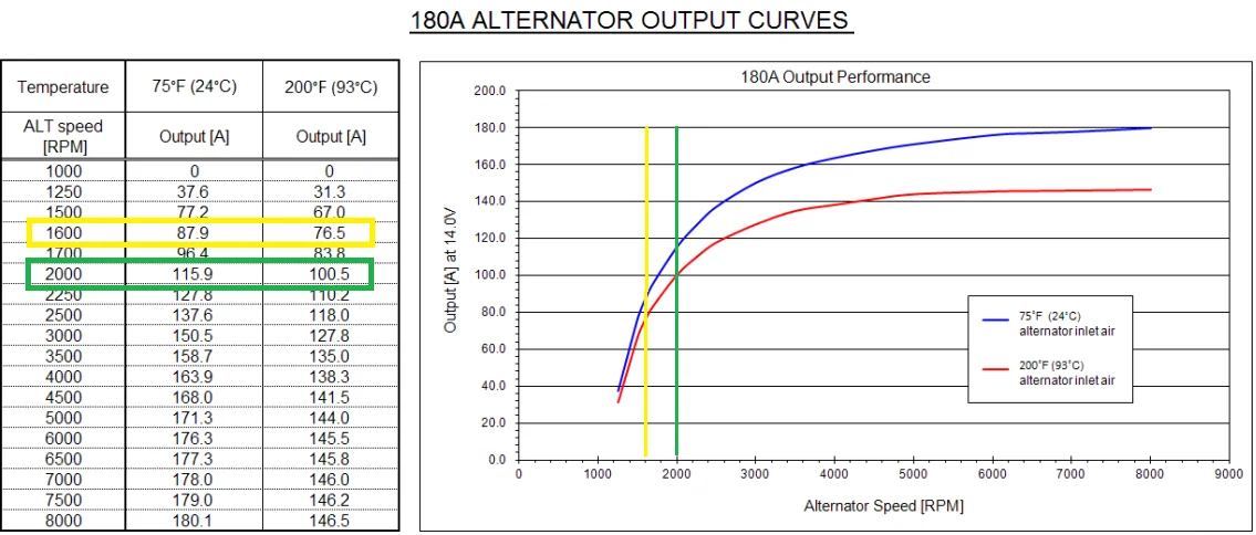

This is an output graph for a typical 180A alternator. A ~25A output improvement. Less voltage sag at idle. More output support. Faster starter battery recovery even with loads on.
