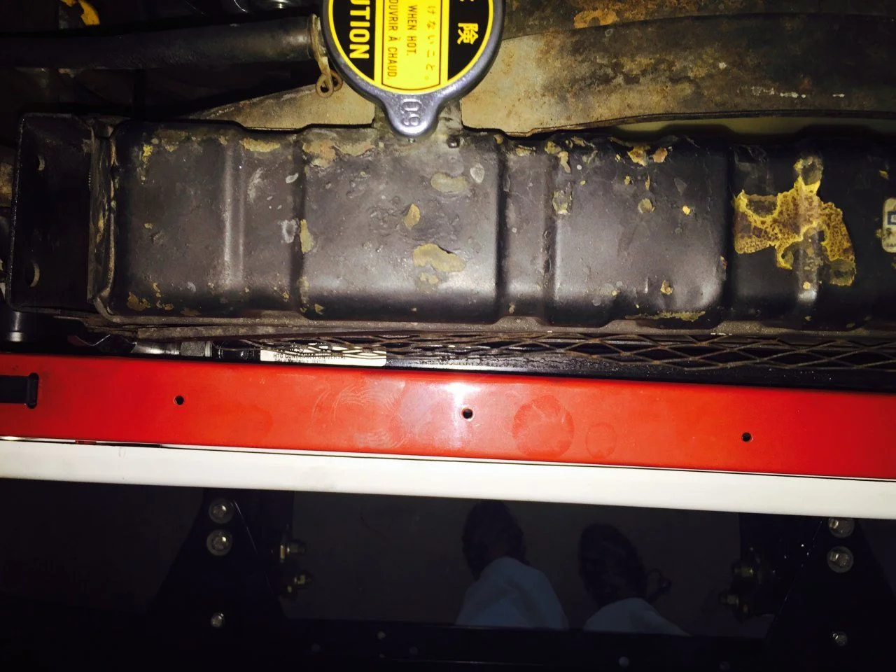

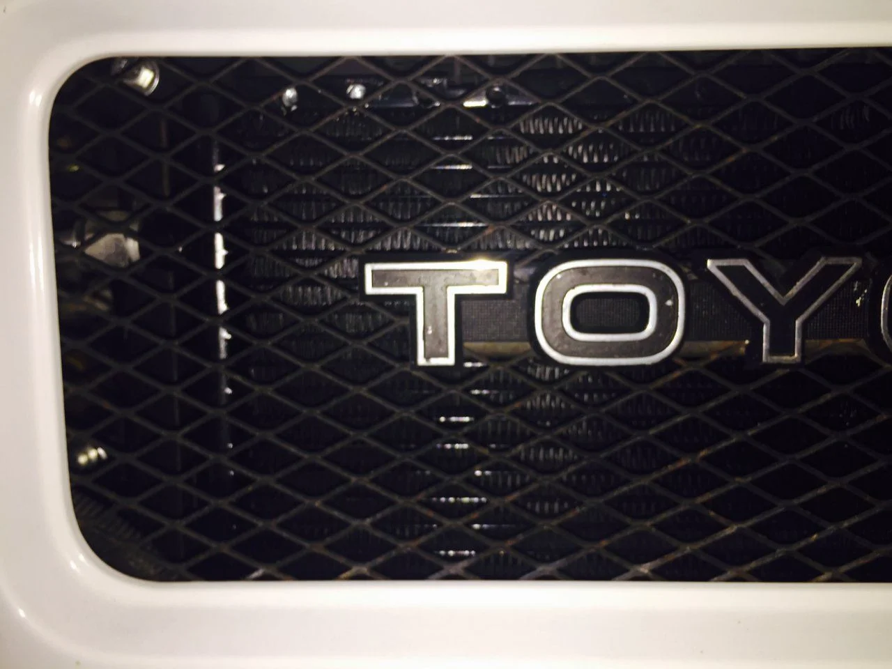

Marshall, here are the pics. It's very tough to see the condenser as it is behind grill, literally 1/2 inch from front of radiator. Top of condenser is about 3 inches above "Toyota" grill emblem (vintage air recommended location) and it is as wide as stock radiator.
So it sounds like I'm very close to overheating, not just a gauge issue. Anyone with a VA A/C system having this issue with stock cooling system? Anyone have additional thoughts?

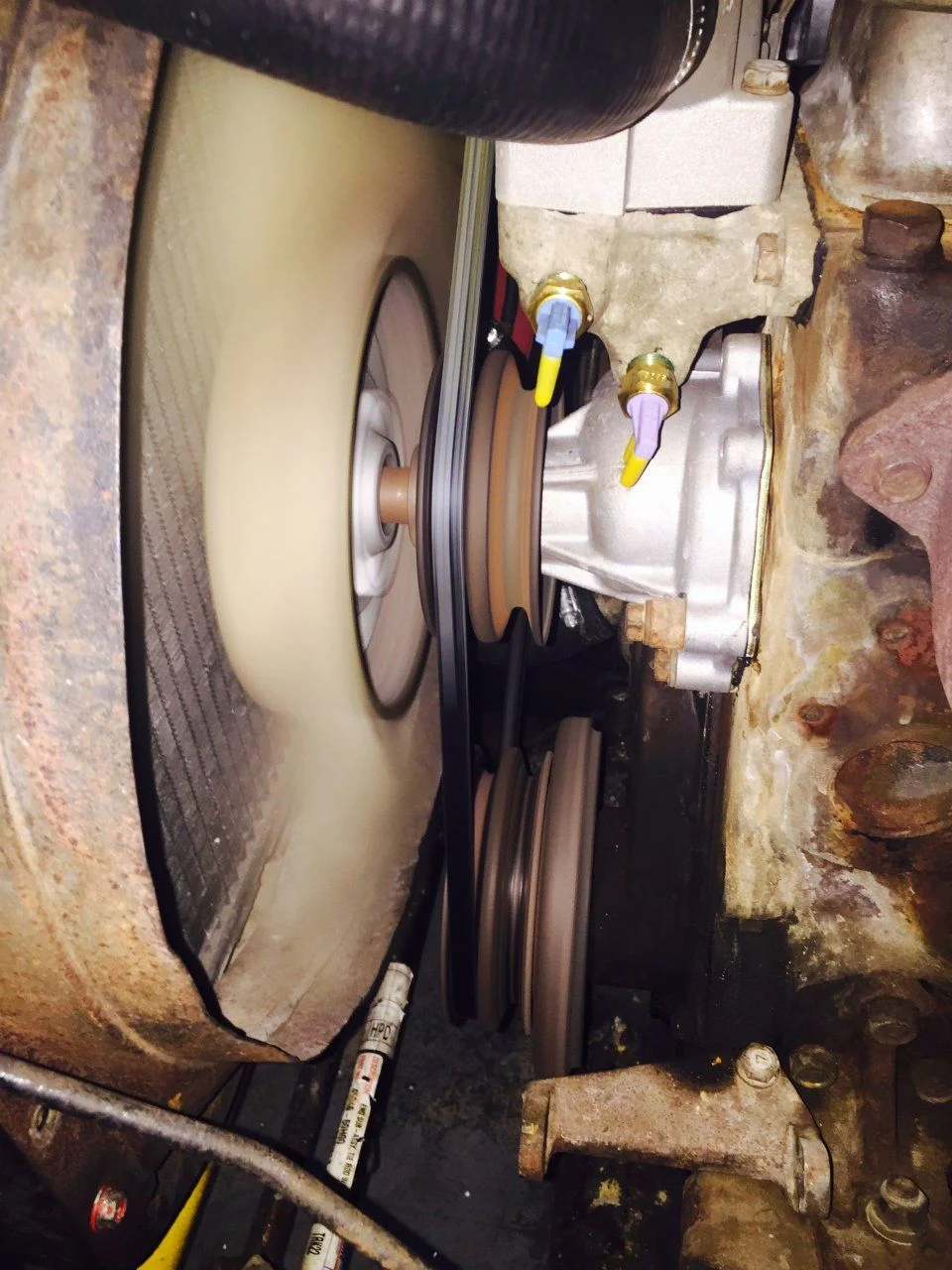

I'm still having belt slipping issues with a 25-9590 napa belt (outside diameter 58.77). Tried previously to fit shorter belt but could't get it to fit. Anyone have this issue? Looks to be partly due to such little contact with the belt and the waterpump/fan pulley and the angle/location of the A/C pump on the Vintage Air system. (pics of the waterpump and belt are above).
Anyone had this problem? Installed a tension pulley or maybe a second belt from crankshaft pulley to the waterpump?
