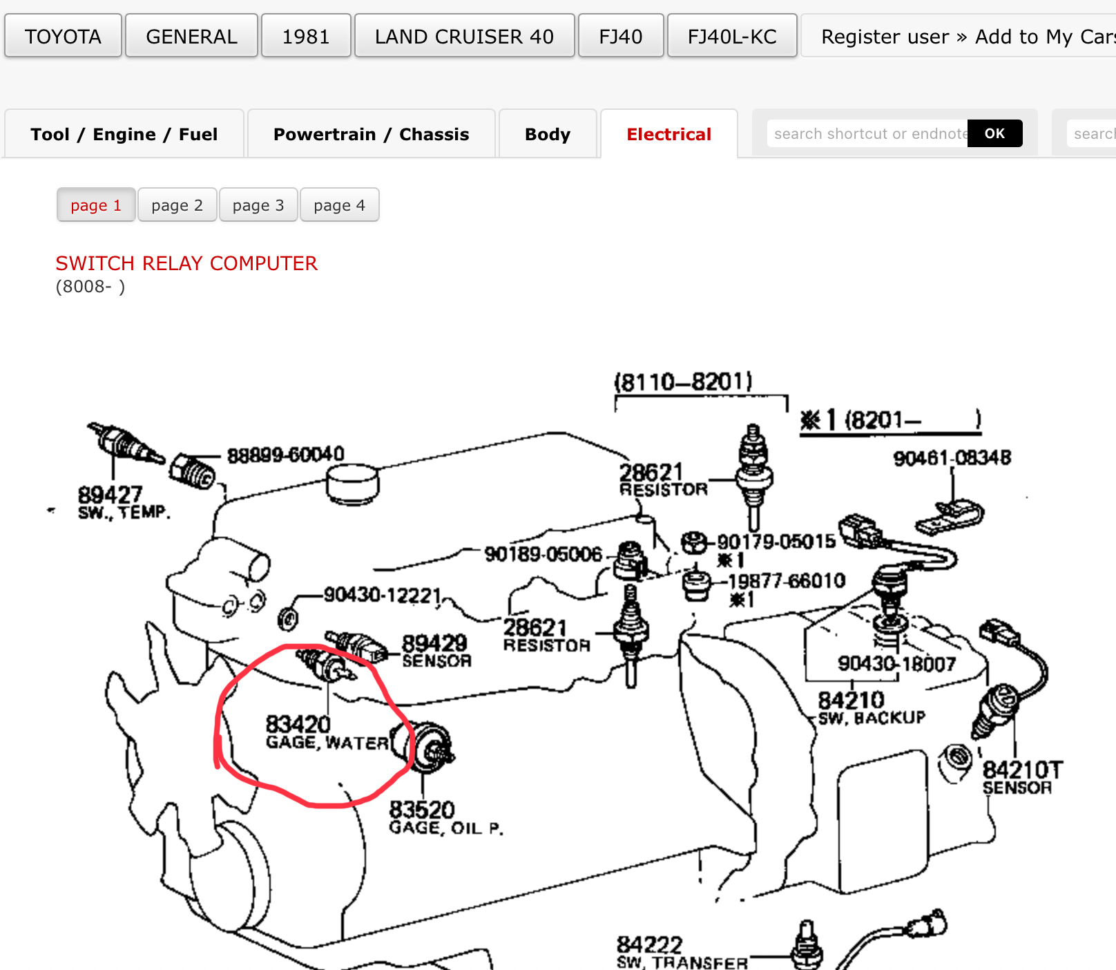

I could be wrong on this, but from the pictures @mdwhiting posted he does not have the temp sender in the T Stat housing. I believe his temperature sending unit is on the right rear of the head in his picture in post 9.
Correct, mine is there as well.
You must have a sender somewhere. This is a 1981 general market diagram. Not sure your exact model so this might be off. But it looks like 2 sensor holes in the thermostat housing. If they are both plugged, then it’s been moved. Looks like it’s the same PN as the US models, 83420-20020. But I may have the wrong model.
Thanks for sharing this - what website has these drawings? My model is FJ40RV-UC. I see this is for L-KC....
@mdwhiting your temp sending unit is on the driver side rear of your head. Put an IR GUN on it to get your real temp.
Interesting. Same sender PN, BTW.
