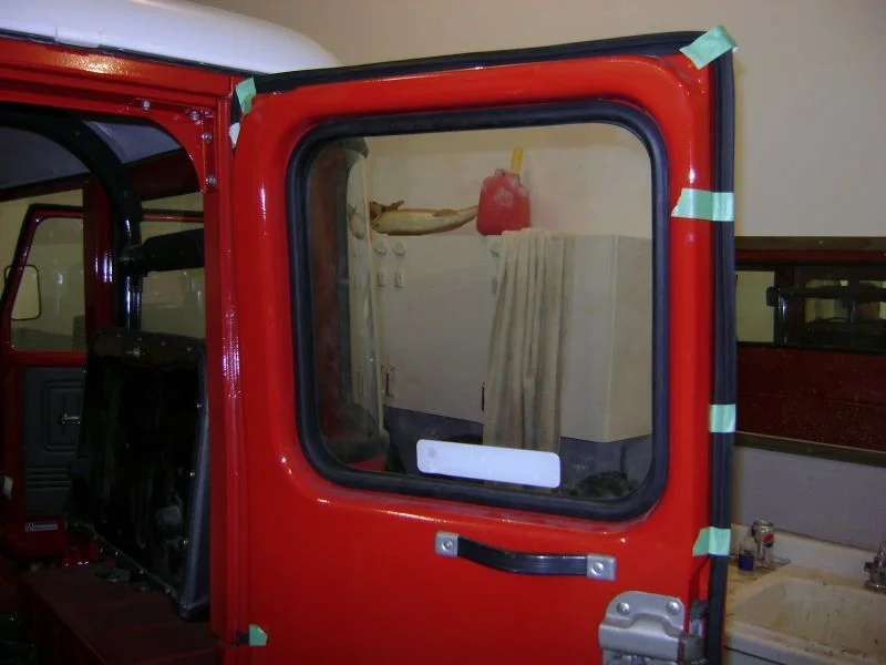

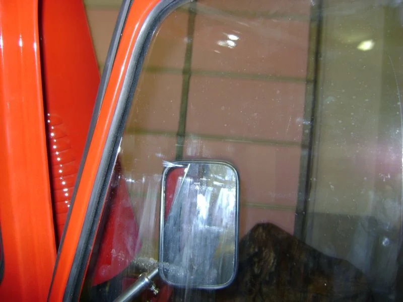

Went ahead and had my body guy(finally showed up) do the install. New felt, new channel runs(inside door on both sides, and new chrome. Doors are done complete w/weatherstrip
so the answer is. It was only $$$$ for everything. Let me know what it cost and for what. I need everything for doors and gaskets for glass all around.
I believe it was under $200 for both felts, w/s for all 4 doors, 4 chrome felts, and 4 rubber channels(go inside door, one on each side) I really like the black window felts. Glass is REALLY tight.
