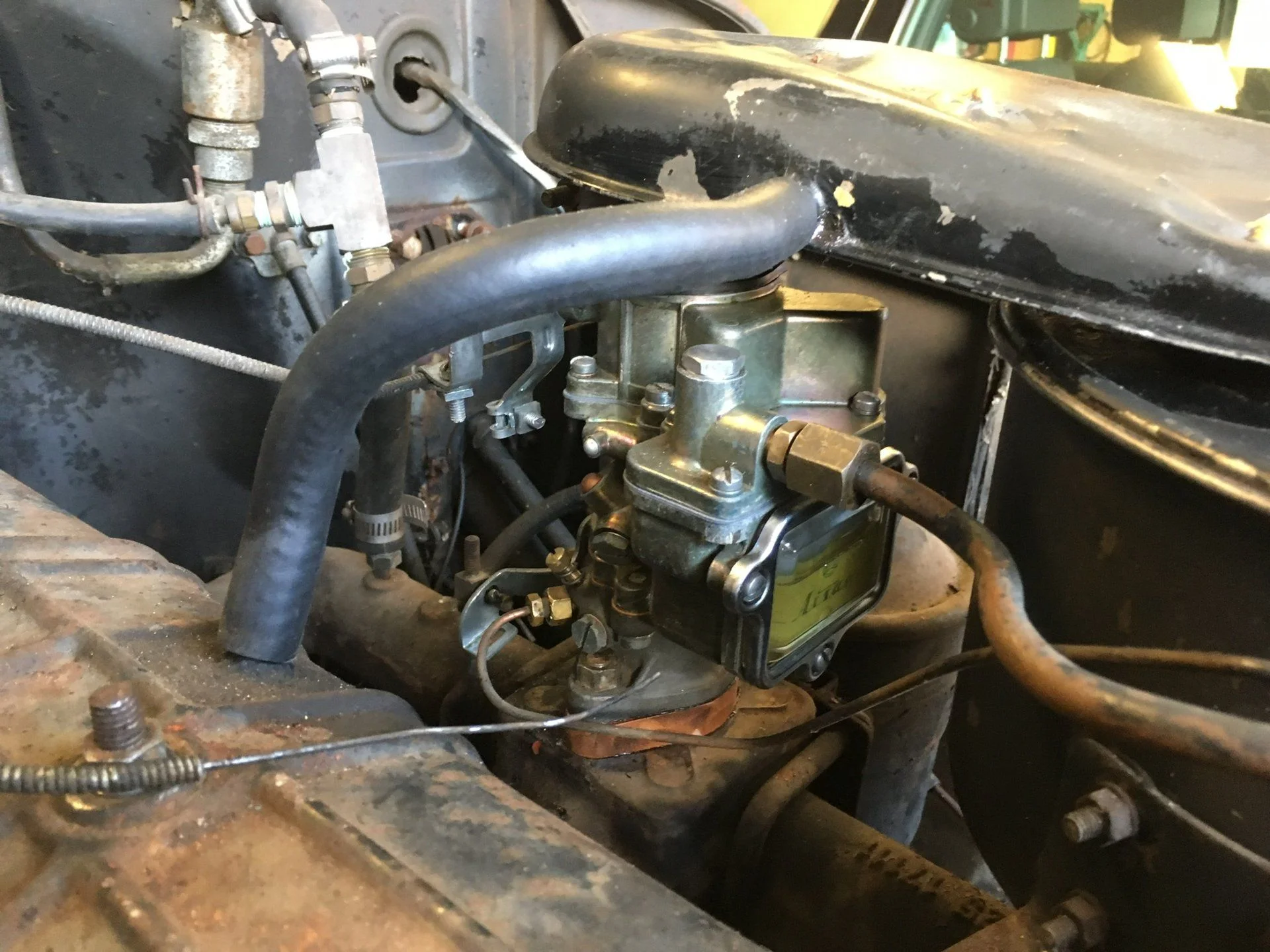

I’m stoked! Used the new insulator, bolted on the carb, connected fuel, dizzy vacuum, choke cable and throttle. Cranked it until the float bowl filled, pulled the choke knob, and it started right up. No drama at all. Very cool!
Of course, not everything is perfect. I’ve got a loose valve (tick-tick-tick) and the thermostat housing leaks (which I was expecting from the looks of it). But this is a big milestone even so.
Finished the normal tuneup stuff yesterday - set timing, adjusted the valves and the idle mixture. It starts instantly, hot or cold (with just a touch of choke), runs and idles smoothly and cleanly.
Took a last look at the cheap aftermarket oil pressure gauge while I had it running, pressure looked great, so I then removed the gauge. Dash area is now clear of all aftermarket stuff, no extraneous wiring. Just 14(!) unecessary holes to weld up later.

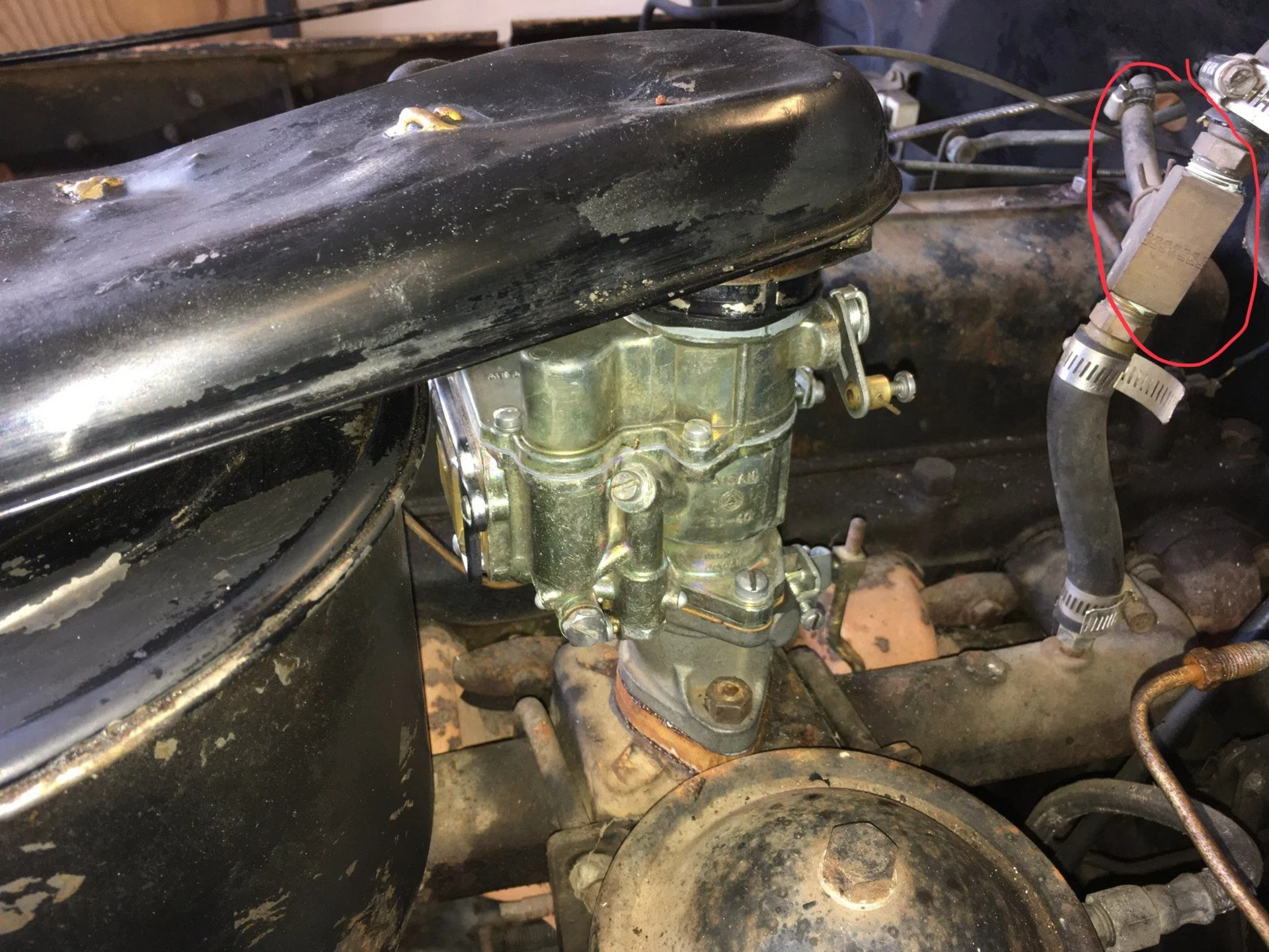

Excellent work! Where’s does the circled vacuum line connect?
Currently plugged. There was some sort of vacuum valve mounted on the passenger inner fender when I bought it, but as was normal for the original owner, he had partially disconnected it without truly reverting to stock. So the device was present, but disconnected. I removed the device and just capped the tee for now. I will remove the tee at some point, once I get a proper vacuum rated hose to replace it with.
Oh yeah, I recall that now in an earlier photo. someday you’ll figure out what that device was for. Maybe one of those Porsche’s could use it? :p (poke from a former 944 owner, now I drive really fast vehicles like FJ40s)

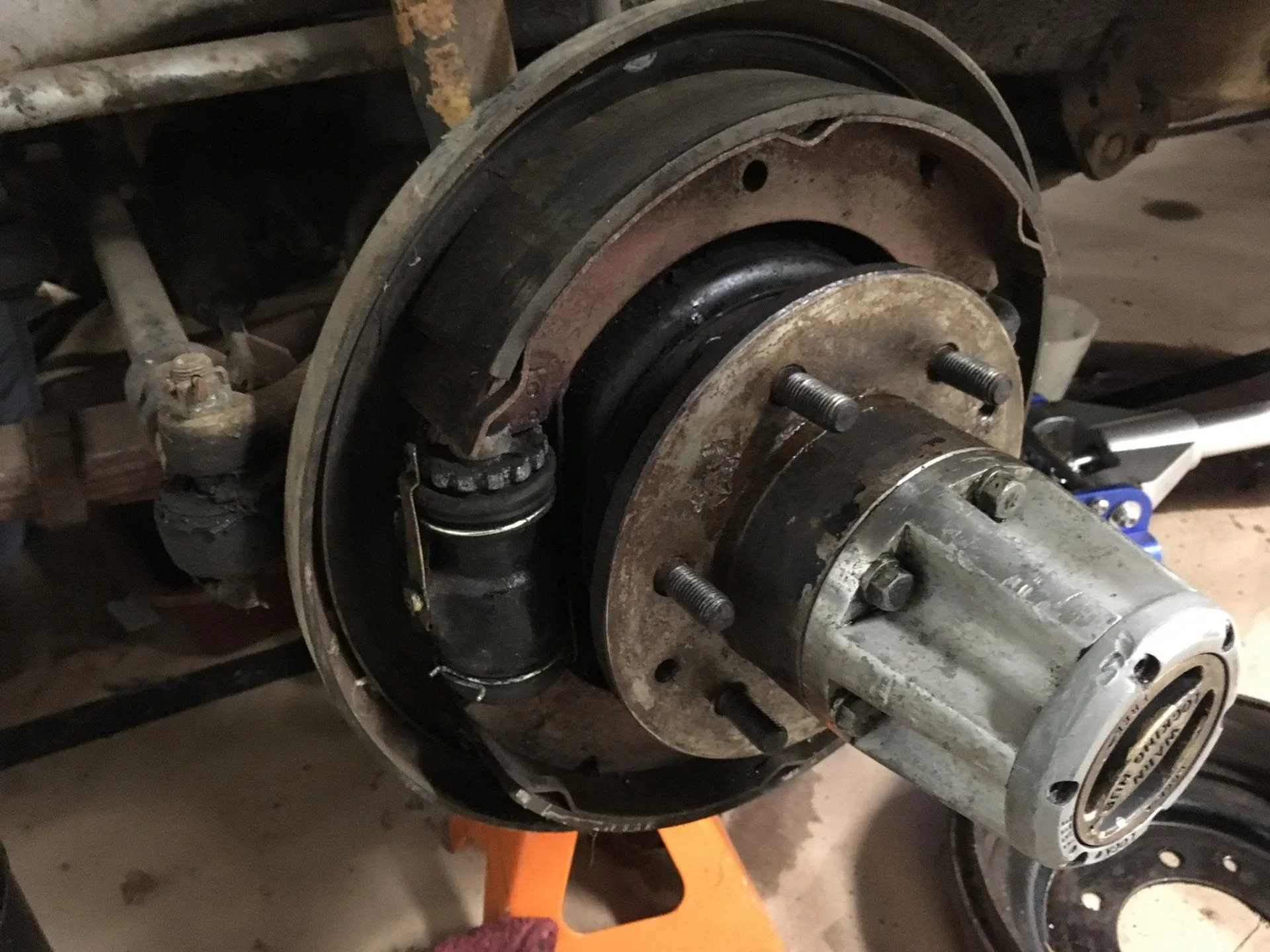

Brake inspection has begun. I now know the master cylinder is bad, I opened it up and looked. The bore is noticeably pitted from corrosion. So here’s hoping the master cylinders from the original owner’s family are good and correct. Should have them in hand sometime next week.
Also pulled the LF drum to see what the brakes look like, and here the answer is mostly good. Completely dry inside, all of the leaking fluid on the backing plate and the back side of the wheel is gear oil from the ball and socket. (Will have to address that too, of course. But maybe not right away.) The shoes are dry and quite fresh, very little wear. Drum is smooth, and adjustment seems to be close. The flex hose is not original, has been replaced at some point, looks good. Wheel cylinders are dry, no fluid or corrosion visible under the outer seals. Of course, they may still be seized, but I’m going to reserve judgement until I have a new master installed and can test them.
If all 4 look like this corner, worst I can see is needing to replace all the wheel cylinders.
So far, so good.
wonder how long it’s been to worry how the rubber will hold up when you start using them?
Yup, that is the question. At this point, if all 4 corners look like this my plan is to install the new master and bleed/flush them out, then see if the pistons move and retract smoothly. And watch for leaks. I’m still assuming that I will probably need to replace all 8 wheel cylinders.
Will know more later today.
Rear brakes aren’t bad either, or at least the shoes and drums aren’t. But the wheel cylinders look pretty rusty, mostly the adjusters. I’m betting the rear cylinders are still original and probably are junk. No surprise, really. I rather expected that.
