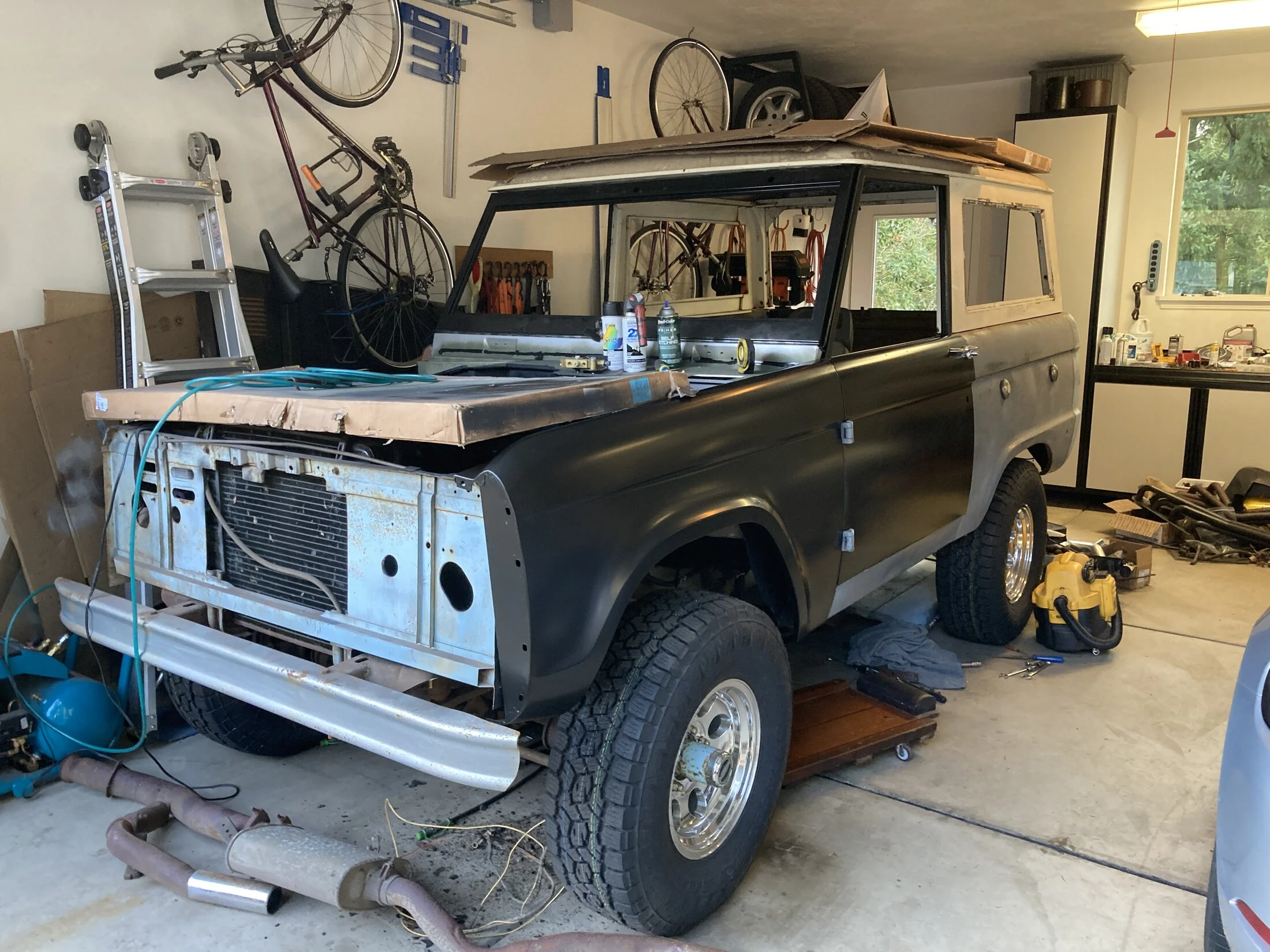

I started looking at installing the brake booster rather than hooking up the seized original master. Setting it in place for mock up made it obvious that if I mounted the brake parts now, I'd just need to pull it back off to get the mis-matched header off the driver's side.
So I decided to at least swap the left side header for the cast manifold, and move then back to the brakes so that I can move the Bronco, as I'll need to turn it around to have room to fit the right fender and door.
Got the header out and the manifold on, so I went back to the brakes. Quickly found that pretty much every flare nut fitting I touched is seized, and I'll need to cut them to remove. This is not a horrible deal, as I planned to replace all the hard lines later anyway, but I wasn't planning to do it now, but later when I do the front disc conversion. Oh well, ordered the lines and center hoses today.
While I wait for the new brake lines, I went back to the exhaust replacement. Got both cast manifolds on, the old exhaust removed, and have begun mocking up the new duals. So glad to have the old stuff off. Really poorly jury-rigged set up, and way wrong choices. Who would have decided that headers into a full 3" pair of duals was a good idea for a stock 302 2BBL? And who tries to cram dual 3" piping under an early Bronco anyway? Major mess, but now gone. The new system is looking quite nice so far, especially in comparison.
