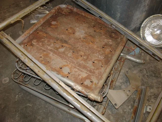

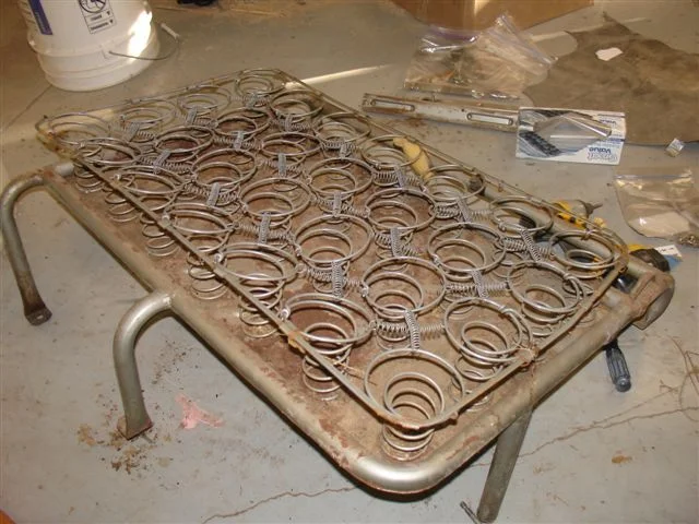

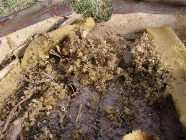

Saturday, I tore open the seats, and found that this rig had some hitchhikers.... What a mess. From the outside the seats looked great.... inside a mouse urine soaked rusty mess. GREAT! Have to wait for a warm day to sandblast to get it ready for powdercoat.

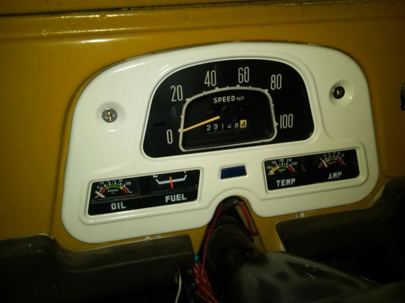

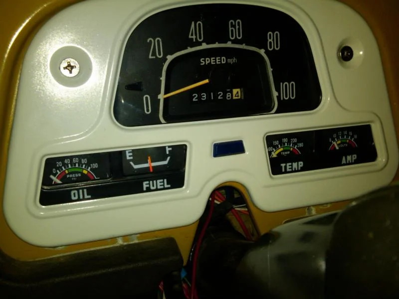

Any way here is my guage cluster. I painted it white because the PO already had it white and It just looks right.
Yeah, don't get too excited, for some reason the trim ring for the gauges reacted to the powdercoat, and it looks pretty bad. Likely the one piece that I will look at every time I get in the rig, looks like cr&*.
Thanks for the pics. Some sweet gauges there. I think I will order that instrument cluster kit. The only thing I don't like is the colored gauges. I saw the pics of the mechanical gauges that are just black and white, and I thought that looked sweet!

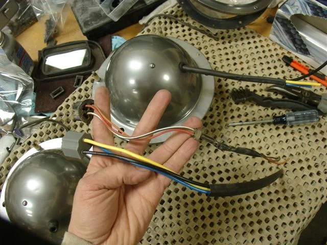

So, here are the headlights. Metal with yellow zinc finish. Wires to the lights are 12 or 14 gauge wires.
First thing was that I planned on upgrading the harness to a relay style harness, so the dash switch did not have to do any heavy lifting with high demand lights, and the bulbs could be brighter with the relay setup.

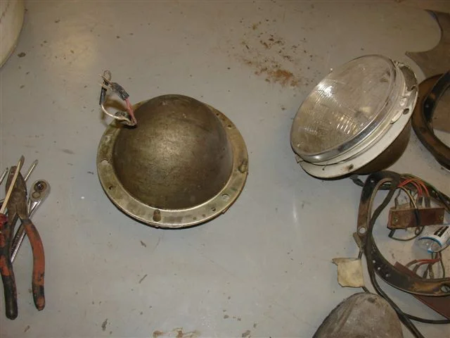

So, I had plans for that upgrade. Here is what I started with:

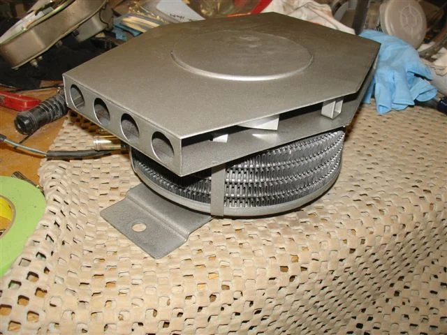

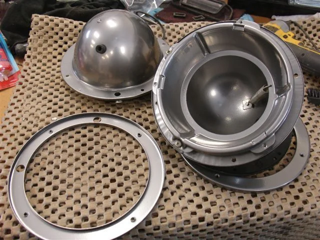

I then soaked them in simple green, and cleaned them up. Ended up there was a tiny bit of rust on each part, so decided to sandblast and then powdercoat them.
I had bought some smoked chrome color on ebay to try out, so decided this was a good test bed.

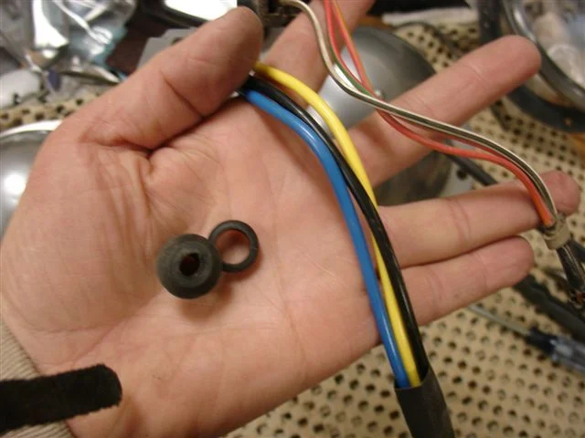

So, on the last picture, you can see the difference in the size of the wire, before and after. WOW.
The only problem was that the original grommet was too small for this wire size increase, so I found another grommet with the same OD (no drilling larger holes) with a larger ID. Perfect. (harbor Freight grommet kit) Note, the one on the left was OEM.

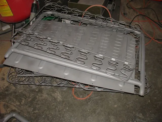

Found a powdercoater over in Bonner area (KCK acutally) Cross link Powder (behind Eagle stripping) that will powder 3 sets of dash pieces, and both seats for about $160. Not cheap, but says he does real nice quality stuff; the metallic needs clearcoated, so it is not an easy one coat job. However, he wanted a bunch for sandblasting, so I am thinking about firing the sandblaster up during the heat wave today. 30 degrees YEAH!

Well, got the sandblasting done yesterday, so parts are ready for the powdecoater. Don't know if I am being taken or not, but he talks his quality up a bunch. $225 for bench seats (including all the springs) all the small parts for seats, and three sets of dash trim. Seems stiff for powdercoating, but who am I to say??

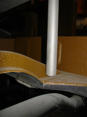

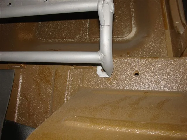

question on bench seat mount.
Question on the bench seat on the passenger side.
I am going to move the driver seat back about an inch for some extra room, but I never heard about people moving the passenger side back. Wondering if I should go ahead and weld tabs, or make it easy to do so.
Also my front left tab (center) of the seat, does not line up to where i thought it would. I had to remake the floor and build that tap, so it could be in the wrong spot by an inch, but I had thought I had good notes on where to put it, so I wanted to get a measurement to see what went wrong.
Anyway, it appears that I could move the seat back an inch with no worries. Any thoughts?

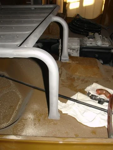

Also the far left side that sits on the back corner of the tranny tunnel. Does this straight post sit on anything? Maybe rubber stop? It does not appear to be bolted down. See pic below, it is "floating" now because the tunnel is not on.

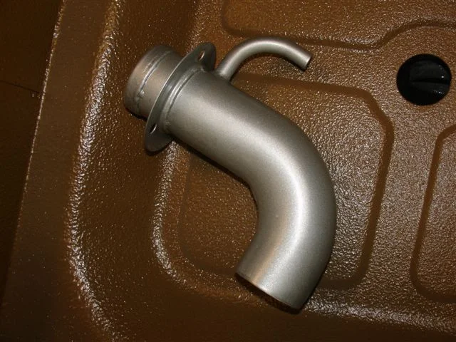

Set the filler neck in place and the gas tank cover before you move the pass seat back or think about it. I think you'll have a possible issue. but that year didn't have the cover on the tank just "straps" so possibly ok.
I can yank a spare set of seats and take a look at that rear post. I think it just sits there but not positive. my truck is at the other house. A crutch tip type cover might be in order to avoid it "rubbing" thru your bedliner. but I don't think it's going anywhere once in place.

You may be correct on the tank. I need to work on it anyway, so it comes down next.

From my recollection the difference in your seat and the one I have in the FJ45 is a notch for the filler neck in the bottom of the seat. So you MIGHT? be able to come back but get the tank in first. I'll be honest. I haven't pulled the seats out of their hidy hole to put them in the tub in the garage.
OR if you think that the "notch" for the filler neck would give you some extra room I can dig those seats out and you can test fit them in the 40 and then "replicate" the notch. It just might give you leg room.. BUT then you can't use normal old seatcovers, they'd have to be modded to fit that notch.

On the seat mount issue, I was able to "urge" the seat post about 1/2 over and it aligned perfectly, so all is good on that now.
