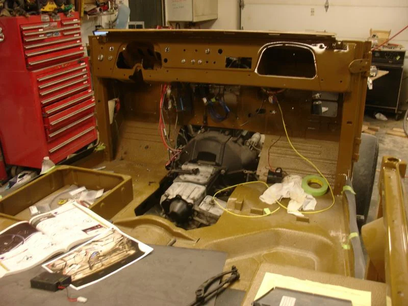

some more beginning of day
progress
Body mounts on
Steering column in
Pedals in
Column shifter in
Clutch master/slave
Seat spring together
Transfer case linkage
E brake in
Fenders next
end of day

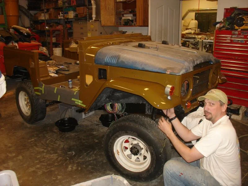

Well here it is....
Erik thought the hood needs buffed out..... WTF??
Man it wont be too long. Have you thought about putting tcase braces on? And do you sleep next to your hvac unit? lol
Sleep.... who needs sleep?

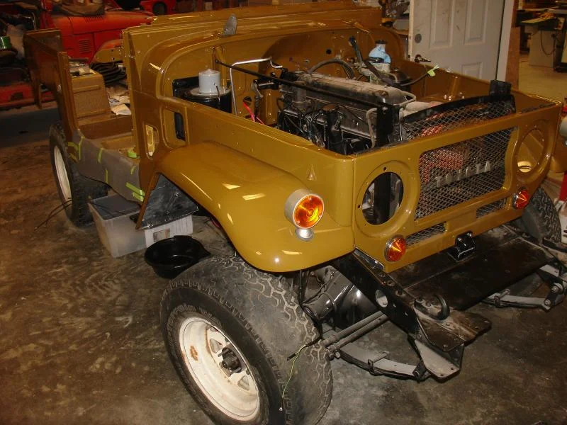

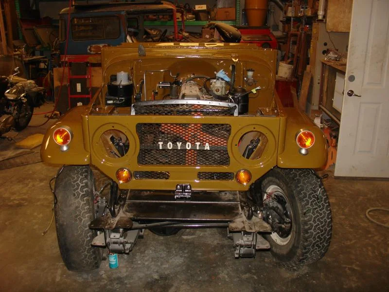

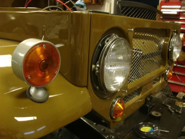

On those headlight bezels that you thought the powdercoat gummed up the threads.... Well, I recall powdercoating those, and I used the silicone tapered plugs in all of those holes, so I was surprised that they were gummed up. So... I went through all my taps, to clean out the threads. Took me a while to find the right tap. Ended up being .9 pitch m5 holes. You just try to find that pitch screw today.... GOOD LUCK. I bought some 1.0 pitch stainless, and plan to retap -- if issues, I will just put a nut behind it.
Gotta love old cars...

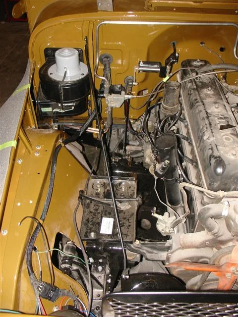

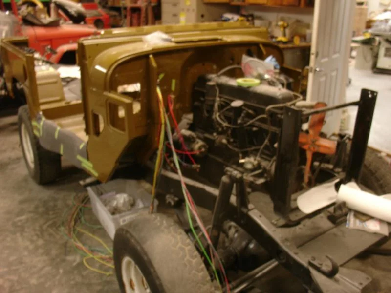

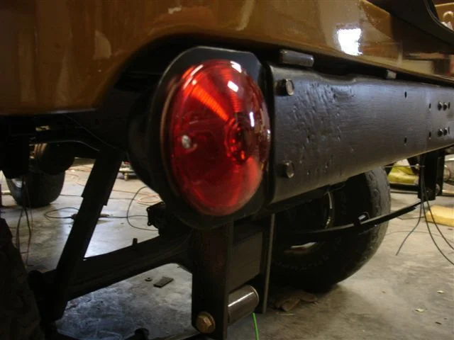

Thought I would update with some pictures. Wiring has been the word for the week. Almost done with everything, but waiting on some grommets now. The lights were one of the most difficult finds. The standard light on the stock 68' was this size - about 4" OD, in 69' it was increased to the us standard 5" tailight. I searched all over and found this light that was made for a trailer. It was within 1/8 of the stock size. As the original "ears" that were rusted through, I made the ring out of 1/8 steel. Looks great, and not likely to rust through again.
The wire loom is easy cut loom that I found on MSC. Looks great and hides all those bright colored wires from the EZ loom.

more pics

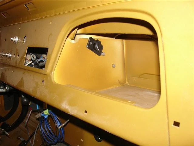

I decided to add another power outlet for cell phones and other stuff inside the glove box. I will add another under the seat on the tool box, and I ran power to the back corners of the rig for the same purpose.

2. Where can I get a new or replacement cig lighter for the dash?

those tail lights are still avail as well but you method works as well.
If you are correct, I would like to know the part numbers. I had Molle searching high and low, then I found a link on mud where someone is making the trim rings, and everyone is searching for the lights. Every so often they come up on ebay at 85 bucks each, however they have an awesome backing cover that I would love to have.... anyway, if you find the number let me know.

This is almost funny, so here is the link for the thread on making the bracket....
https://forum.ih8mud.com/40-55-series-tech/119768-early-tail-light-bracket-help-9.html
Funny part is that I asked for someone to give me the part number for the early lens, and I must of forgot to look for the answer, because there it was.... Toyota no longer stocks, but Mark has some.... If he has the cig lighter, I might be giving him a call.
Looking at Toyota, can't find a part number for cig. lighter for a 69', but for a 75' found 85500-20042
Anyone know the difference?
Awesome..... Thanks!
Chris you rock!! I went by NAPA and the exact frickin' piece was there on the shelf. $5 dollar and 49 cents later it was in my pocket. I will post this up on MUD for all to know. Ordered up two more to sit on the shelf for the next time.
