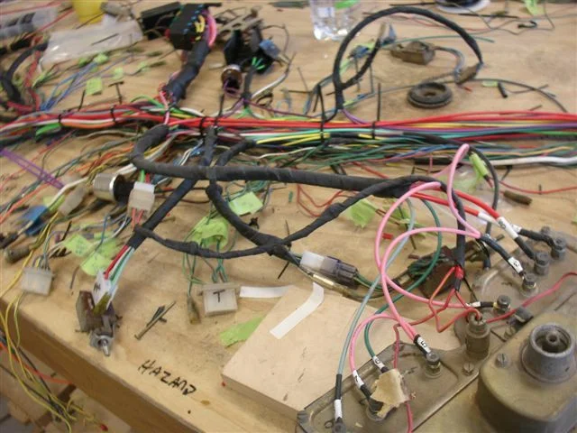

I keep thinking about how you did your electrical harness last year, and if you had any recommendations for things to add. So far I have added:
secret kill switch
wires for radio and speakers
extra accessory power in glovebox
accessory power on side of tool storage box
accessory power in rear (place to be determined) - likely for inverter.
wiring and relays for new IPF headlights
Any other recommendations?

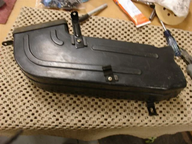

Heater rebuild

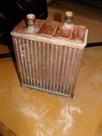

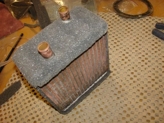

I soaked the heater core in CLR and cleaned it out. Kept running water through it and shaking. What a mess in there. Finally put in Vinegar to cut through all the calcium deposits. Looked a lot better inside and out.

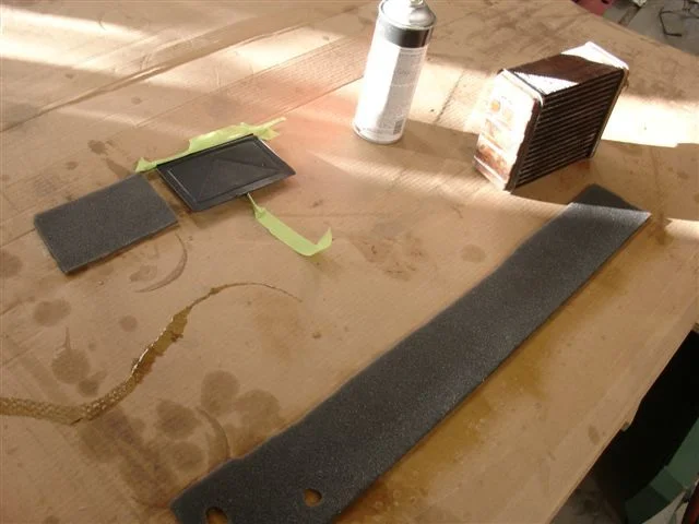

Bought some sheet charcoal foam, had an old can of spray adhesive, and rebuilt the heater.

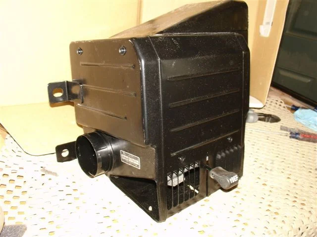

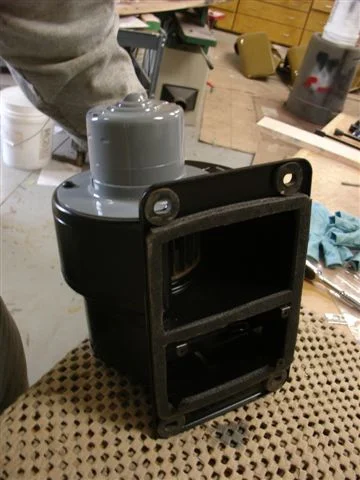

heater finish
Here is what it looked like.

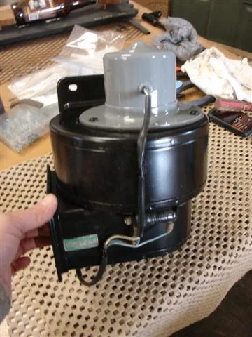

On the blower, I painted the case black, and found a grey smoke color at walmart for the motor. Looked nice. For the gastket for the blower, I bought some thick gasket type foam from the same company for the charcoal foam.

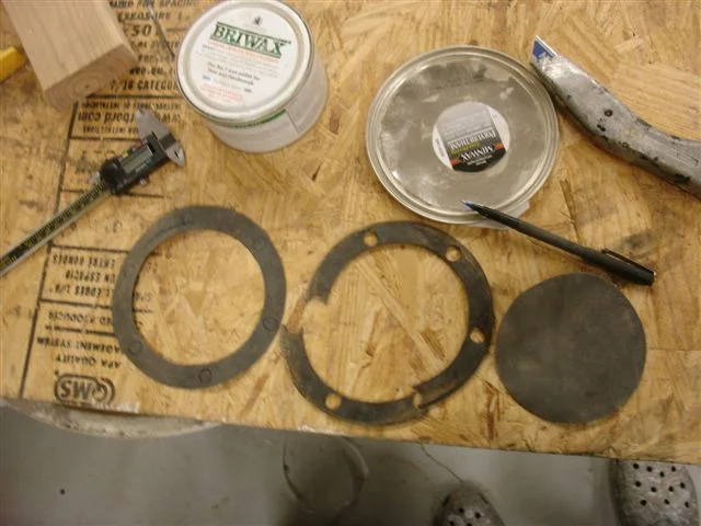

For the gasket from the blower motor to the blower, I found some real thick rubber that was about the same thickness and cut them to size. I found that a paint can lid was about exactly the right OD, and for the ID, I found a can of rubbing wax that was perfect.

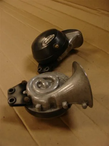

Horn

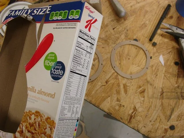

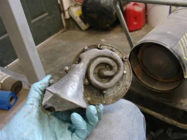

I worked on the old horns too, I tore them down, blasted the aluminum horn part and cleaned the rest up. I tore up a paper gasket so I had to make a replacement. I read somewhere to use a cereal box, and it worked great. I used Special K, as that could be my nickname. Short bus here I come!

Just realized I did not get a picture of the finished horns. The only mistake that I feel like I did was to not test them until I was done.

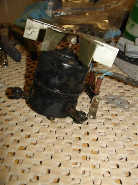

I did not make the same mistake on the rear heater. I hooked the fan up to a battery and no good. Have to dig and see if another motor will fit in.
The wiring harness is about done. I am waiting for the mail to get the wires for the stereo and then I can wrap it all up. Also need to order some items from Coolerman, but waiting for his reply to a question.

I just read an article on coolerman's page basically a quick tear down and clean up of that blower motor. Worth a try first.
Ends up older 65-71 (and 78-79) were two speed fan, as there is a resistor on the front. I need to check my late model car and see if it will interchange (or heck if it is even there)
"two speed fan" Your still talking about the rear heater fan? I've NEVER seen a 2 speed rear fan.. From my recollection heat switch is front first click, front and rear second click.
I would like more information on that if you have it. There was a resistor on the fan blower motor in the engine bay. it might have been 2 speeds.
:bounce:Good and bad news today.
I rebuilt the rear fan, and it works great. Yeah.

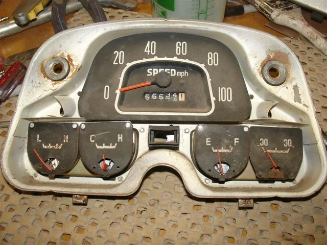

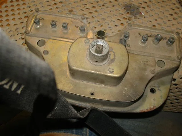

I dug through my extra parts and all the gauge clusters I have are for late model cars, and the gauges are different. So, I either need to figure out how to adapt them, figure out other replacement gauges, or find another old cluster. Any ideas? This car did not come with the cover on the cluster, so I need to figure out if I can use a cover from late model, or if I need to find that too.
Cover on the cluster should be the same all years.. minus the ones that had the turn signals as big bulbs outside it.. I loaned my spare cluster out but think I could remember who it went to and we can use it for parts. As far as putting in newer gauges.. Are you going for a "restore" or "remodel" that is the question.. If your putting in aftermarket stuff I've looked at the kit Kickass Stuff For Your 40-Series

I may go that way. I don't want to restore to original, more just make it all work and look nice. I thought I saw a thead about how to clean up the face of the individual gauges, but can't find that. I thought Atlass had something to do that.
If I could install the gauges from the later model unit to the old one, I would. Research mode now to figure out my options.

finally catching up, picks of the horn finished, and I powdercoated all sorts of little pieces incluging these parts on the air tunnel thing-a-ma-jig.
Oh, and the pre-cleaned up rear blower fan. (now cleaned and WORKING) It appears from the wiring harness that there is an additional switch on the dash that runs the rear fan. I don't recall seeing it when I cleaned up switches, so might have to find one.

here is the cluster as I received it.

I need to take some pictures of my cluster. I got the bracket and wiring from the link above and got my guages from summit racing that saved me a few $. But they are pretty sweet and are more accurate than the stockers. The sending units all fit in the stock locations. The only thing i had a problem with was that my fuel guage crapped out. I still havnent found a cheap replacement yet.
fuel gauge is probably the sending unit. .
Kelly i'll be honest the stock gauges are dummy lights at best. I'll see what I have lying round for the face and see if I have a spare cluster. I do think I loaned one out to I think someone with KU or something in the name here on mud.. he needed the Oil pressure gauge out of it or something.
