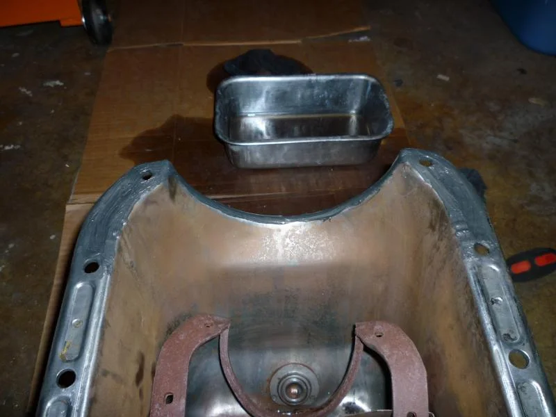

Rear main seals are a breeze and zero risk of damaging them if you install them when you have the pan down....drop the rear main bearing cap, pull out the old seal, clean the area up, install the new seal, re-install the main cap, and torque the four bolts.! No hammer, no beating on a 30 dollar seal, in and out.
You can see the lower part of the rear main seal in this pic...( I hope )
attachment.php
Do me a favor and clear this up for me if you would..... the pic above shows the trans still attached, correct? you mention in your post how easy it is to change the rear seal when the pan is down, correct? For newbies like myself then it's not really easy since the trans has to be removed which means the drive shaft has to be unbolted which means the rusted bolts prolly will strip or break, etc, etc, ?????? So is it really as easy as you say it is? maybe for someone who has been doing this for years and has the knowledge, all the tools and previous experience, correct? For those of us who are new to the sport and at wrenching it it quite involved, no?
Changing the rear main does require the trans to be pulled back enough to remove the clutch and the flywheel, but its not hard. Its just time consuming and dirty... If you plan ahead, you can knock out alot of good preventative maintainence at the same time(tranny/t-case seals, reseal speedo drive, oil pan gasket, check/replace clutch, pilot bearing, throwout bearing, etc.)
Its certainly not a 1 banana job, but not technically intensive like a t-case rebuild or diff setup.
