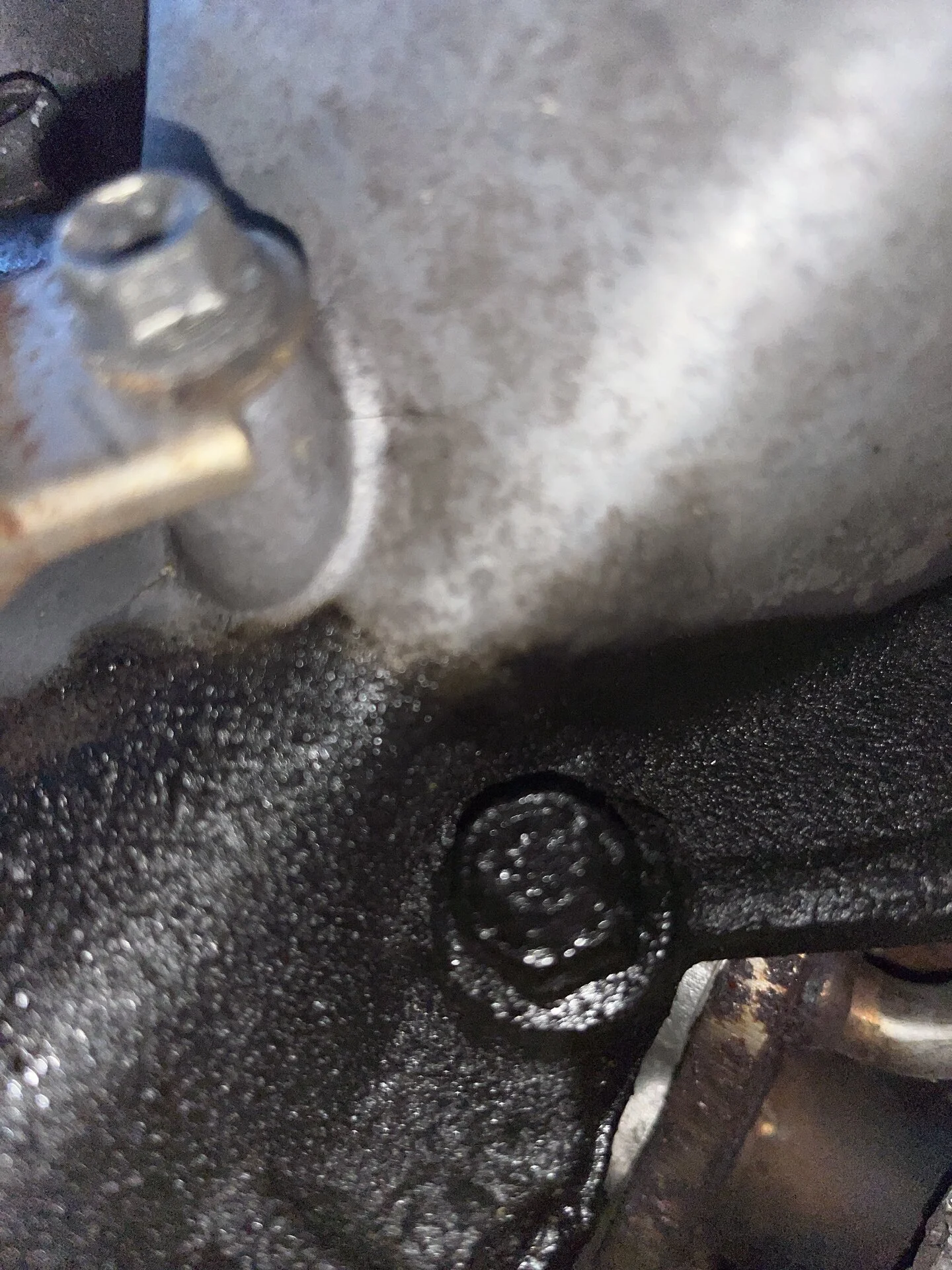

I don't know why I do this to myself but I took a peek around the engine compartment just to see how things are going since I pretty much never even have to open the hood between oil changes.
Noticed the AC compressor is basically coated with oil, as well as the bottom of the head immediately above it. It's really tight in there so tough to even get a good picture or get any feel for where it could really be coming from, even with an inspection mirror. It is not coming from as high as the VCG area, the source must be lower than that. Tried searching the site already and most references are talking about a cam tower leak, which I don't think this is. The VCG area looks totally dry above it, the side of the head above the exhaust manifold is totally bone dry, zero leakage there. The passenger side is also totally dry top to bottom. Which tells me it's maybe the front timing cover or perhaps even the main crank seal being flung up there?
The consistency of the coverage tells me this has been seeping for a while now. The one picture that came out at all here is looking diagonally up from kinda above the AC compressor, if it's any help at all.
2014 with 120K miles. I'd totally expect this on any of my BMWs but a little surprised to see it on a Toyota!
Somewhat common to get an oil leak at the RTV at the top driver's side of the timing chain cover where it meets the engine block. Mine has this, and a few others have posted about it.
I put a half can of Gunk standard engine degreaser on it each oil change and it never quite gets to the ground. In the back of my head are plans to remove the cover and re-seal it, but that is a whole lot of work for a leak that has been easy to keep in check for the majority of my 80k miles ownership.
Not that your leak isn't as bad or maybe worse.. I'd recommend doing as good a job as possible degreasing things and monitoring. Is any of it even getting to the splash guards or ground?
